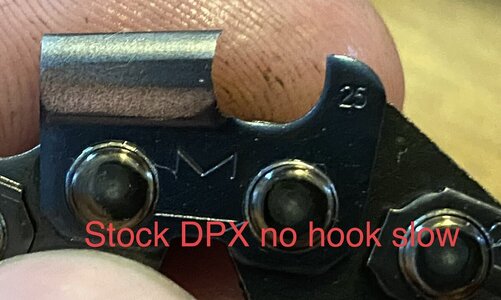

Old bar, did you re-dress bar when installing new chain?
I checked it. Swapped back to skip full chis and it cut fine. I had hit debris and touched it up with a file freehand. I had to either go through and do all the cutters and rakers with a husky roller guide and measure to length or my stihl USG grinder. Never had so much trouble with tiny imperfections or inconsistencies having such a dramatic effect.

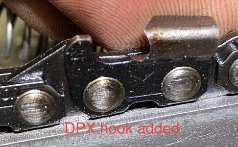

I bought some of the triple chrome plated Oregon semi-chisel 2 years ago to try in dirty conditions and I really dislike using it. I’ve tried different sharpening angles and depth gauge heights, and I just can not get it to perform. I just tried it again the other day on a couple logs and the only way it would cut was dogged in - and that’s in green Red Oak!
I feel better now. Only way I could get it to cut well was to put so much hook in it that it was delicate despite the “triple chrome”. I have a theory from looking at Oregon and stihl chain. 10° down on the file puts the working corner up where it should be vs. down on the side how Oregon is. Unfortunately my USG has offset but not tilt.
@huskihl also pointed out the stihl RM is less rounded. It’s interesting how different cutter geometry translates to different shapes/angles even when ground at the same settings on my USG.
My plan for these chains is to put a durable grind on them, drop the rakers, and let the 3120, the Euc, and the CBN wheel Kill them.
I did the same, more aggressive hook ,
I’ll have to try even more hook and see what happens.
