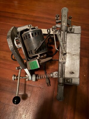

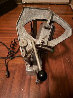

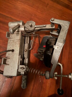

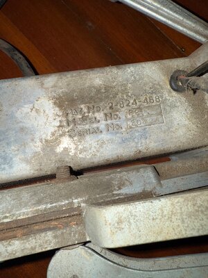

Here is a grinder I’ve never seen before. Picked it up locally…anyone know anything about it? Says model number 22…an internet search doesn’t pull up anything I can find

Very cool!
(^^^ click for link to patent ^^^)
Does not look exactly the same, but patent number matches, so they must be related.
Note the patent describes a device for sharpening both circular saw blades and saw chains.
Yours may be a later model?
