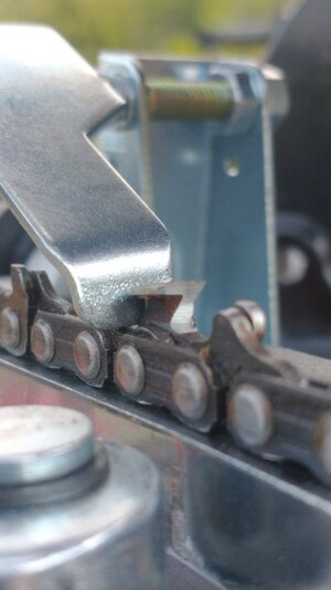

27ish/55/0 is what I came up with for my 1st chain, Im gonna bury it a piece of doug fir in a few hours and test it.
I gotta admit this is the fastest I've ever sharpened a chain, I am liking having a grinder so far.
quick question, do you think leaving the chain oily while grinding will help the steel retain it's temper?

i took the time yesterday to read this whole thread and soak up all the info I could, I grabbed my most worn chain this morning and gave it a go, I am pleased with how it looks and feels, but the proof will be when I take it to the woodpile.
I didnt burn any cutters, I took very light swipes and tried to do all cutters equally.

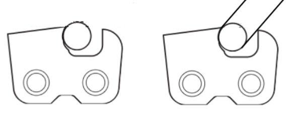

anyone successfully sharpened a 3/8 chain with an 1/8 inch thick wheel? I noticed on the chart in the back of the manual its lists a few chains that call for the 1/8 wheel.
Duane(Pa)
It's the chain...
7:57 PM
325
5,116
25,453
Centre County
I’m pretty sure those would be 1/4 and 3/8 LP? Might work for 3/8, but not ideal…
Squish9
10:57 AM
28596
Feb 27, 2024
331
1,468
Australia
Otherwise, people start grinding with the flat side of the grinding wheel, and that’s part of what gives grinding a bad name.
Philbert
Hey look, a person that understands why a wheel is shaped and how to use it!
I'm ashamed to admit, I only learnt this last year
12:57 AM
14,942
59,459
I used a 3.2mm wheel in a pinch on a full sized full chisel 3/8" chain not wanting to swap over to the 4.8mm wheel.
The chain did cut, but it didn't hold its edge as long.
president
4:57 PM
14155
Oct 12, 2020
295
502
peachland BC Canada
If you keep repositioning the wheel and cutter, you can get close to a standard profile on full sized 3/8 pirch chain.
Philbert
T1, with a 325 wheel ,move the grind forward o the second pass ,to remove the gullet
and achieve a 3/8 grind
