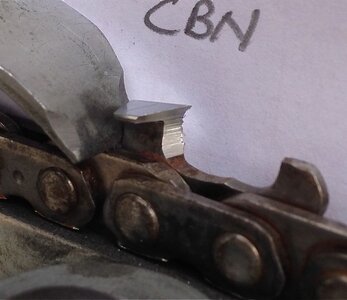

FWIW I was not impressed with the CBN wheeks I tried. Not magic. Still possible to overheat cutters. Left coarser profiles and burrs.
I prefer a well dressed vitrified wheel. Only issue is that they do create more dust.
But as with chains, there are cheaper wheels (CBN and standard), and there are better quality ones.

They are not magic for certain, but they work great and the wheel never having to be re-shaped helps create a “constant” in the equation….
And yes I had lung issues years ago and the minimal dust factor was also why I got/like them!!

And I also dont think those tiny burrs have any ill-effect on the chains cutting ability….i have (with my hands), ran a cutter over a 2x4 and within an 1-inch the burn was gone…

I like my CBN wheel, but it did take a different head angle than the stone wheel I had hand-profiled to get the tooth hook shape I like. I got a cheaper one, because I didn't know if I'd even like it or not, and I didn't realize when I ordered that it was made of steel instead of aluminum. If I ever have to buy again I'll make sure to get an aluminum wheel - I can just imagine the start capacitor on my grinder groaning trying to get that thing up to speed. LOL. It does well once going though, and luckily my hinge spring is strong enough to keep it raised.
