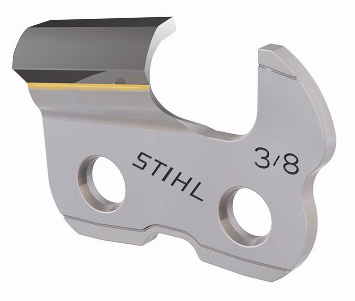

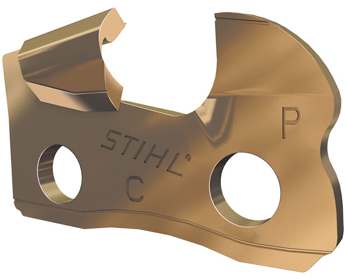

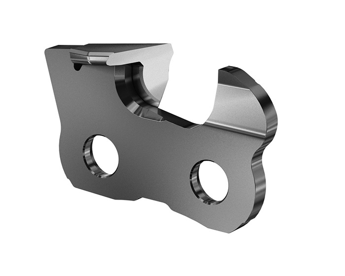

I never said anything about the RD3. Talked about the rapid duro, but not rd3....
Rapid Duro 3
Rapid duro
Stihl Rescue
This is the one I am thinking about but need a new guide bar, the only offer in .063 and we run .050.

(I can't multi-quote in Tapatalk)
Rapid Duro 3
Rapid duro
Stihl Rescue
I realized that and didn't want to imply that You intended to use a RD3 - just wanted to be helpful and point out that the RD3 is not suited for extreme conditions! ;)
It is possible that it came out the wrong way - sorry , English is my third language.
I can not comment nor argue about any other carbide chains as RD3 is the only I have.
