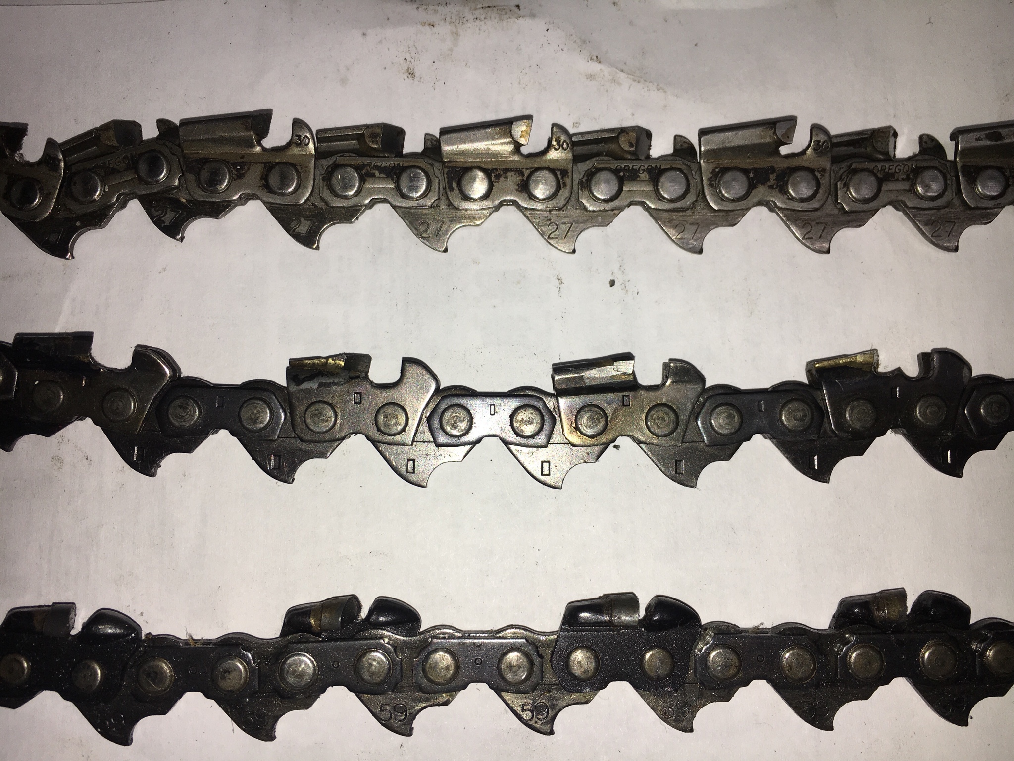

We use 460's 20" .404 bullet or Rapco Terminators
Top was a Razoo, cutter every link, not enough bite-when transitioning into wood members if making horizontal access, imo.
Bullet and warthog on circ saws
