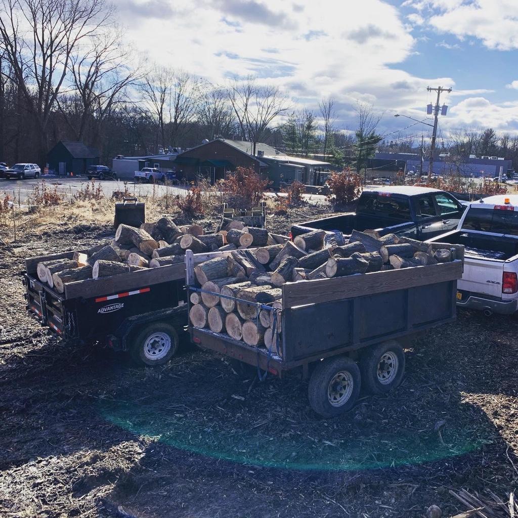

Another 2 loads. 80% cut with the same carbide chain. Slowing down in speed just a bit. Still happy with it. I’ve got a fresh loop of carbide low pro on the ported MS 250 when this one has had enough. Since I’m happy with it I may see if I can find it in a 3/8 .50. 72 driver for the bigger saws. I think the same dealer did have one. Having 3 chains for different saws should be perfect when the conditions get like this.

Are you happy with the cutting speed?
Thanks.
Philbert
Yes Philbert, absolutely. The time and frustration saved is substantial. It puts a smile on my face because I know what the outcome would have been if I didn't have the carbide. I lived it last winter.
