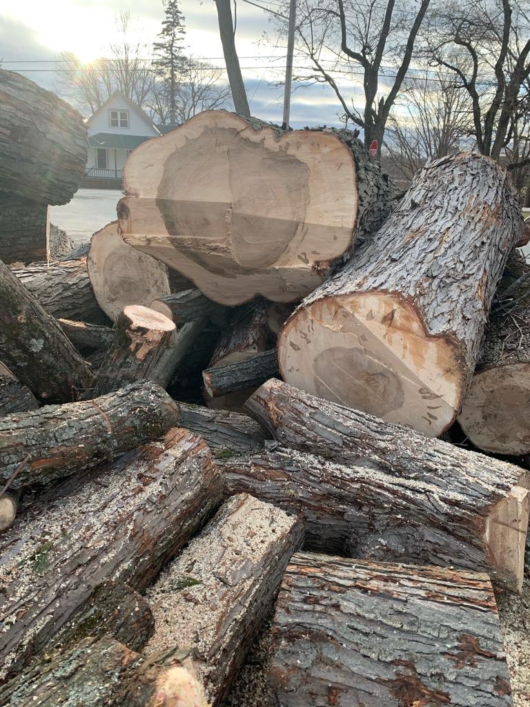

Did someone say Silver Maple?
I have to split this chit this weekend.
