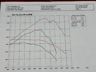

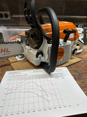

Any interpretations welcome, particularly about the "squiggles" or "undulations" seen from roughly 9000 rpm and beyond. Just unboxed this tonight. Based on the graph, what characteristics in the cut would you expect from this saw versus stock?
Stihl MS 261C. Date of manufacture 11/24. Donny Walker muffler mod. Dyno Joe work saw build.
