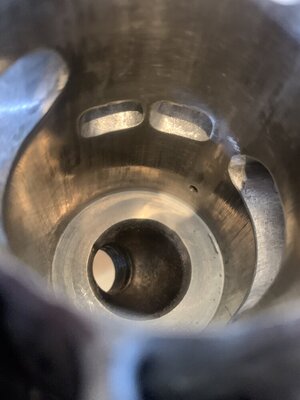

so put the timing wheel on and learned that i hadnt got as quite as far as i thought last time. still had transfer openings around 128-130, so lots of blowdown still. got muh sharpie out this time and ground up a bit more. ought to be right around 122–124 now.

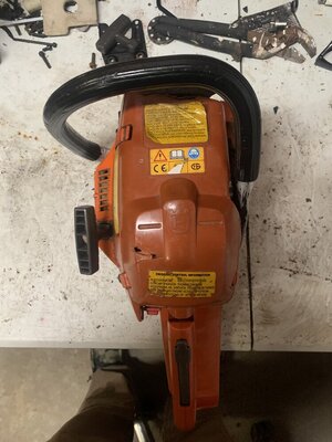

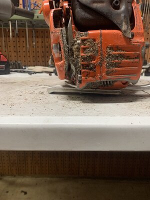

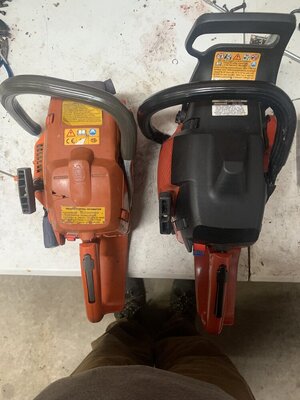

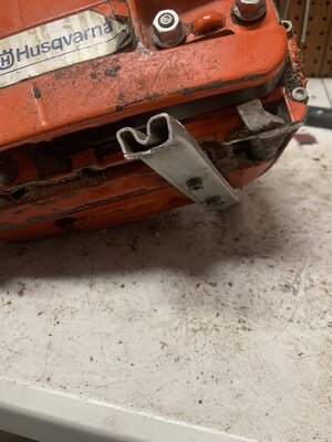

while i was goofin around with that also put on a jonsered handle to get the straight across action goin. also cut a chunk off of a mangled handle from another saw to make a kickstand/chaincatcher.
