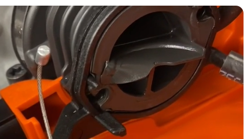

Word, the boot to carb surface can deform when over tightened. Spray it with your choice of petro chemicals while its idling and see if it changes rpm. Super common 372 minor air leak location.

Just a random spitball. Walker's posted a vid about it not too long ago 'erratic running and idle problems due to pooling'. My 2015 550xp had one of the rubber boot holes misaligned slightly from factory.
