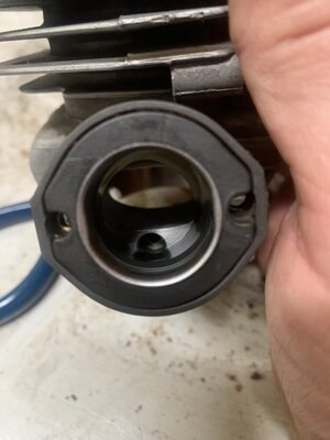

a little of our favorite 2 part epoxy and some masking tape. i always like to give it some gentle heat to loosen the epoxy, helps air bubbles to make their way out.
View attachment 370441View attachment 370440
i had that thought about the bottom end not getting fresh oil…itll be research and stuff… hahaI’ve turned a plug and pounded it in or ditch cut and welded it in before.
The slight upward angle didn’t seem to hurt anything but I could see it starving the bearings of fresh oil a bit.
