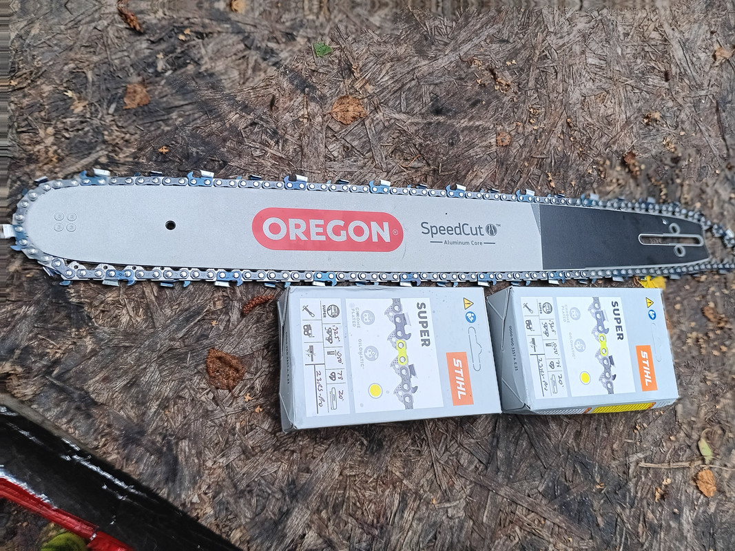

I’ve been a big fan of the Oregon VersaCut bars. They’re cheap and light. I’ve also been impressed with the pro style Forester bars.
I like em too. Got my first versacut bar in 2020, have since gone through a half dozen .325 20 inch versacut bars with oregon lgx .325 and at least a dozen 24" versacut bars using 3/8 EXL.
Good $50-$60 bars. Never blew out a tip. I did have one .325 versacut bar back in 2020, where I thought the rails were a bit soft.
Never cared for oregon .325 lgx chain. Regardless of raker depth, it never cut right.
Rarely run 40cc-50 cc saws and usually give them away as gifts to friends and family. But this year I'm gonna give .325 chain another shot. Picked up coupla 50 cc saws, narrow kerf. 325 bars bars for both saws and 3 loops of 23 rs pro. There's a fella in Missouri that has spools 23 rs pro and makes 20" chains at the $25 mark. So 23rs pro seems affordable nowadays.
