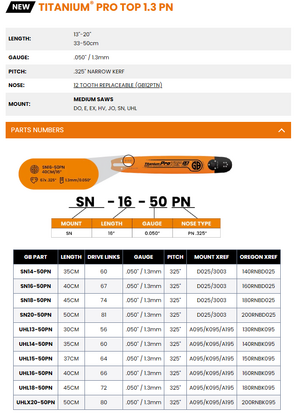

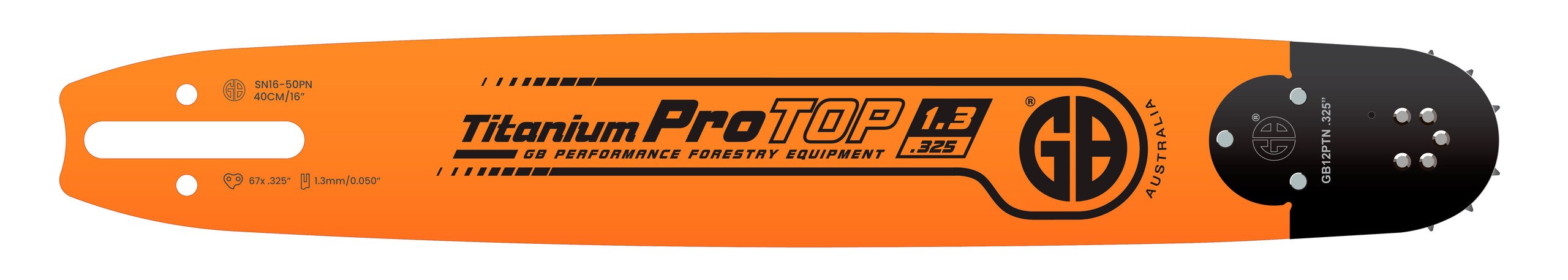

On this side of the pond:
This includes 23% VAT (consumer sales tax).
Ok, when I look at GB website, they don't show a .325 x .050 in the pro-top. I *think* the 1st link is for a 3/8, the page doesn't specify. The Stihl PN they list is a 3/8...
The second certainly seems to be what I am looking for... But I cannot seem to find a North American source. I'll dig deeper on that one...
Sorry, I had several pages open and posted this link, even though I had already noticed that it was 3/8 (PA instead of PN). Unfortunately, in other places with delivery to the US, it costs over $100.
That's what I am finding also. The .325 x .050 exists, but not in the GB catalog, and not in North America. 🤦🏻‍♂️
Getting one here puts it at the same price as the Sugi, which is a great bar. Might as well order the Sugi.
It is listed as a new product on their recently launched website, so the lack of availability is understandable. Perhaps you should inquire with the US distributor (e.g. wallingfords.com), since it is available in Europe at a price less than 50% higher than Light 04?
GB bars are good stuff. Not much dealer support/Dealers in USA though.
They also make long 3003 mount bars in 3/8 picco/lo pro. I use those for CS milling.

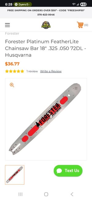

Screenshot_20250817_182825_Chrome.jpg36$ is pretty cheap for a lite bar.

View attachment 46735436$ is pretty cheap for a lite bar.
It is super cheap. Unfortunately I have heard stories/seen pics of the epoxy inserts falling out of those bars. Apparently they are not dovetailed like the Sugi and Tsumura bars are.
Also, I haven't seen that bar available for a Stihl.
