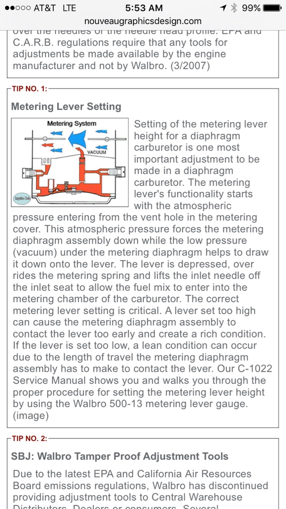

The most important thing to remember when messing with carbs in my humble opinion is not to lose the low pressure differential between the throttle plate and the venturi. Sure, a bigger carb might bring some engines to life.......but if it won't pull enough fuel to match the increased air flow you ain't getting anywhere.
I took a stock wj35 and stock boot off my 066 and put a 088 boot and 1" bore carb on and it didn't change at all.
Possibly stronger with the oem carb and boot.
Put the same setup on a 064/056 and made a big gain. Not really sure why but I tried it on another 064/056 and gained nothing. Carbs confuse me
jmssaws
Banneded
12:19 PM
291
10,024
37,296
The saws I port the only carb trouble is occasionally have is a touchy low jet and being lean after a cut and generally a few more lbs of pop off fixes both
drf256
Dr. Richard Cranium
1:19 PM
319
9,666
63,782
Strong Island NY
It would be helpful if someone were to explain the function of the metering diaphragm and lever.
I was under the impression that any fuel pulled into the carb Venturi pulled up on the diaphragm and opened the needle valve which was under pressure from the pump side of the carb. Idle/transition or main jet.
Jetting should ultimately affect the overall flow of the high speed circuit, but wouldn't more resistance to the needle valve opening affect low end and mid range up to max jet flow?
I thought it was an overall curve that was changed by metering spring pressure and lever height and not just the idle circuit?
I'm likely way off here, but I'd like to know why.
