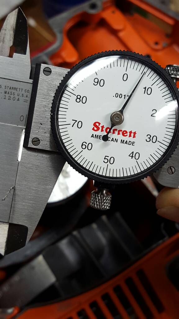

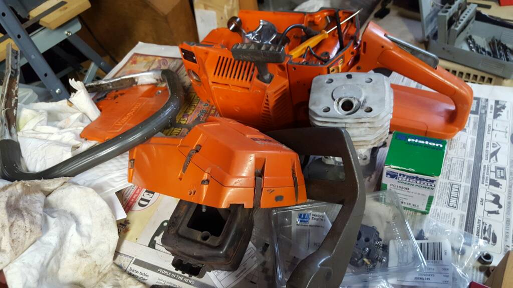

I'll check when I get home. The one on the bench has the non decomp cylinder and 87 carb. I'm putting a Meteor in it. Get back to you a little later.So maybe a meteor works without a beer can?

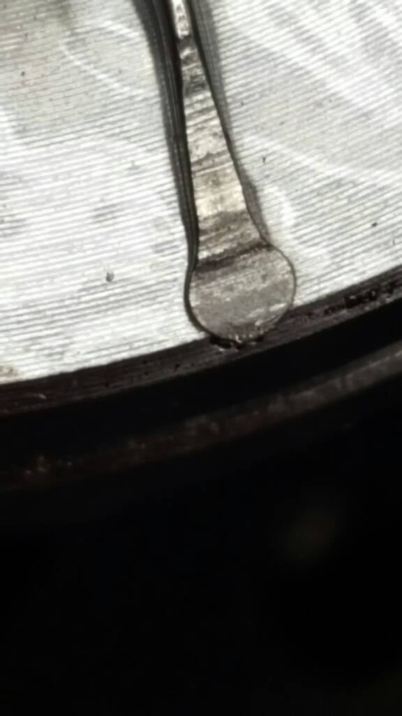

I used Meteor pistons on my 262 builds, had to sand the squish band on both KS and 48ZN15 jug, squish was 0.008-0.010" on plastigauge reading.So maybe a meteor works without a beer can?
So if there is that much variable in diameter then five thou in height above the pin center isn't that out of line.They sort them into those categories
Tolerance for diameter will be in the 10's and 100's of thousands.So if there is that much variable in diameter then five thou in height above the pin center isn't that out of line.
