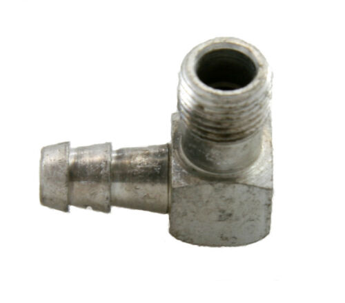

I got the saw all put back together this morning and found out pretty quick that I had a fuel problem. Turns out the plastic inlet elbow has a crack in it. I am open to suggestions on how to best repair this.
Order Husqvarna part number 503082001 and replace it.

I'm not a fan of the plastic fuel inlet, I usually order a cheap carburetor online and pull the metal fuel inlet and impluse off and toss the rest.
Thin smear of JB and press it in where the plastic one was.
Just my 2 cents
