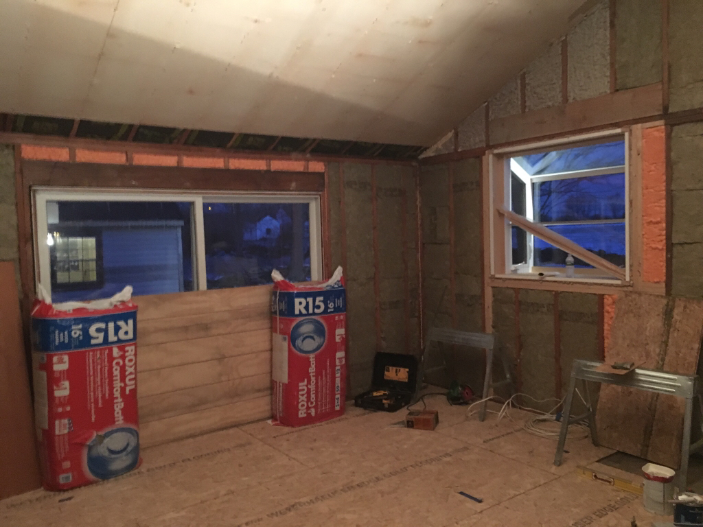

Our kitchen... she doesn't need one right?
