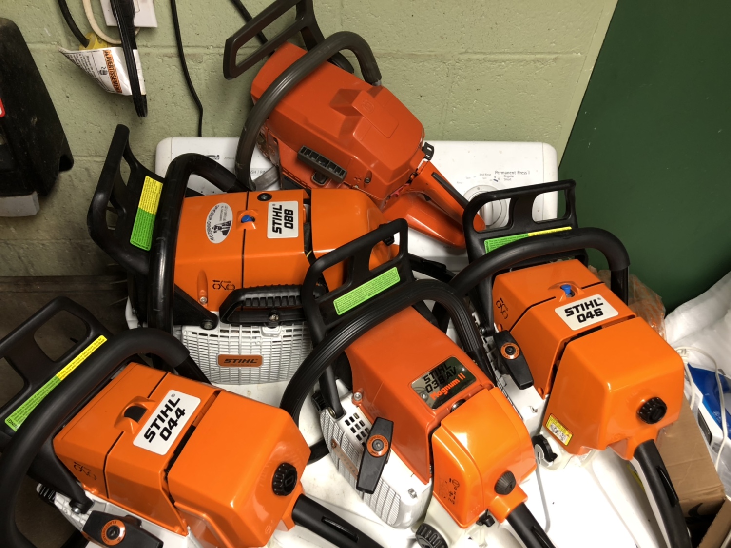

Doing a little cleaning
The saws i rebuilt in the last yr for my self
