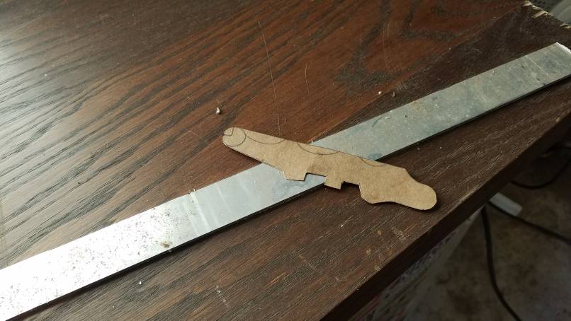

Cool. TY. I do have some Aluminum scraps that should work fine. [emoji106]
Gotta be good for a tenth or 2 in the cut. LOL
I need every advantage I can get against the Hooskies. [emoji16]
