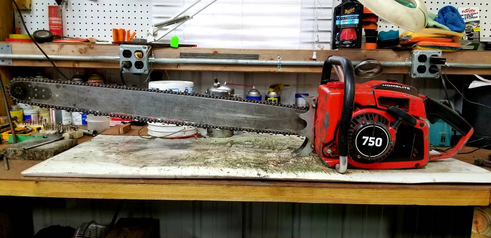

To finish what I touched on yesterday.
Had to laugh yesterday at some of the stories this logger was telling me about this local dealer. Turns out the owners 30something son runs the shop (EXPLAINS IT IMO). Same one I had issues with 10 years ago and never went back as he was that freaking stupid.
Anyhow I get a call. Can you spin my new 60" chain for me. Sure I can come on over. He brings 404 presets etc. The chain is 10-11 drive links to long.
What I dont get the bar he bought from same dealer has 172DL right on it.
All good now.
Then to
he leaves 60" 44" 36" 28" chains for me to sharpen. I said you know chains are my least fav thing to do right. He smiles and says thats why your doing them.
