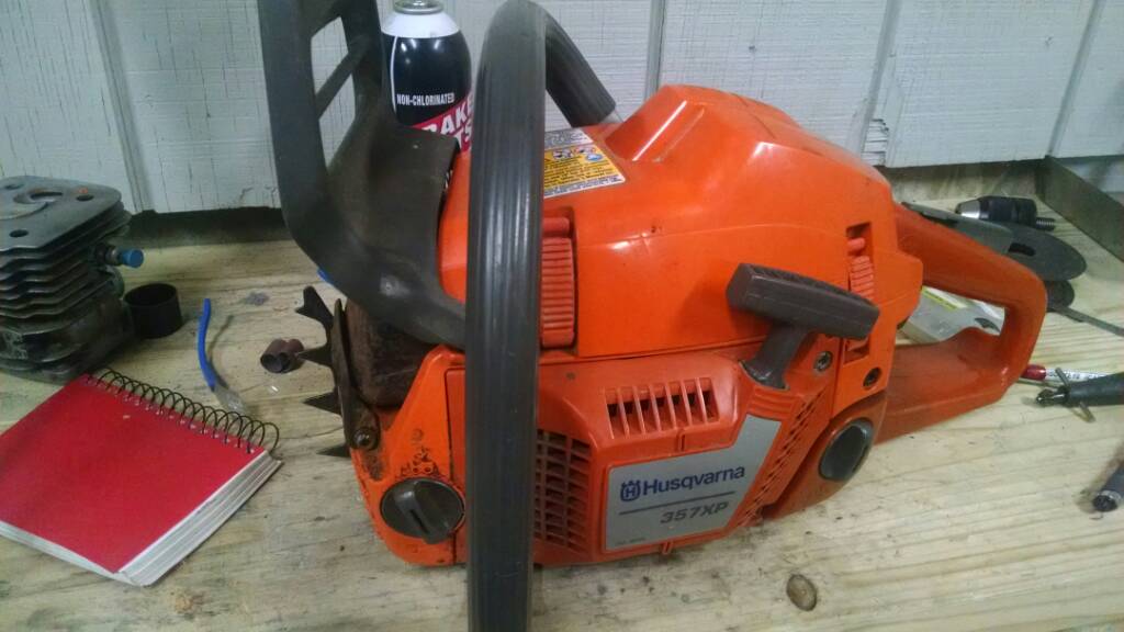

Guy with 3120 picked up and dropped off a woods ported 2013 372XP x-torq. He said he has tried tuning it and cant get it to idle. Took to a dealer and they couldnt fix it either even after saying they did. So now I have my shot at it.
Whats cool is he said a non internet saw shop guy ported for $120. Now that is the kind of prices I was used to seeing through 2010. Will get pics later.
I found 1 carb bolt really loose. 1 not real tight. Intake clamp around boot loose. Carb out of adjustment on L and I IMHO. Checked cylinder bolts and snugged as they moved hair not much.
Idles all day now.
