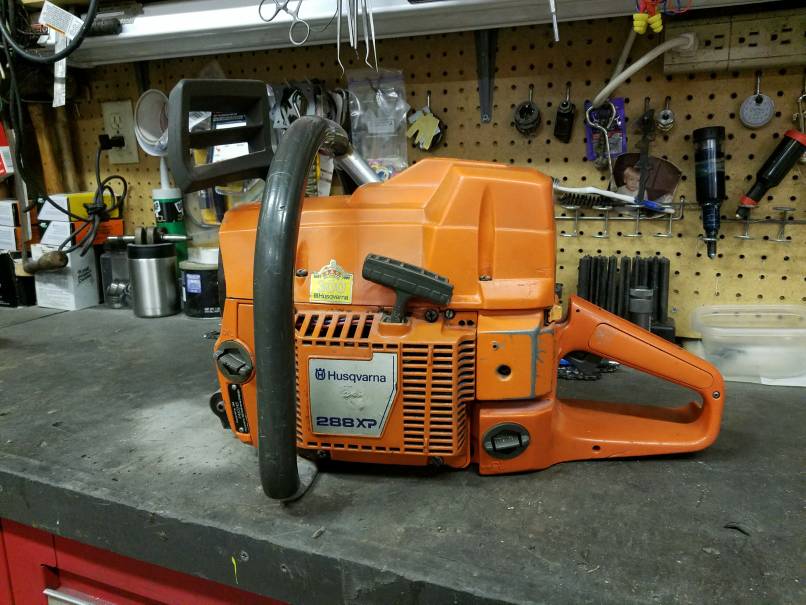

Nicest one of the dozen or so of them I have had. Almost like pulling NIB out. 60cc for those that dont know.
Getting the newest Bad Boy ready for new owner. He said he had a NIB PP330 too.
Put new impulse line, new fuel line and pulled them red and blue plastic epa stops to get full carb adjustment.
Just doing some trading.
6:42 AM
This is my next victim.......
