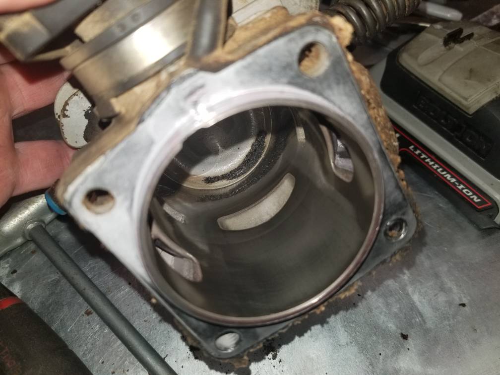

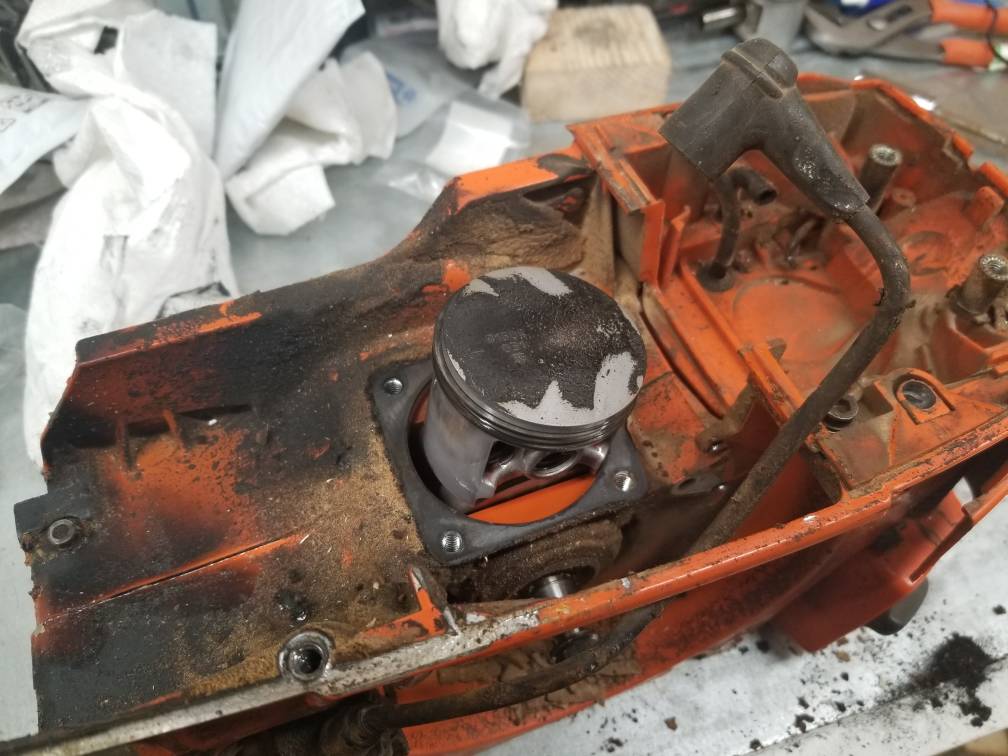

This one got split today. Bottom end looked good, but its getting new bearings/seals etc

That is the cleanest exhaust port and combustion chamber I’ve seen on a used saw! I am curious of his style of running, and what oil he uses?
He runs pretty hard. Always on the go. Very little idle time. He will just shut the saw off.
93 octane, and amsoil. It was red in the case. Thinking dominator?
2014 model saw, he figured 2mil+ board ft.
Here is the crown. I was surprised how clean it was too. On the inside anyway.
I love amsoil. Works great in my saws.
How does the skirt look, had high hour 066 you could have shaved with it it was so thin.
