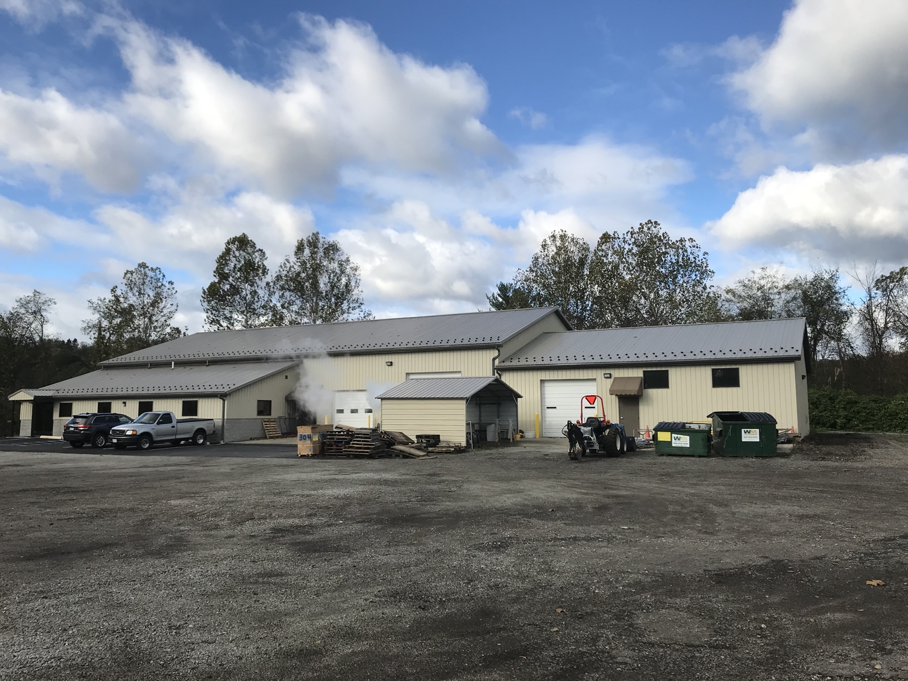

Need bigger shop
80 x 60 adddition in progress now
We i can get logs delivered great place for gtg
