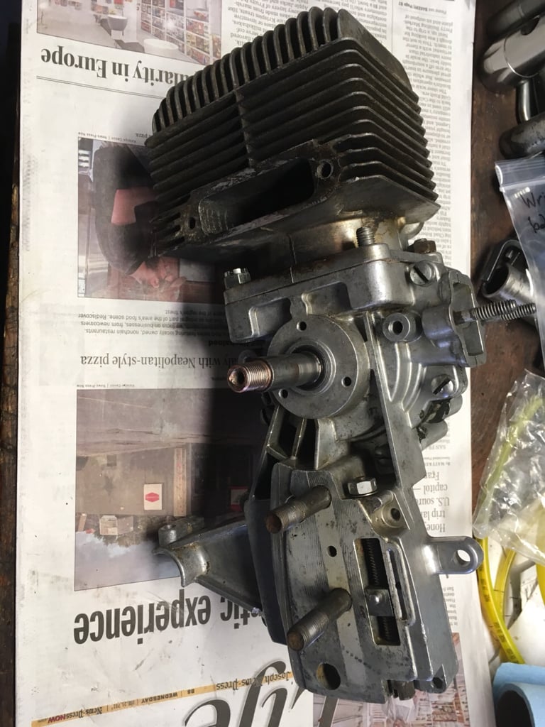

NOS piston & rings. New main bearings and seals.
I’m hoping the timing retard for starts works as it’s supposed to. There is no compression release for the 116cc. [emoji15]
