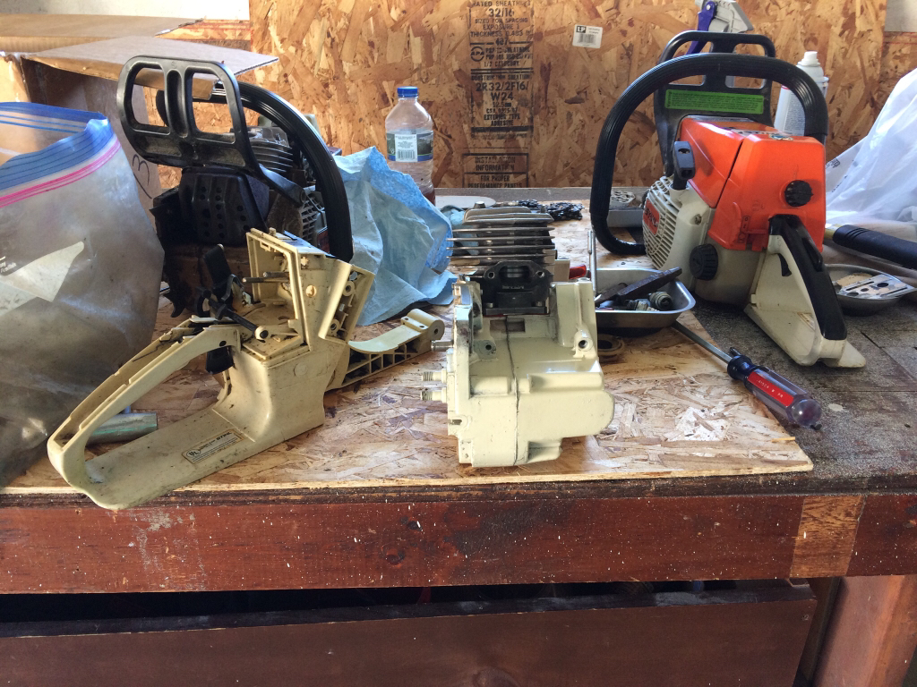

Looks new to me
It is not but I put new OEM bearings in it and painted the case with tractor paint. rattler cut the band and base for me on the cylinder I ported thanks Mike!
The one on the right is my Mofo I will run it today and see if the oil vent switch worked!! It really runs.
The one in the the back my buddy smoked the PTO side on it may be a parts donor.
