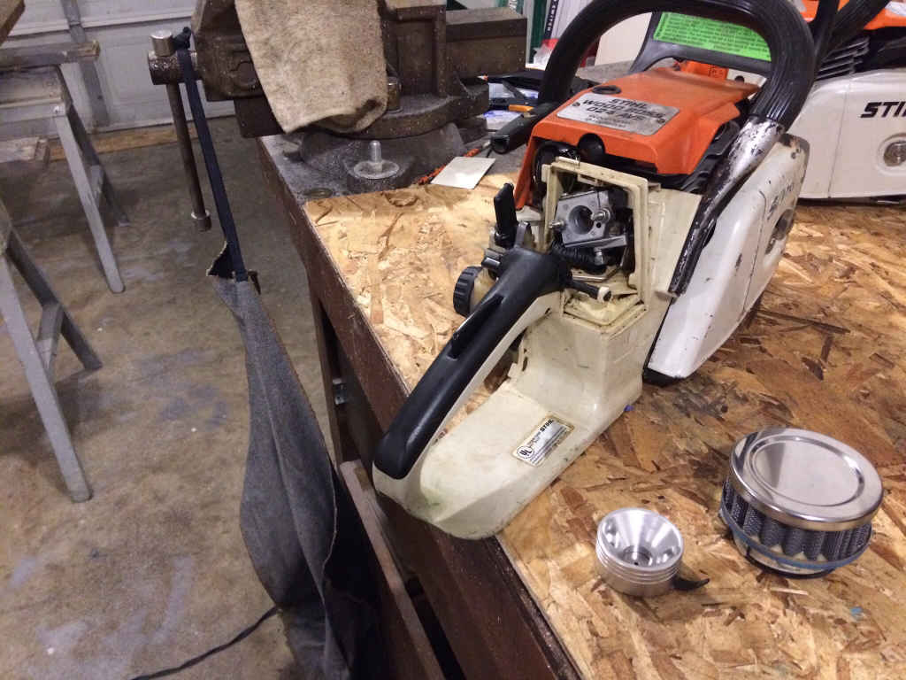

Got it done now just need time to tune and run saws.

Today it's a Poulan 3400, just needs a piston and a good cleaning. Previous owner apparently used a screwdriver for a piston stop and messed up the top of the piston. I checked the cylinder and it looked okay. I'm freezing the piston pin tonight and hopefully it will go into the rod without much hassle..these saws don't have circlips they just have a tight fit between the piston pin and the rod. The bearings are on the piston instead of the rod end, different...

Not sure on the oil? Carb was set real rich too.
