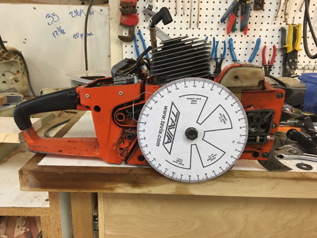

Here's a couple of pics saw is ported boxing carb up to send to poleman the # are 82* int ext 98 xfers are 126*

I like those numbers Mike.

I just got thru boxing up the carb to go to poleman for his treatment mine has a limited coil on it i think so I guess I will go in search of a coil. You think those # will do ok Randy?

If you need a carb now I have some sitting here. Those numbers will be fine. Limited coil isn't too bad of a problem. Just advance the timing a little and you're good.
