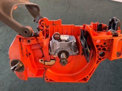

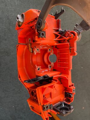

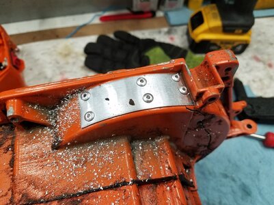

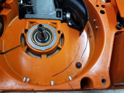

Husky 350 rebuild. Tore it all the way down to re-seal the bottom end. The cylinder riser was warped…I don’t think I have ever found one that isn’t. After machining it flat and removing the transfer dividers, I put it back together with blue loctite on the riser screws.IMG_0145.jpegIMG_0146.jpeg

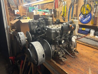

My wife got me a mess of sled carcasses for my birthday, with a ton of parts and two good engines. None of the sleds are actually 600ho chassis, so I’m going to have to get creative. The nicest one had a 600 triple in it, but that engine is long gone. One of the 600 twins was in a fire, but it looks like the engine survived, and he included all new rubber for it (wiring, sensors, intake boots, hoses, coolant bottle, etc.) The other one that will probably get fully restored and converted is a 700 chassis.

My sled used to have a triple in it and the twin hit the steering so my cousin welded a 45 degree piece to 1 carburetor and it sat in there with an angle on 1 carb lol that sled was fun I miss them

What are you putting on that for a cylinder Greg?
