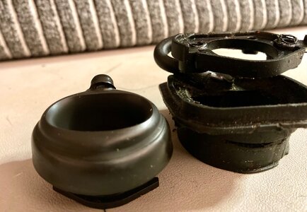

Not unusual to see with 340/345/346/350/351/353/357/359, Ripped impulse is not abnormal to see even from factory assembly.
Such parts are something that is mandatory on a new build for me, even if the old ones look nice

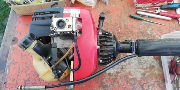

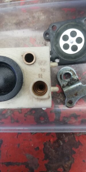

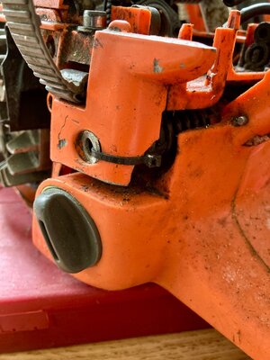

I don't know what the black button above the primer/Walbro plastic carburetor is for

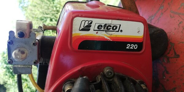

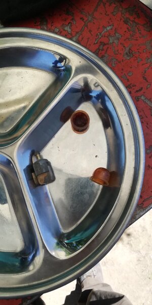

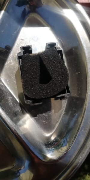

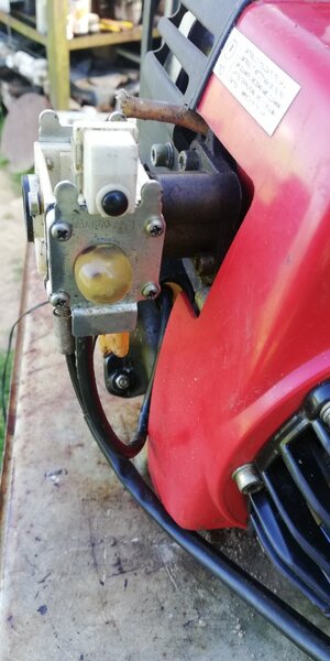

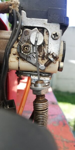

It actually starts better with this black button, even though the string is short. However, the seal needs to be replaced - there is one on the flywheel side. I'm looking for instructions on how to adjust a Walbro WZ carburetor, there are two adjustment screws on the carburetor needle. I also added an air filter, the equipment is probably 30 years old Efco 220
This might help. It gives instructions for adjustment at idle and WOT.

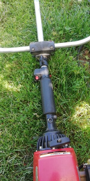

This little toy cuts surprisingly well, someone even played a trick on it and put a 3mm line where 2.4 is already too much. Now you need to put on U handlebars because the original D is sucks 😉😎

I found a bracket and handlebar that fit, I'm not always so lucky 😉 now I have to remove the switch because it's digging into my leg. I found the date on the original handle: 1992
