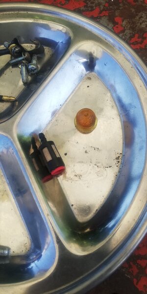

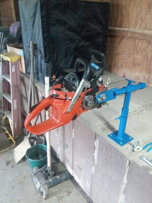

The Chinese filter fell apart and clogged the filter in the carburetor / I fixed it with a red cable before something better arrived and at the same time I replaced the poor primer

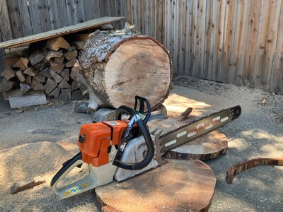

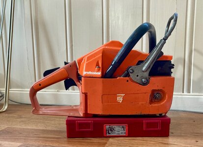

First go at porting is off the bench. Before it was turning 11k in 16 inch hardwood with the same 24" bar with full chisel .050 rakers. Now it's turning over 12k in 22 inch mystery pine. Was afraid to do a max rpm.
Throttle response didn’t improve but I didnt fiddle with idle speed and low jet much.
Thank you for the numbers and all the small details, OPE forum.

Well done !!!
