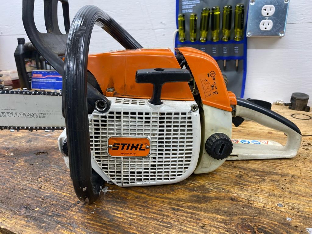

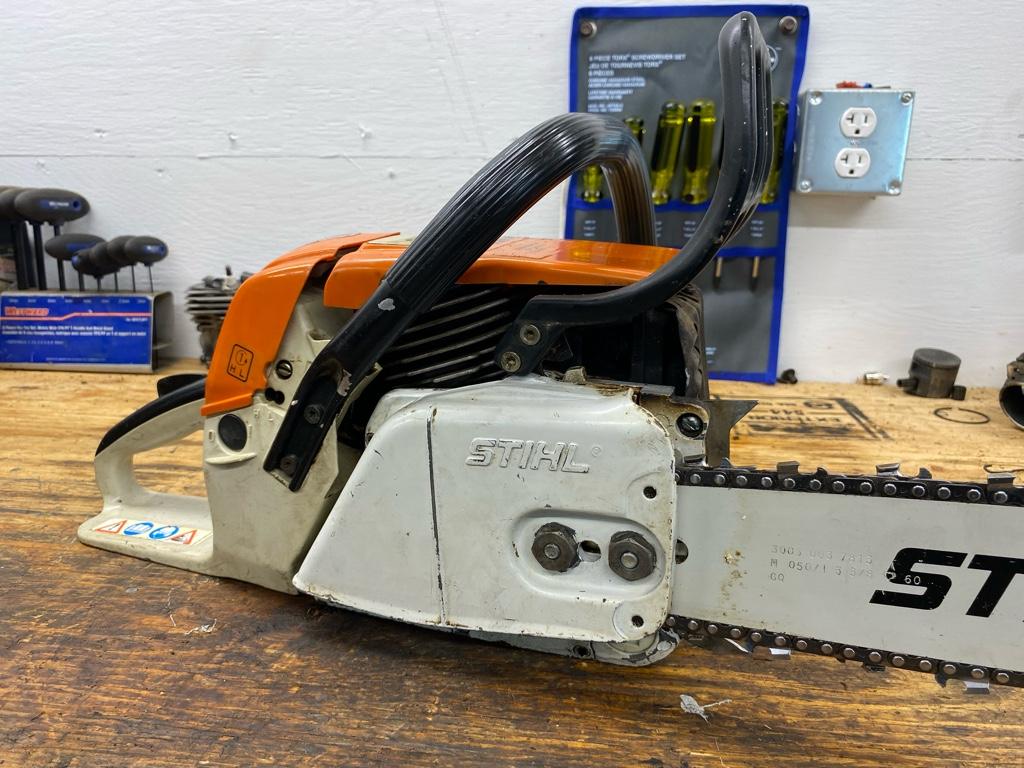

038 magnum, first one I’ve come across in my neck of the woods. Only needed crank seals, runs like a champ.
One owner unit complete with accessories and original manual, plus spare new stihl chain.
The question is, to keep, or to sell? [emoji848][emoji848]
