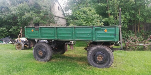

D 44 is an agricultural trailer with a load capacity of 3T 😎👍 I have one just like that 🤠 50 years old

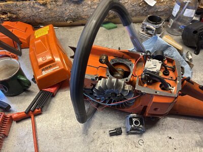

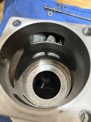

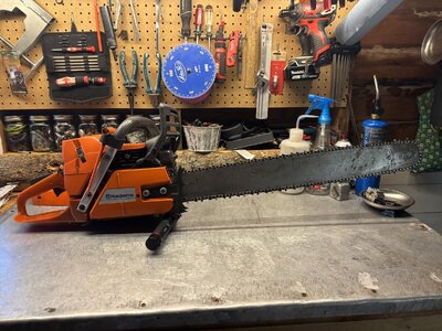

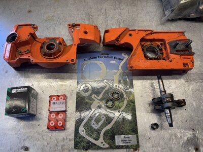

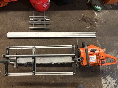

Well guess WTF is on the bench again. You guessed it.
I ran the 288xp today and made some cuts, but shut it down when I began to hear a knocking sound. Turns out the piston pin had spun out in the piston itself and was fitting loose in its holes. The piston was basically loose on the pin. I just ordered a Meteor and a set of 6203’s. I guess I’ll split the case and re-do this one. Anyone have an extra crankshaft for one of these? There was glitter in the case and I don’t trust the big end bearing anymore. Oh well…

I had a Kawasaki in my trimmer and all I had to do was move the connecting rod on the bearings. Someone was driving too lean or without oil, the piston was slightly worn and the connecting rod couldn't handle it

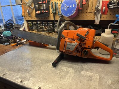

Finally seem to have gotten my 372xp figured out. Ran like it had an air leak, so I replaced crank seals and clutch side o-ring. But I ruined the o ring in the process. So I waited and got another, and installed it. Passed pressure and vacuum. Then still ran like crap. So threw another used carb on. Ran like crap. Replaced the nozzle/check valve. Ran better, but ran rich tilted forward and on its side. New Chinese carb installed yesterday and it’s all good now. I’ll run it in the wood a bit, and then it’s headed to @Stump Shot for port work!

Looks good Jack!
