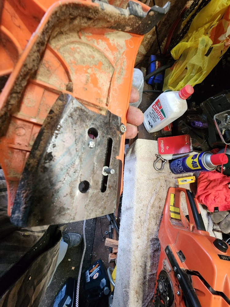

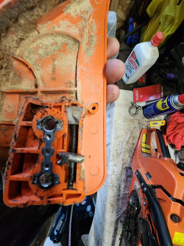

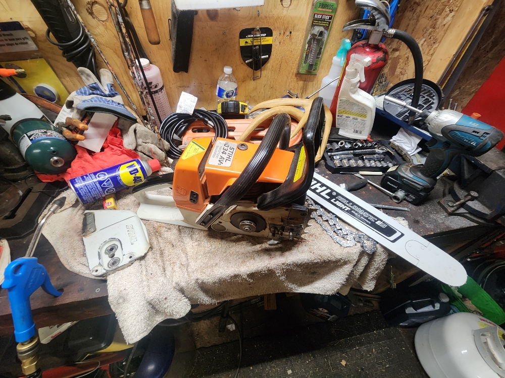

034 on the bench for a cleaning and a check over. It wasnt running too good. Kept going rich and stalling on idle no matter how much low was leaned up gonna pressure and vac test some time this week to make sure and if thats good will open up the carb and see if its good in ther.
Sent from my SM-S901W using Tapatalk
