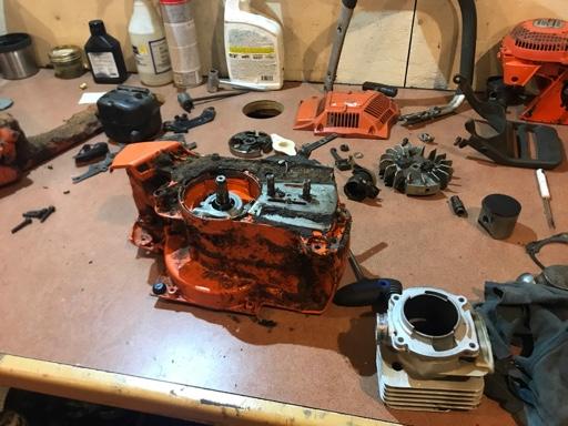

My first husky 362xp on the bench. Would like to keep it a 362 since the p&c look very good yet. Just missing a carb and sprocket cover. Carbs not a problem, but the cover is since it’s small mount. Anyone have an extra?
If not I may change that side to large mount.

Could re-drill a d009 cover and camouflage with an outer dog? Haven't looked at feasibility, just spitballing.

That would probably work, it just so close that it would create one long hole. Plus with holding a 372 case beside it, it looks like the rear stud isn’t in the same spot as the 362 either.
Plus I’d kinda like to keep it original...this case is one of the better looking ones I’ve ever seen, hasn’t seen a lot of use. Might have to shop for a cover.

Go with large mount! My 2163 which is jonsereds version of the 362 is a small mount. I was running 24 and 28 inch bars, and the case cracked between the studs. After some research, it sounds like a common problem, and that why Husqvarna went with large mount on the later run of 362xp special's

Outer spikes are a pain to redrill and line up too, and your stuck with a front chain adjuster. As soon as I find new cases for mine, I will happily get rid of this small mount issue

Clutch covers are still available for 362's, I just got one a few months ago 503769201. I also have one that had a damaged case and transferred all guts over to an aftermarket large mount case. All the OEM transferred except for the oil pump output line.

Good to know on the oil line part, thank you!
