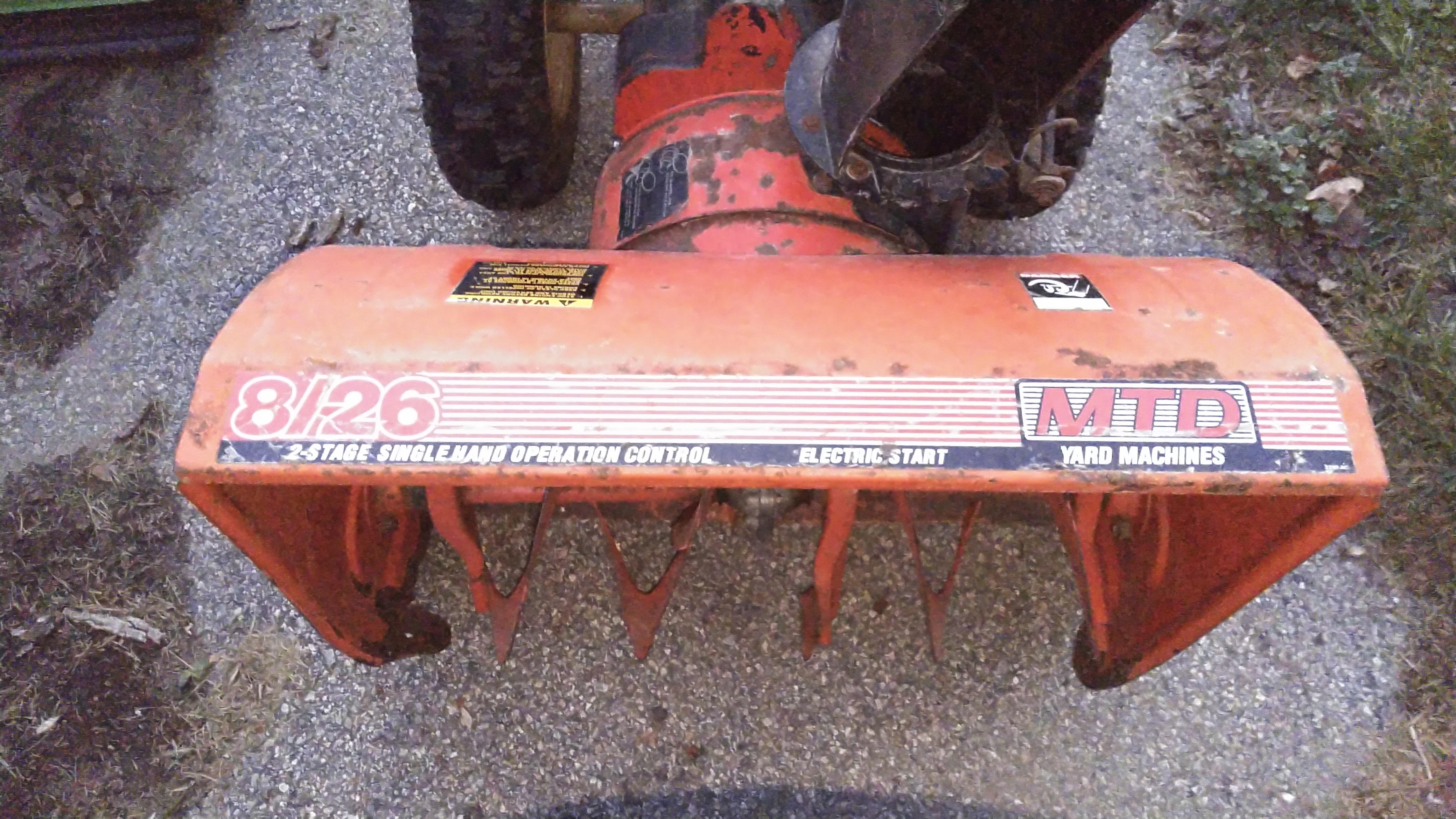

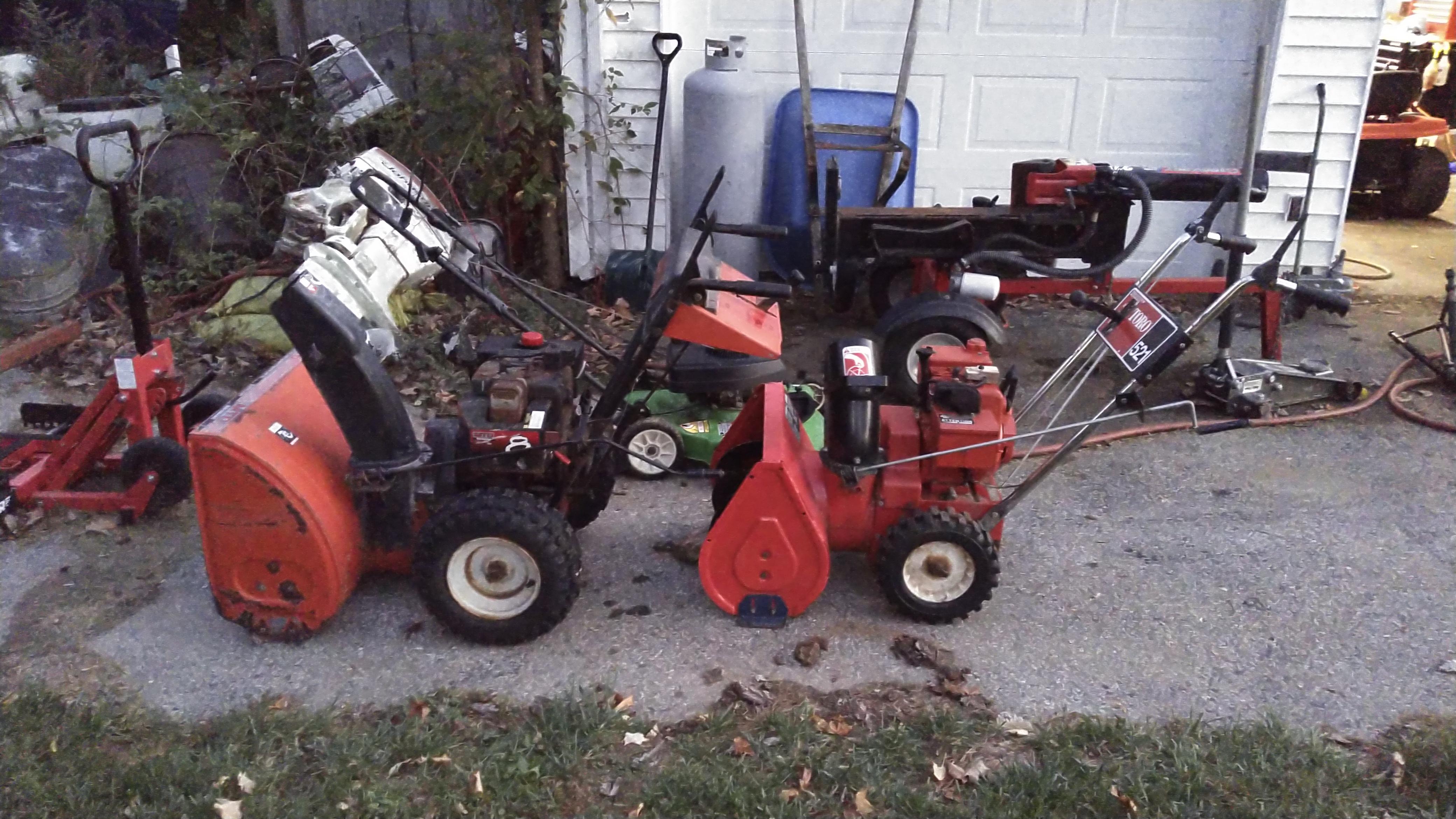

Not much lately. Been very overwhelmed with everything so I'm taking some time for myself. But Sunday afternoon I evaluated a couple snowblowers that I'm flipping. The 8/26 just needs a carb, slide shoes, drive cable and engine service. The Toro 521 got a carb kit and good to go.

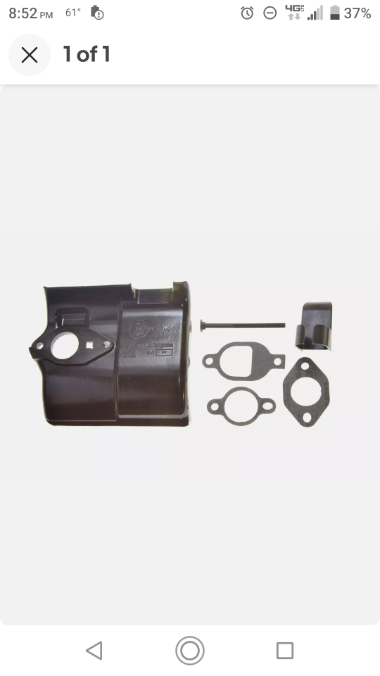

Lady with the Troy Bilt rider let me know it's still not right. Decided to do some digging for bulletins on the Courage 18. Had 2 which don't look like they've been done. One is an updated heat deflector between the carb and cylinder head. Have that kit in stock now. The other is an updated shutdown solenoid with heat shield for the carb. That's on order.

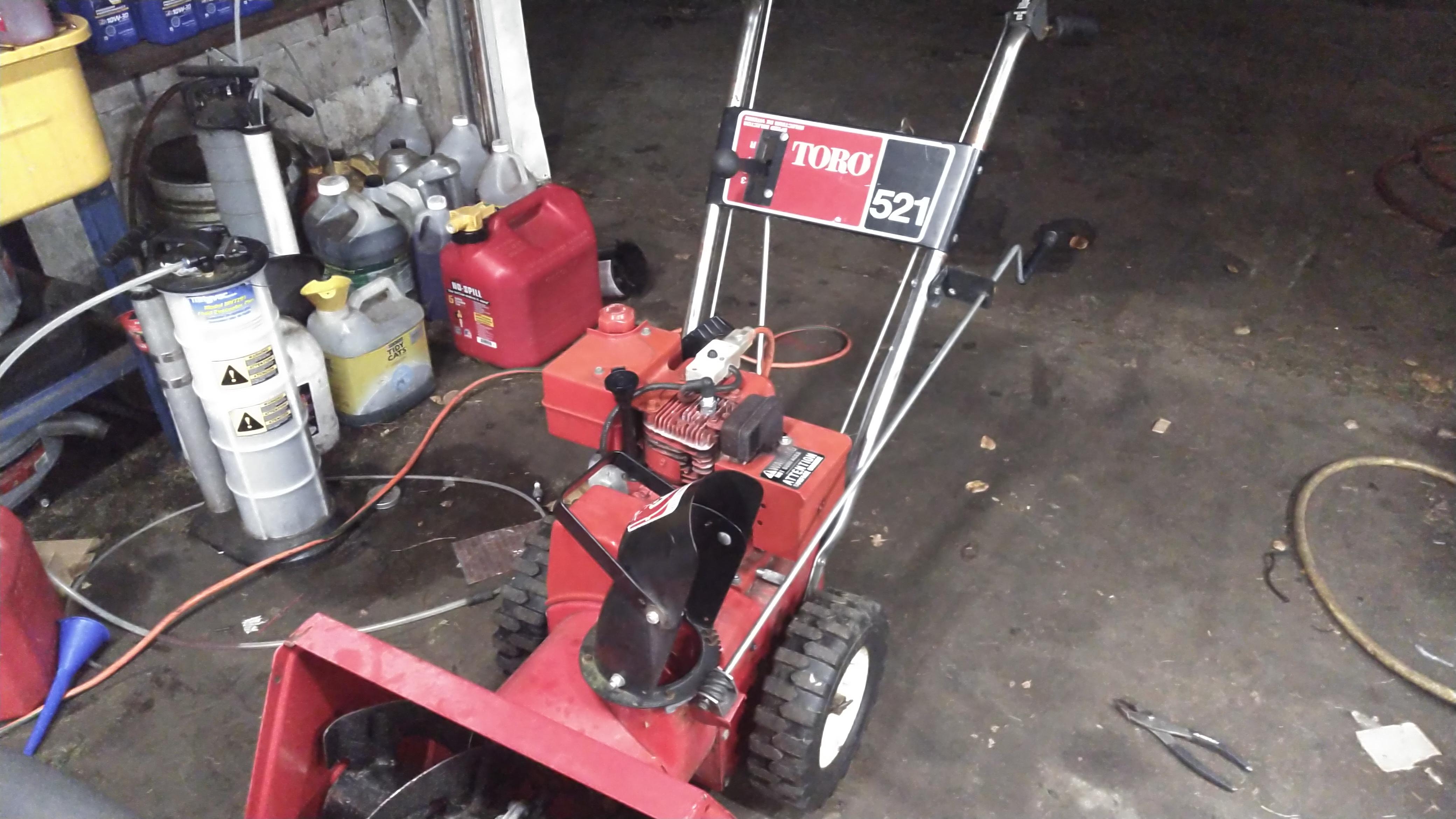

Last night's project was this Toro 521 snowblower, replaced the carb and got it running. Set up the governor properly as it was over revving. Adjusted the carb, replaced the plug and good to go. Already sold it for a very good price.
Tomorrow I have a Yard Machines 8/26 to get running and fix a few minor things on. Then it'll be for sale.

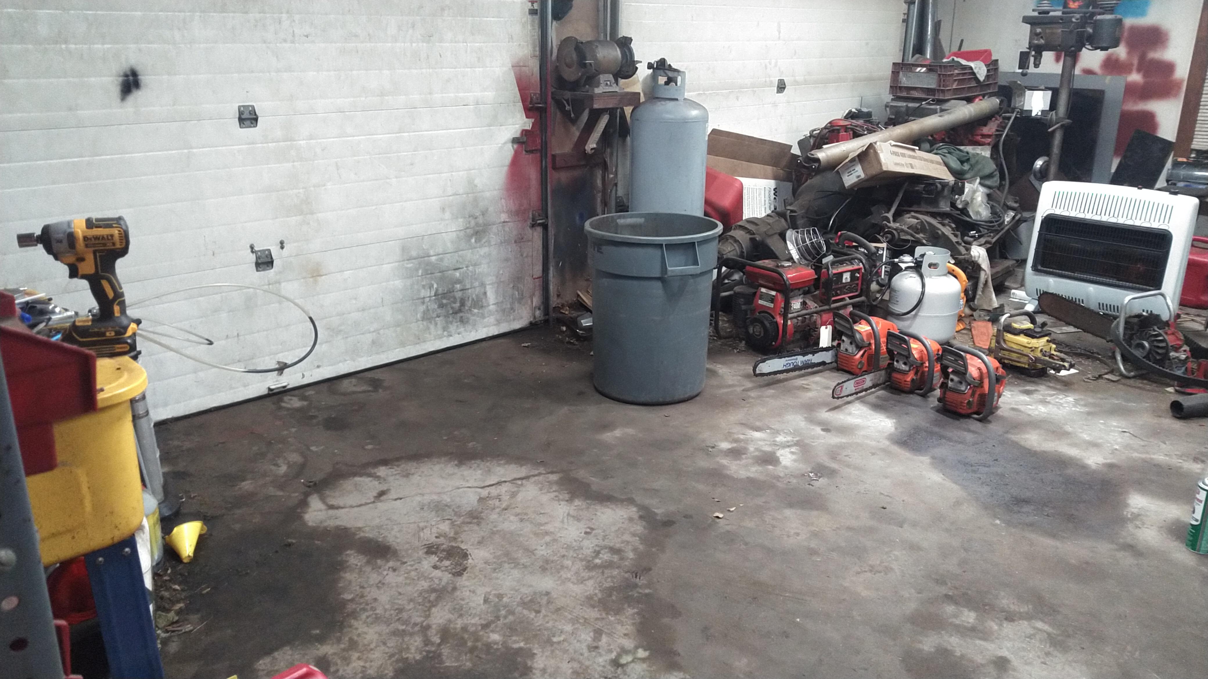

Did some shop cleanup today. I'll continue my cleanup project tomorrow.

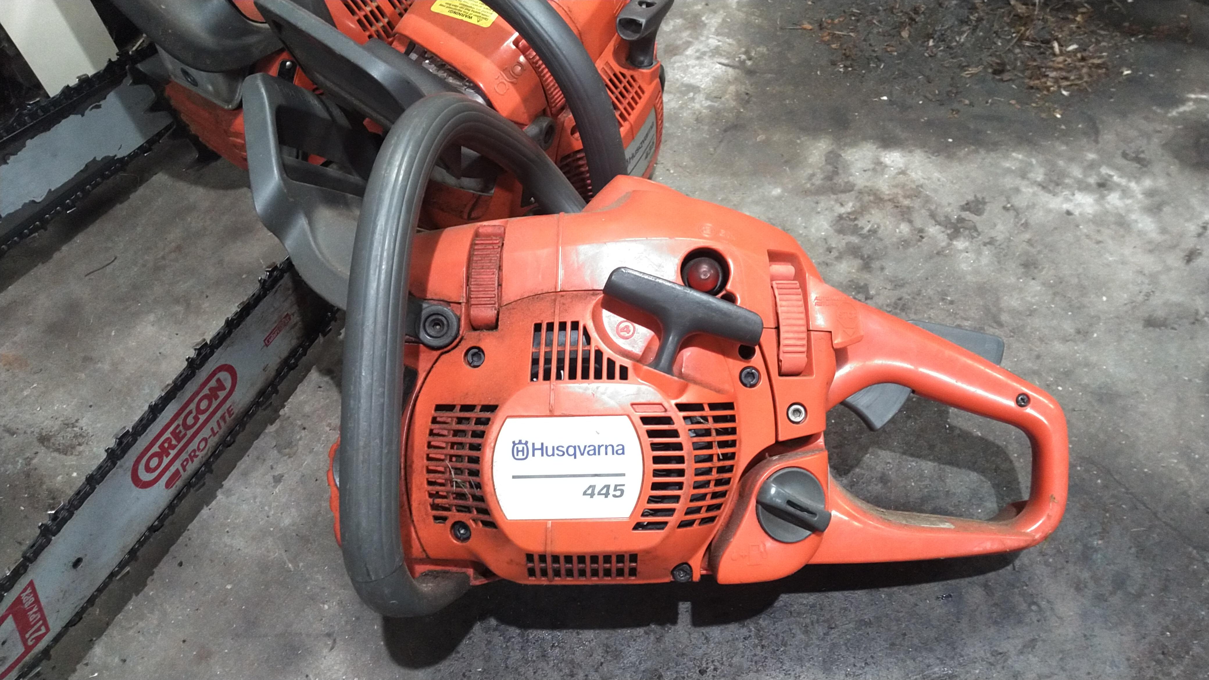

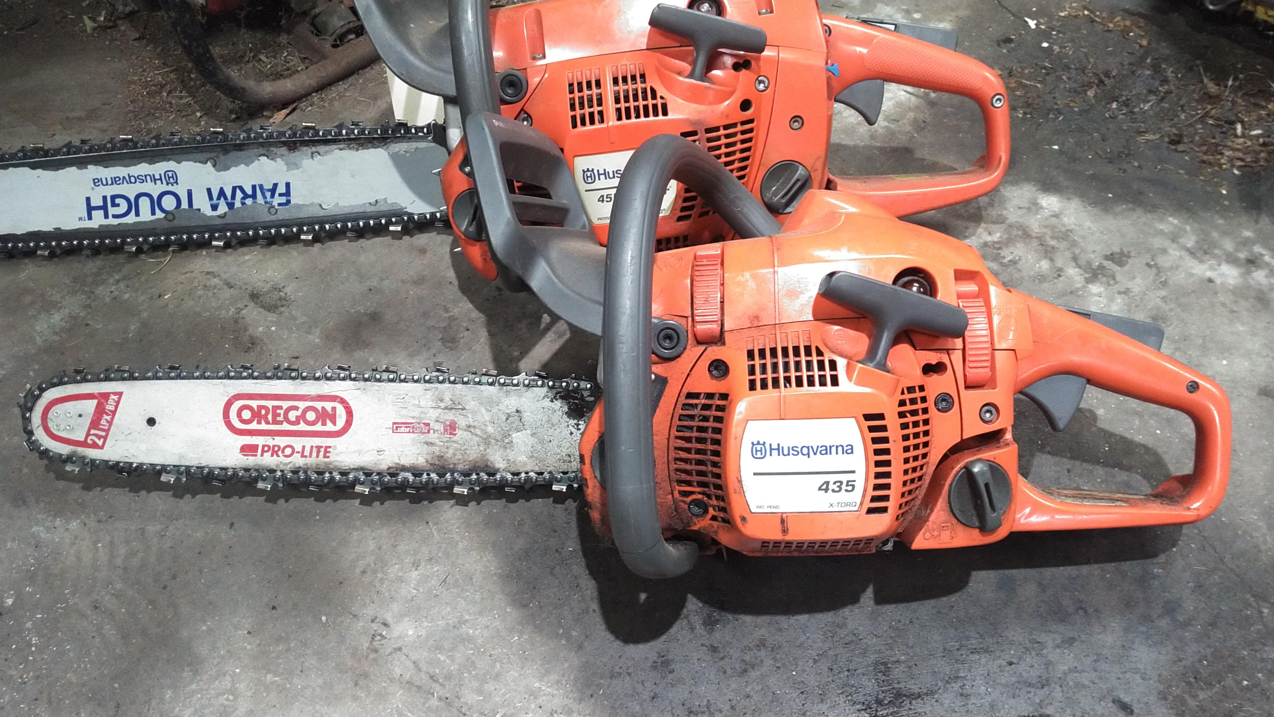

Also evaluated 4 saws. The 455 just needed a service. The 028 WB needs an intake boot. I'll have my dealer order it Monday. The 435 and 445 both run, I need to evaluate them deeper tomorrow.
