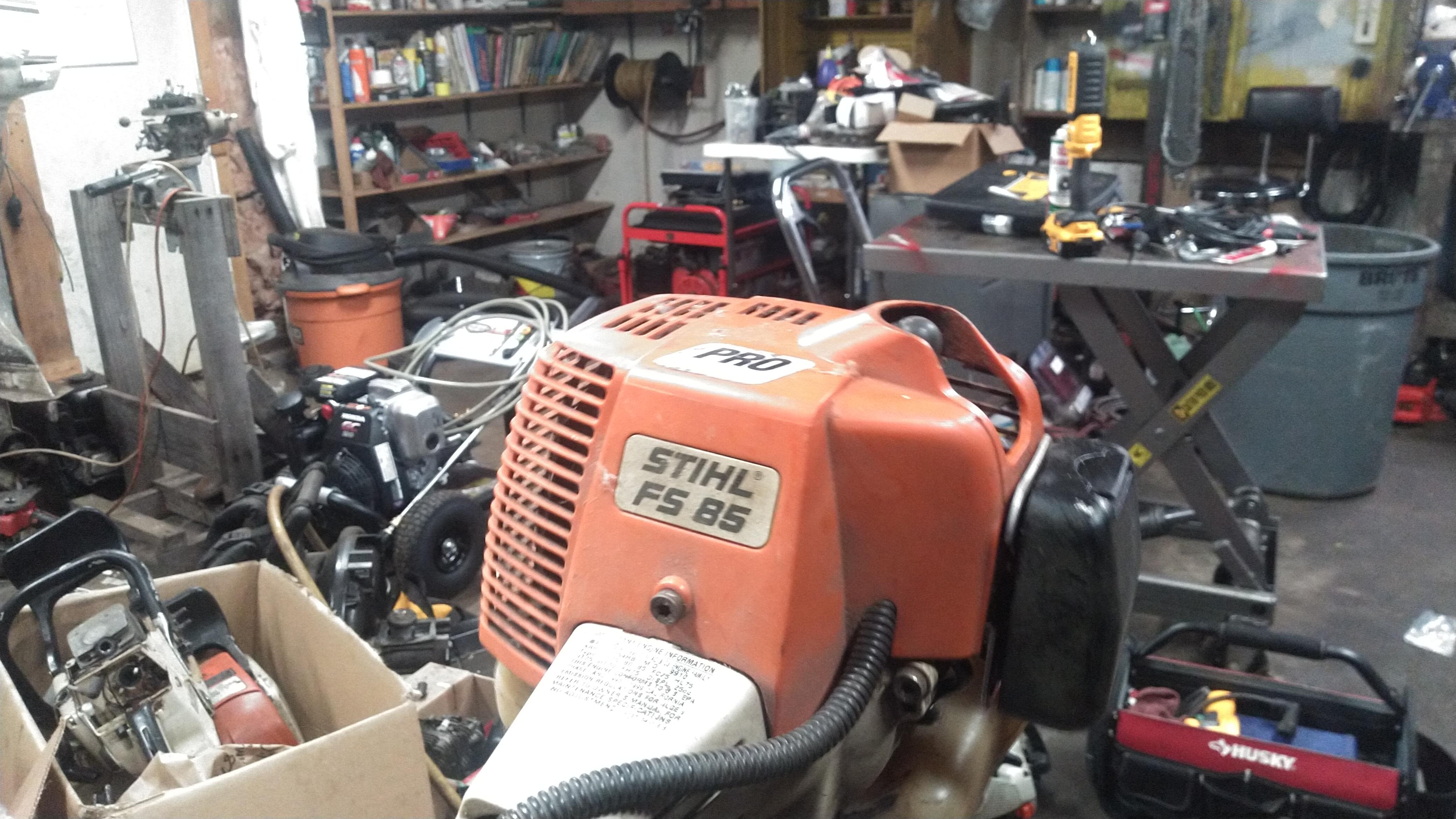

FS85 got a new carb, fuel lines, fuel filter, plug and fuel cap. Runs excellent.

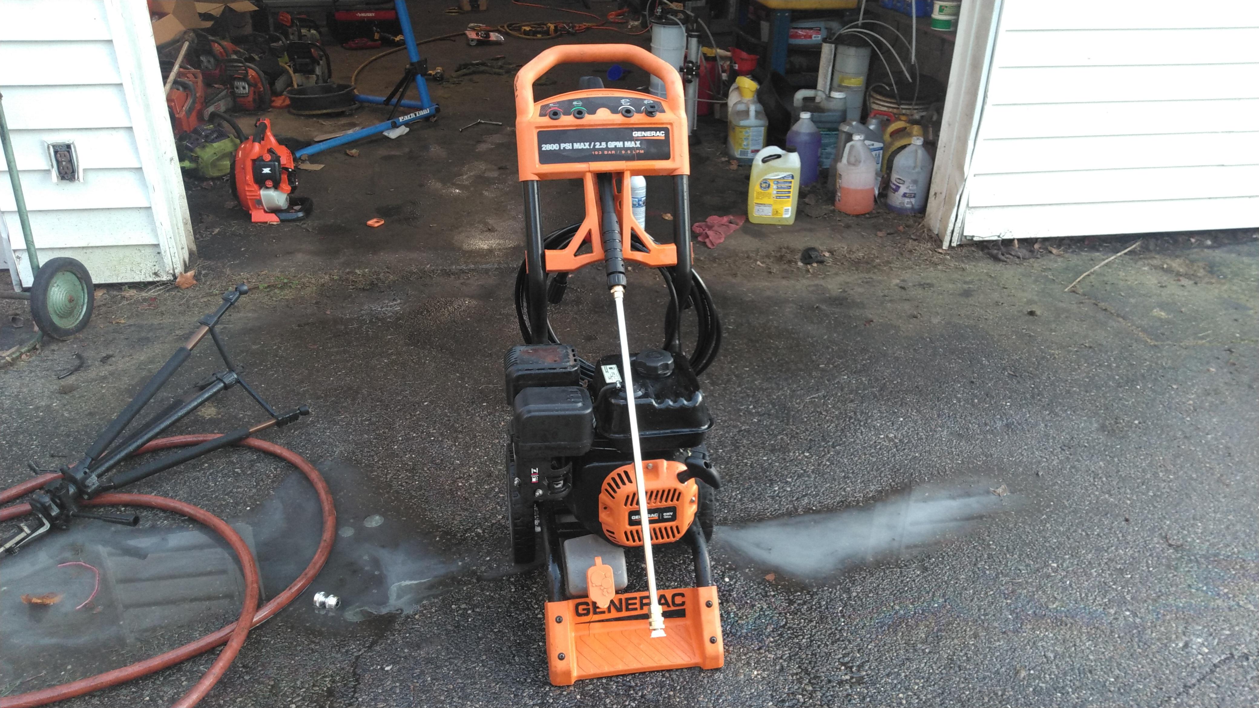

Finished up the Generac pressure washer. New valve cover gasket and soap tank cap. Gave it a quick detail for retail with some Gunk and pressure washed it with itself. Drained carb and put some pump saver in the pump.
