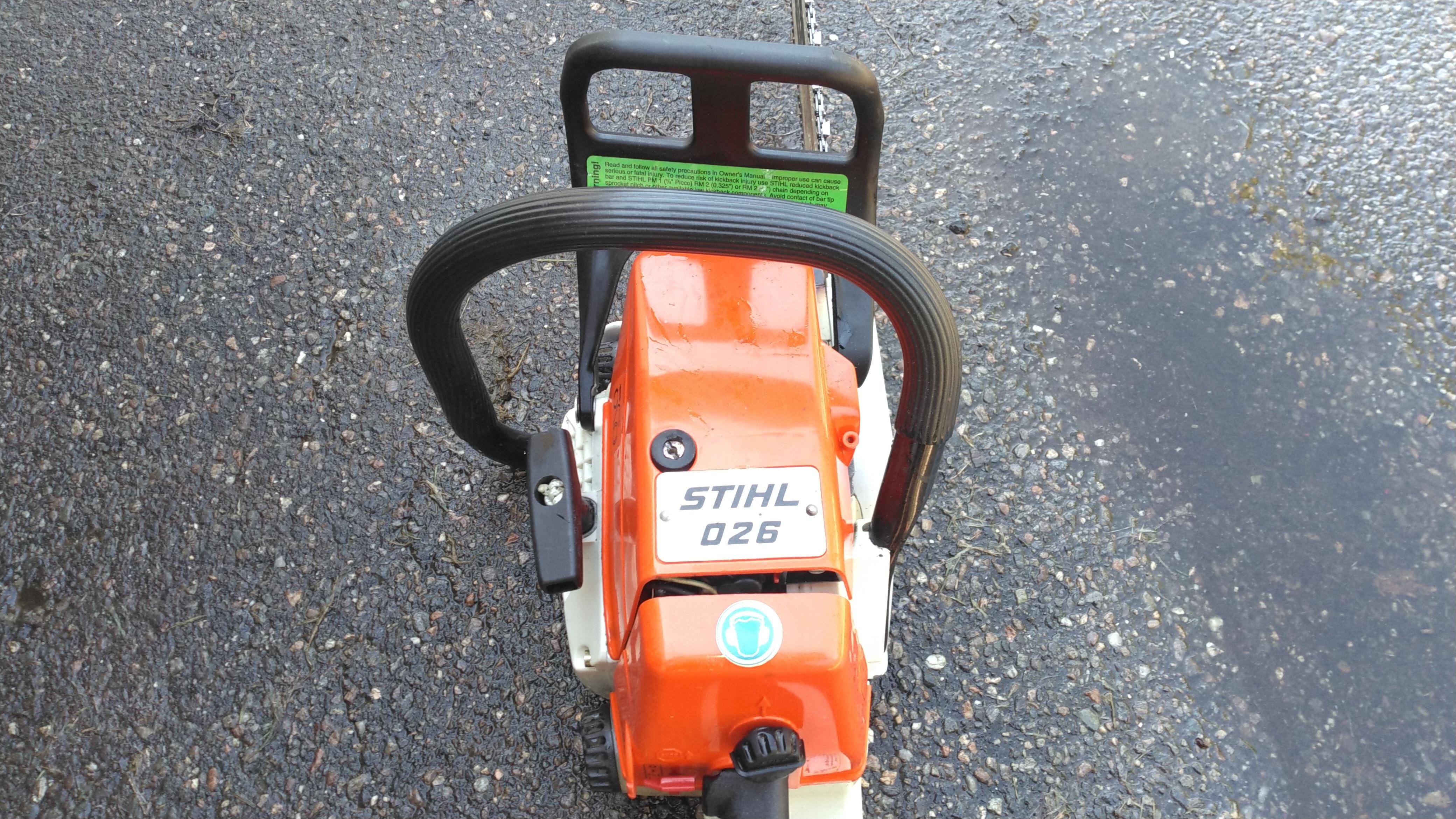

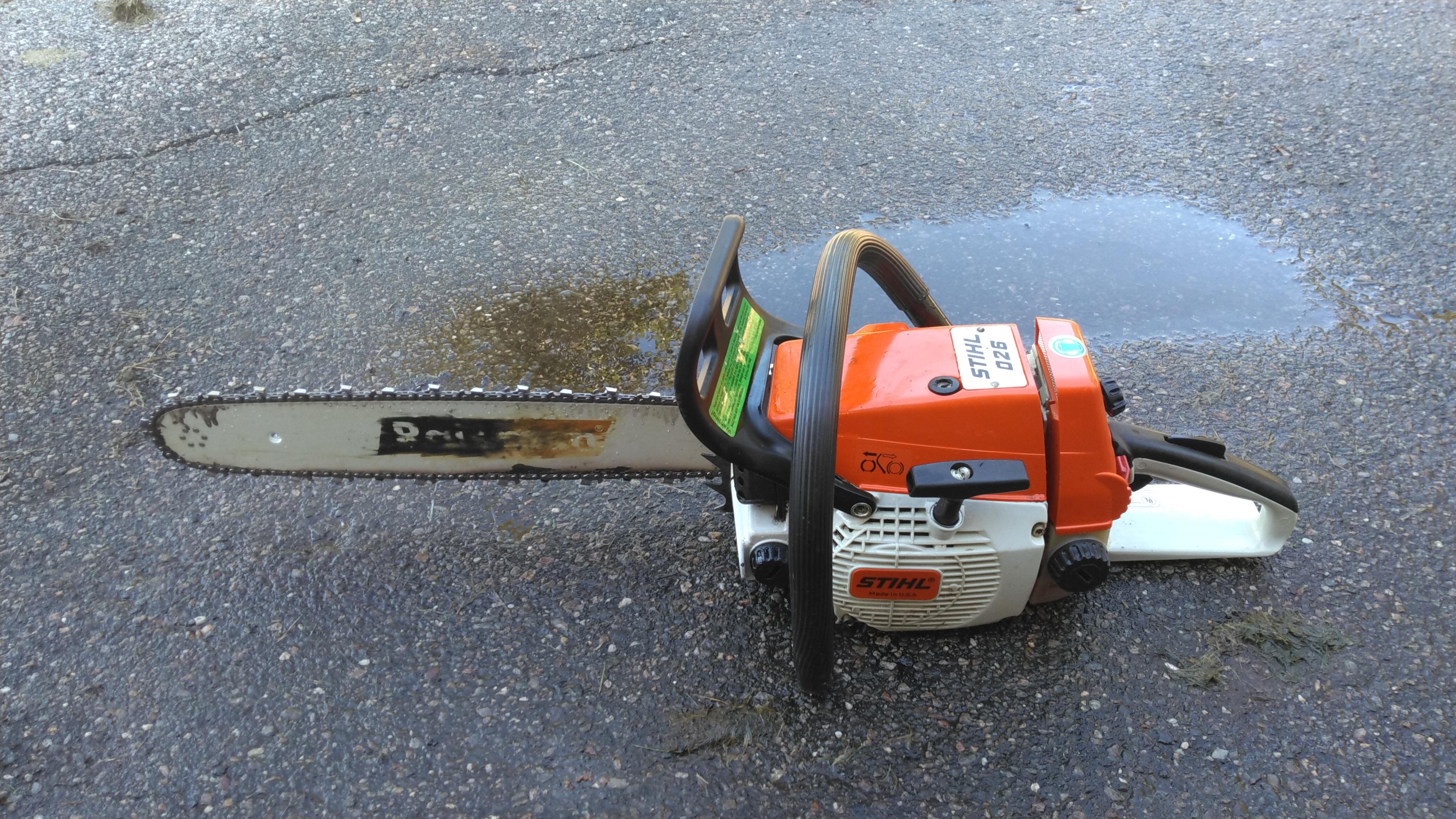

Washed up my buddy's 026. Looks great.

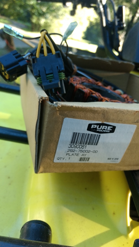

Hey Marshall I believe those have a "sure power box" which we called sure no-power box...
Those are usually the cause of almost all electrical gremlins.
If it does turn out to be the stator I may have the correct one NIB. You probably don't want to know the OEM price on one if you can get it!!
Yep its sure power ecm, it was actually replaced under warranty in 07-08. But I'm pretty sure it's the stator. To far off from specified measurements.
Let me know if you have one and what you'd have to get out of it ,and well see if we can make a deal. I replaced it about 3 years ago with a caltric brand.

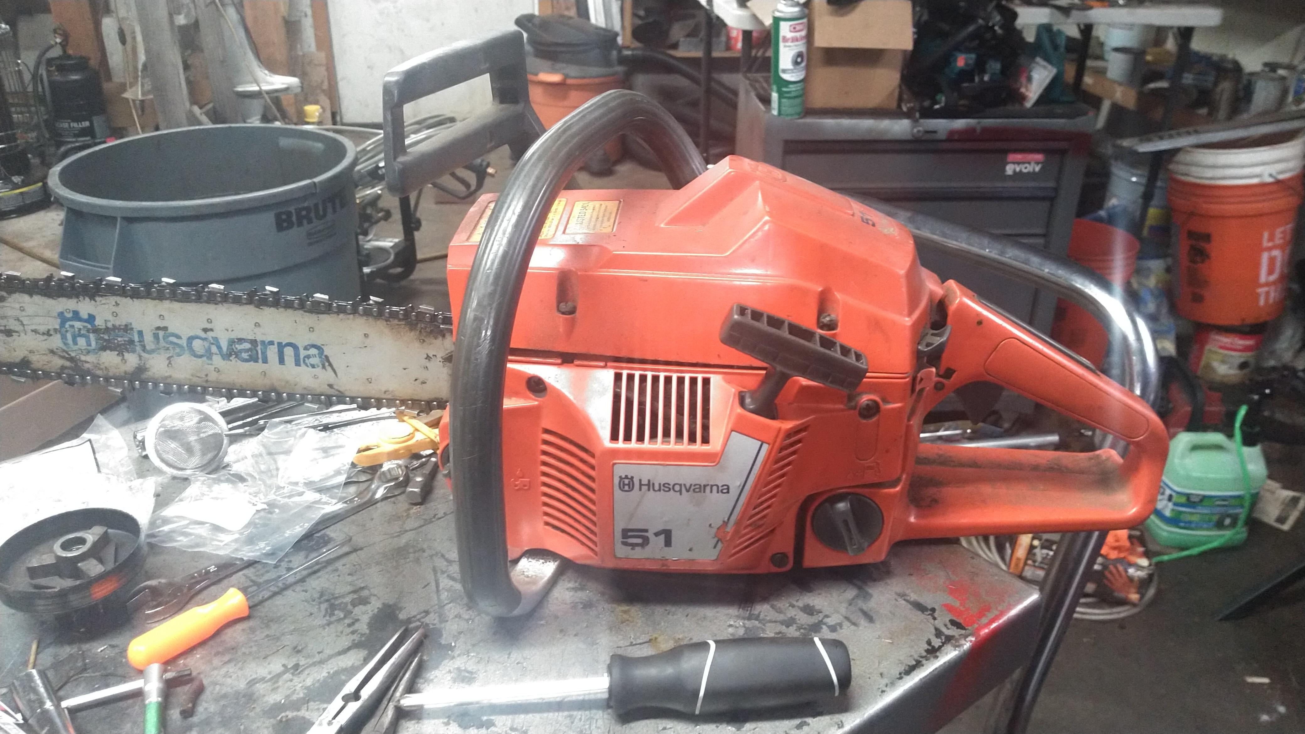

Got started on this 51. Made sure it ran which it does and very nicely! Rewound the recoil spring and installed a new proper length rope. His complaints were the recoil was messed up, a service and clean, and a new bar and 2 chains.

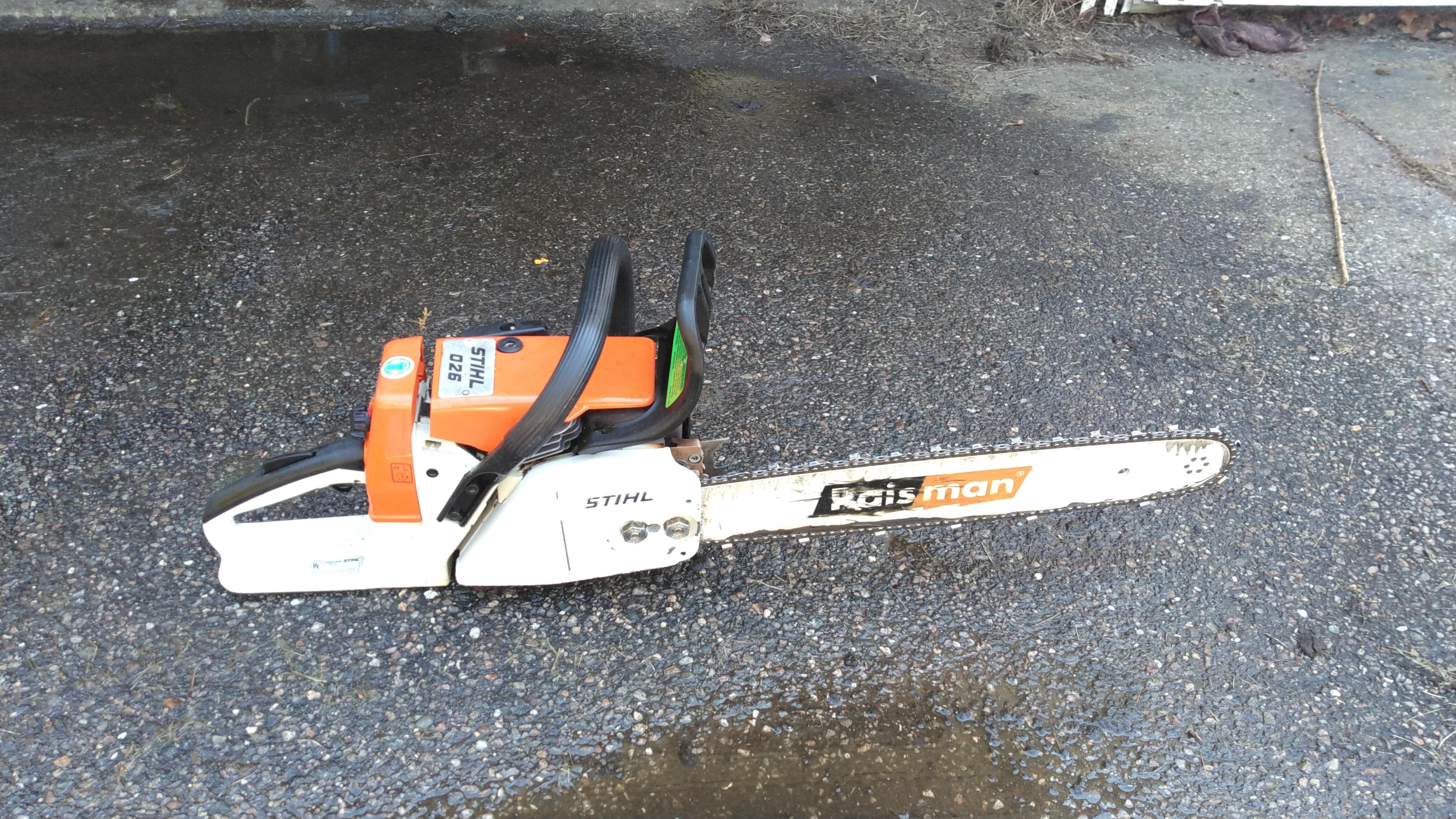

Stihl 020 Super x 2 - one top handle, one rear handle. Top handle saw is roached; figure I'll swap the handle to the really clean rear handle saw and keep the rest for parts. Also on the bench - 038 Magnum - just had case powder coated. Nothing fancy, but does have a 3 port muffler and a base gasket delete.
