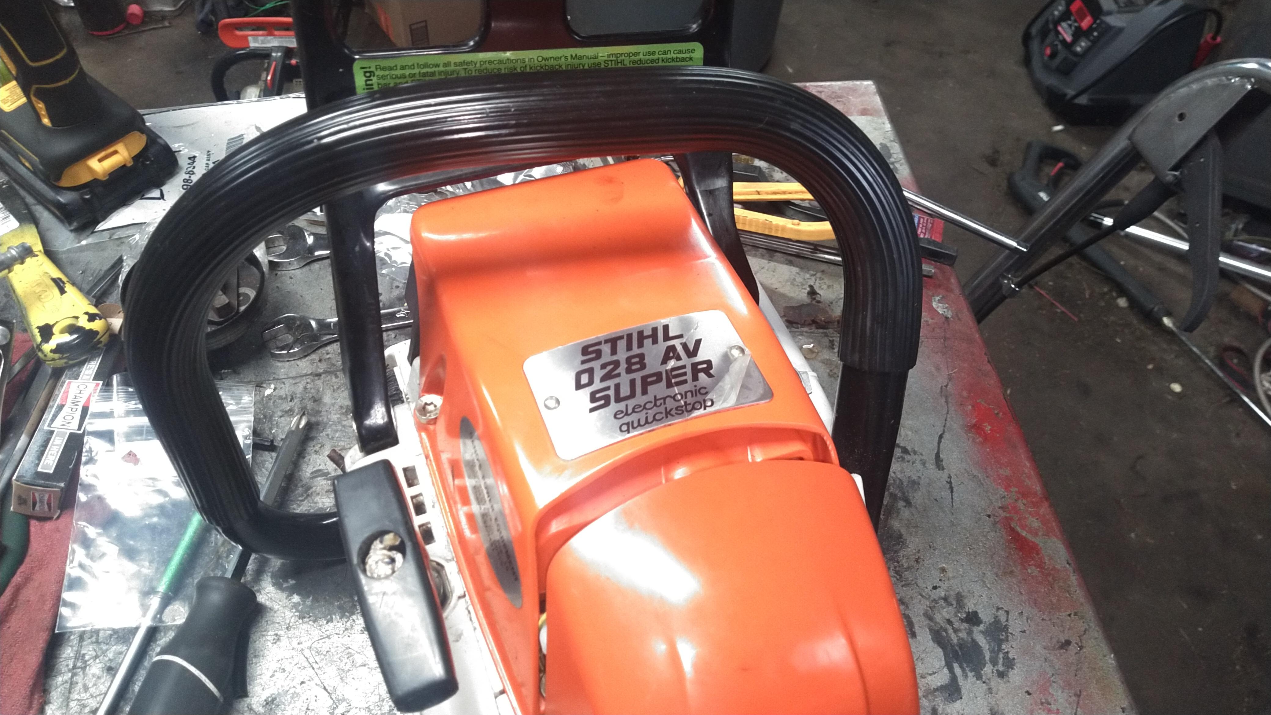

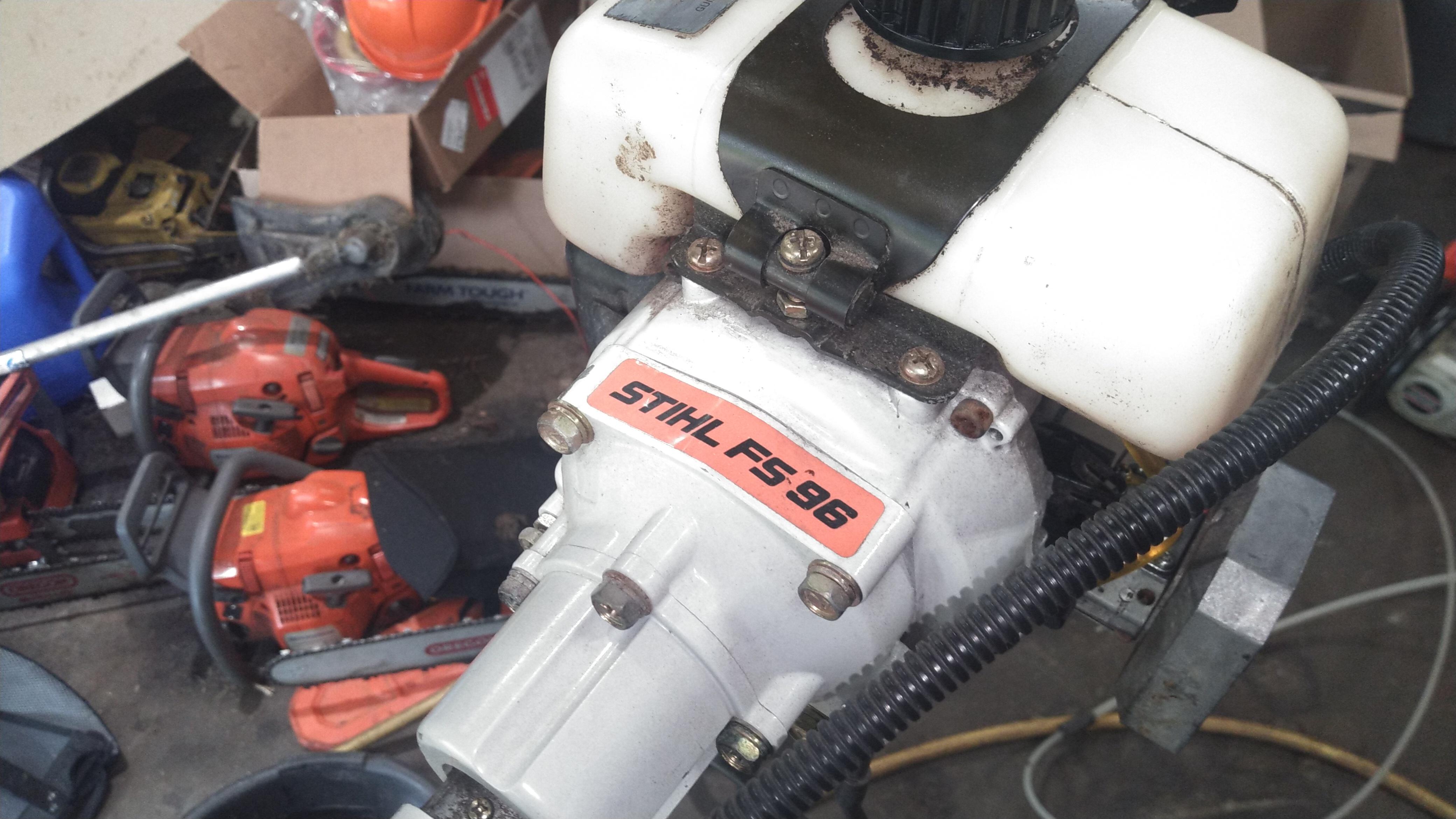

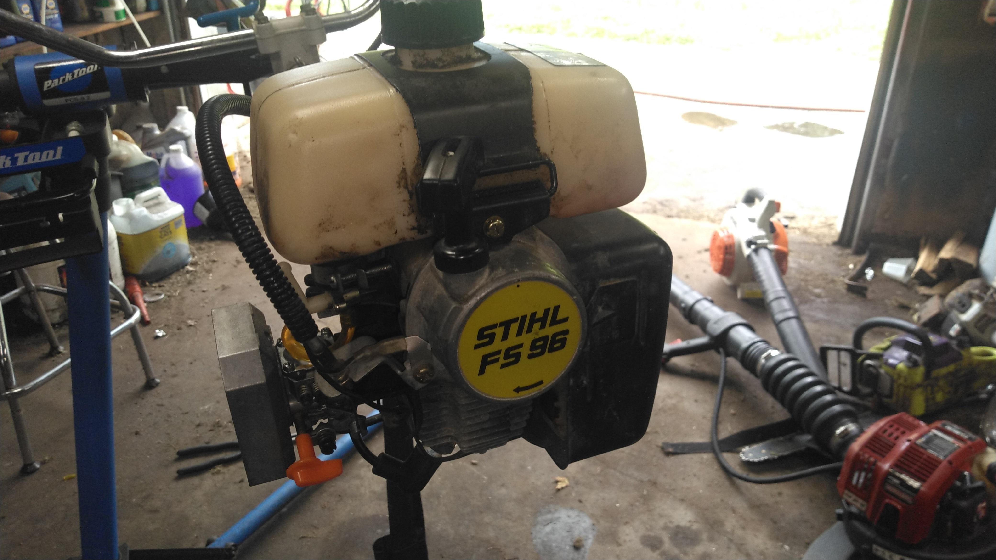

A couple of relics.
028 Super got a new clutch, tank vent, plug, fuel filter, air filter cleaned and pressure wash. Just need to sharpen his chains.
FS96 got a carb kit and fuel lines. Ordered a new fuel cap.

028 Super is one of my favorite saws, reliable as a rock and cuts well.

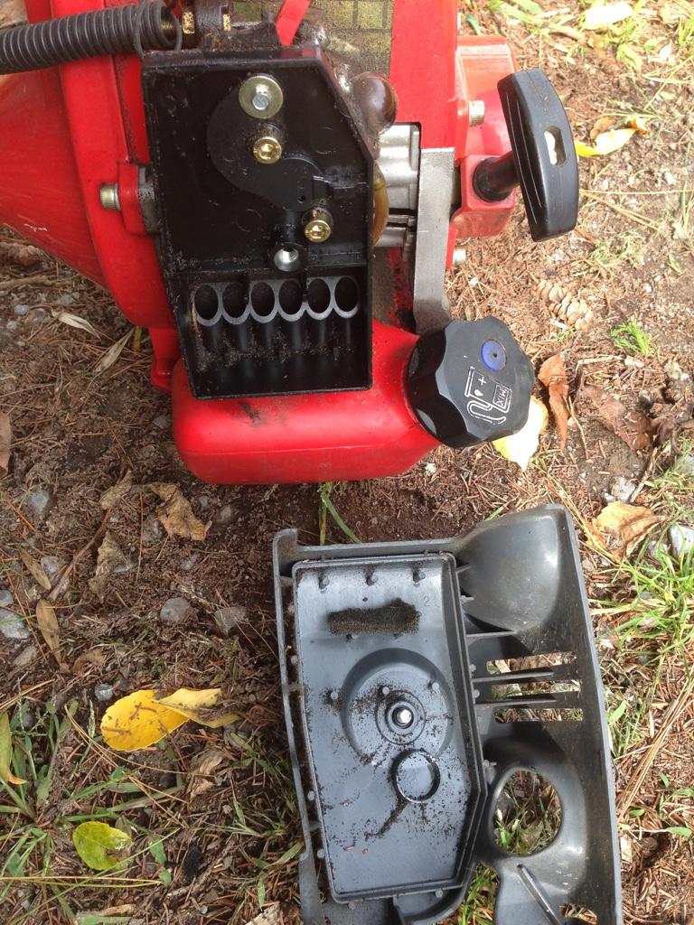

I have an EFCO 8420:brush saw I have had 30+ years. Bought it when we first got the property and we’re building trails. These days it gets an hour or two of use a year clearing brambles off the trails.
Thought I would check the air filter before using it.
I guess I need a new one! Disintegrated except for a scrap left.
What do I use and anyone know what the original looked like?

I don't know if this company is OK to buy from, but they have parts diagrams:
https://www.efcoparts.com/efco-8420-trimmer.html#8301_1
You might be able to cut a piece of filter foam to size rather than buy the proper filter?
