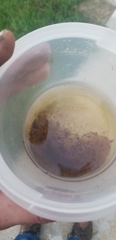

My 19 hp Kawasaki stopped cold the other day. Drained the carb and fuel line. Think I found my issue. Lot of water and dirt. It's a old mower. I was wondering why it had no power.
Just curious. Did the mower have an in-line fuel filter on it? If it did, was it changed yearly or part of a regular maintenance schedule?
I put one in at the beginning of the year. I'v been torturing it all summer mowing several acres a week to get the bugs worked out. Figured out the fuel cap leaks.
