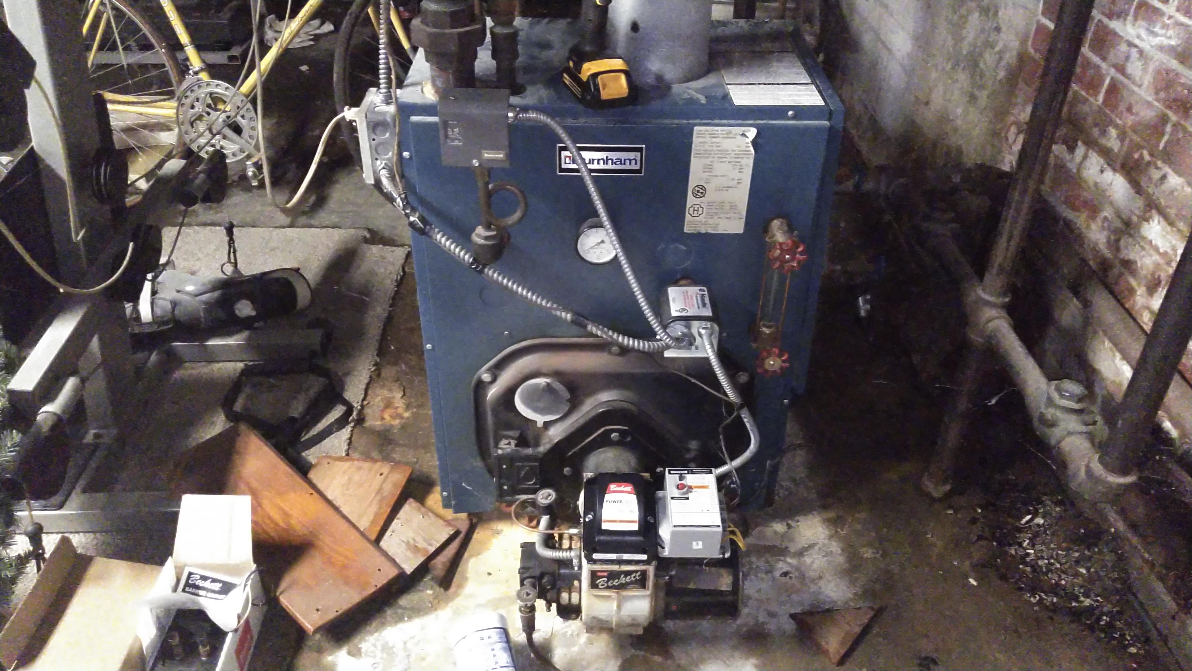

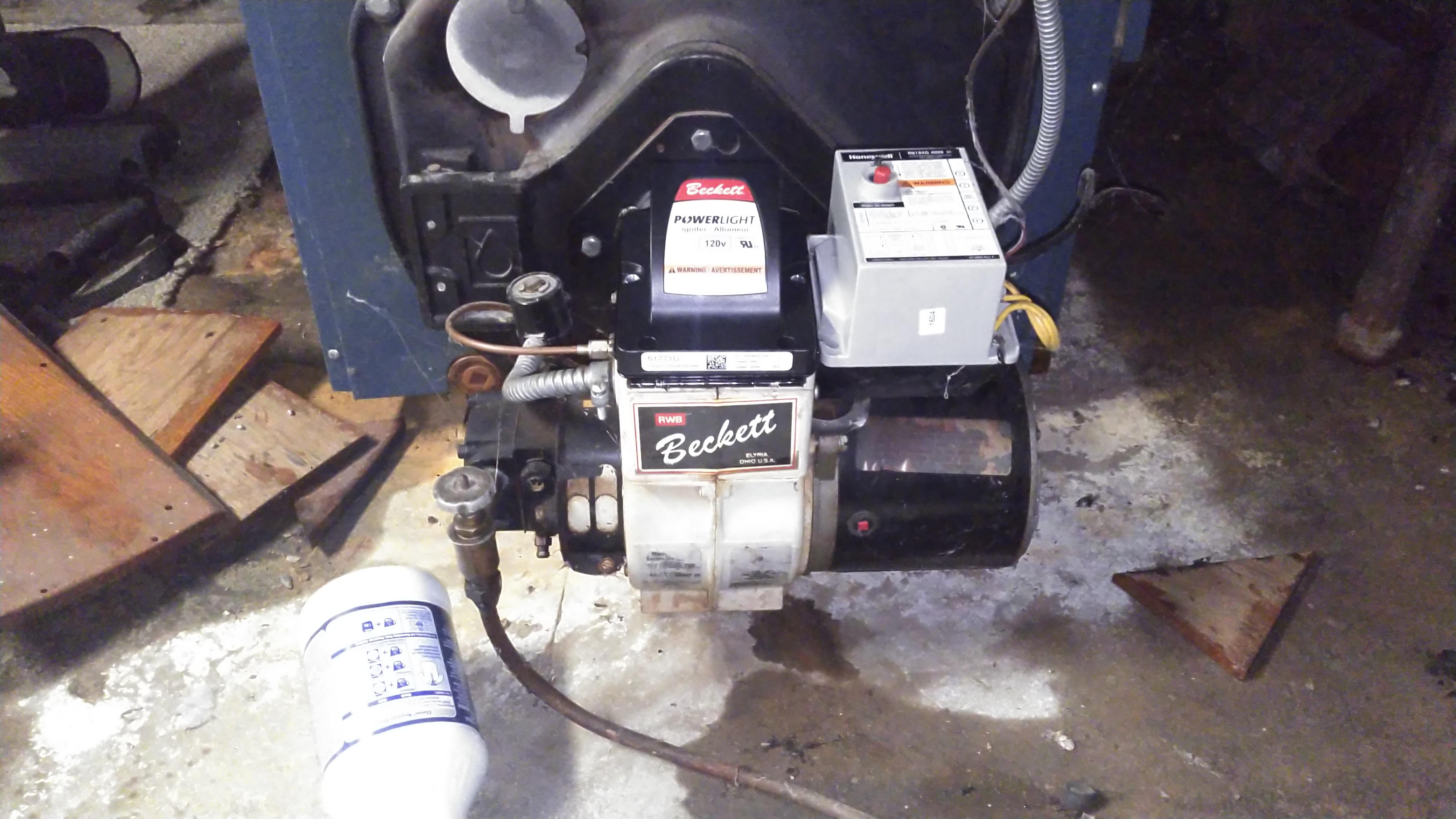

Had some basement flooding due to the remains of Ida. The GFCI for the sump pump tripped due to an unnoticed extension cord on the floor and we lost the dryer and the motor for the oil burner got wet and worked for a little bit and crapped out today. This weekend's project is to replace the motor.

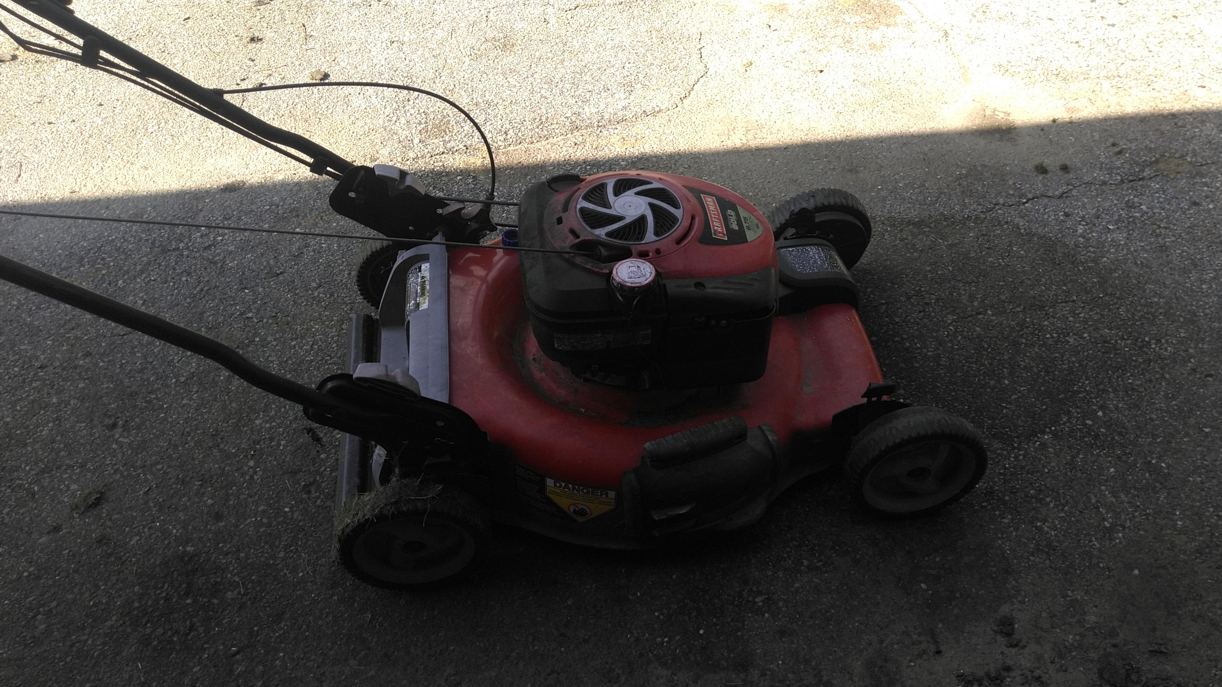

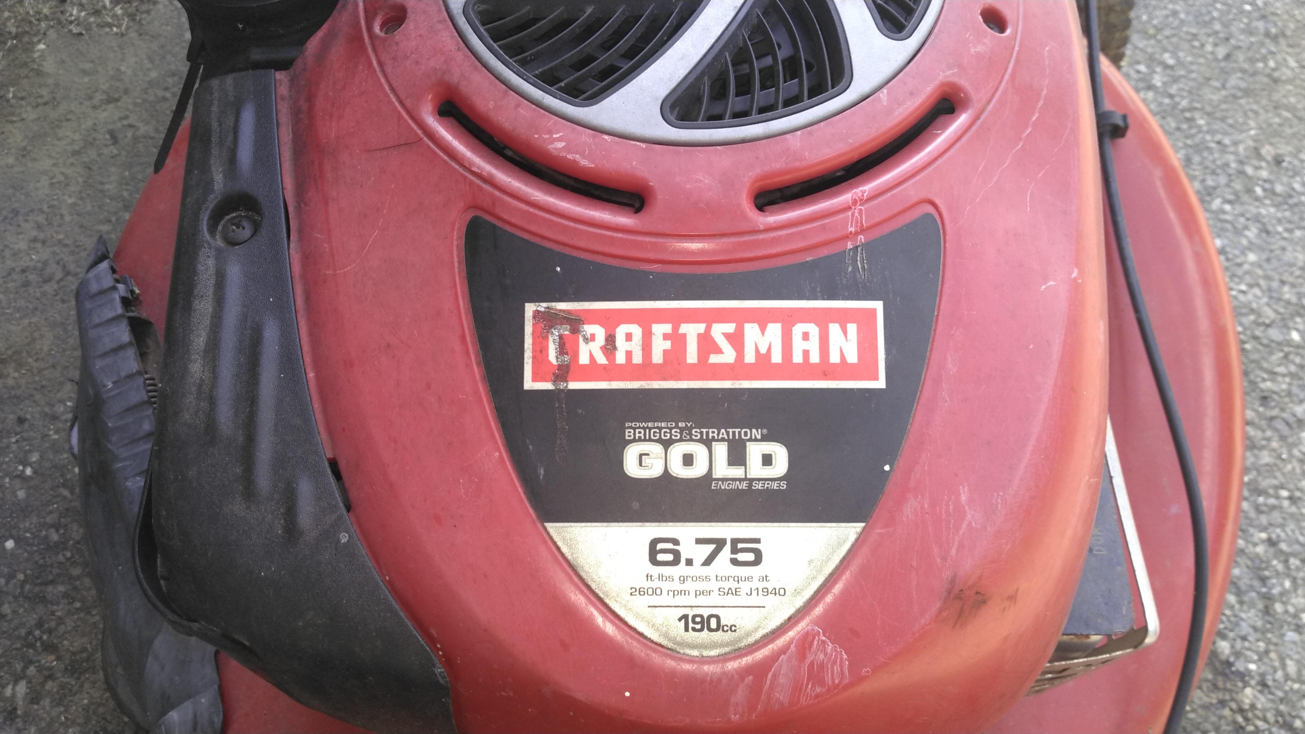

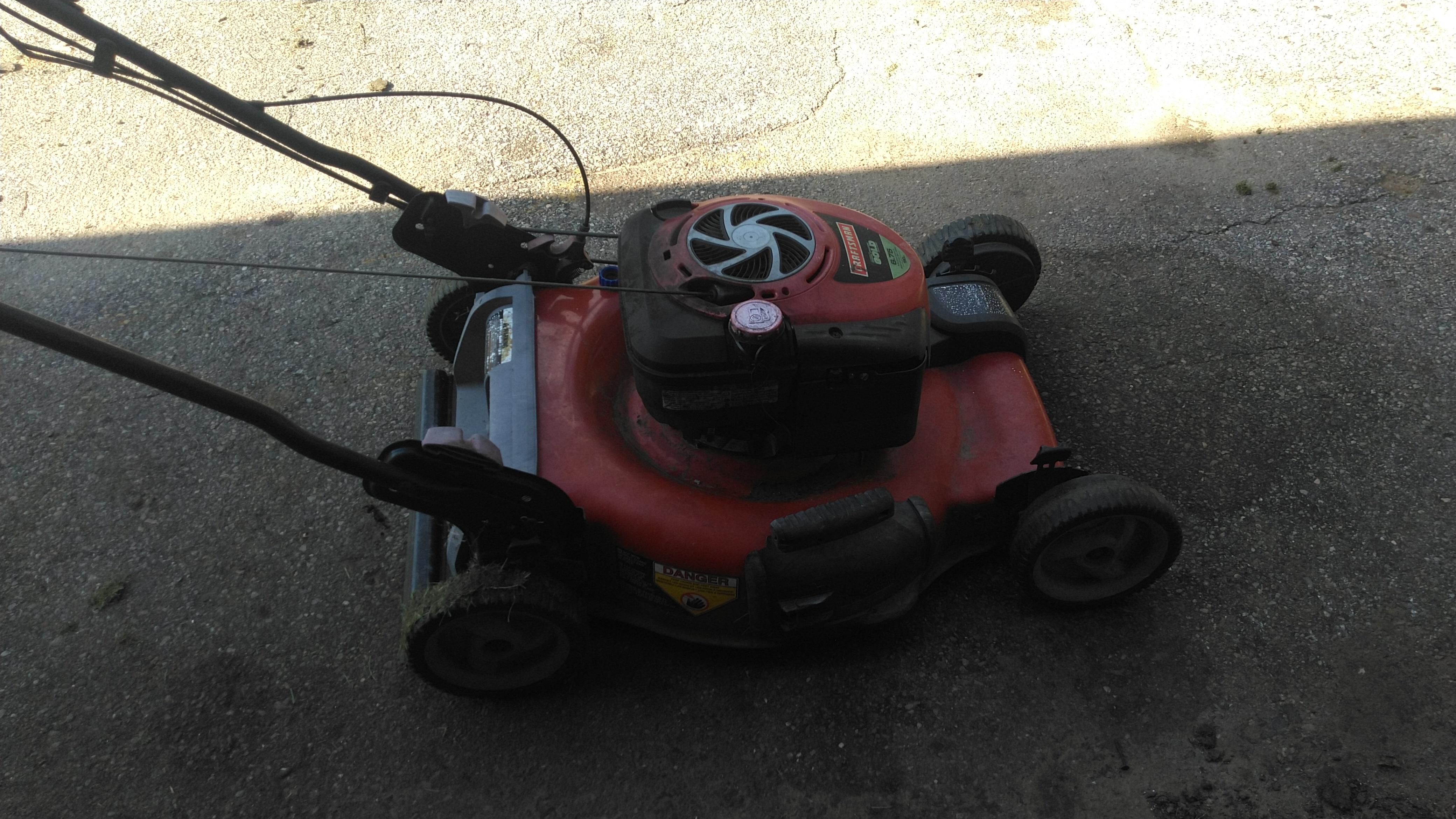

Finished up the free roadside find push mower. It got the missing air vane choke spring replaced, governor spring replaced and rpm adjustment. Changed the oil, plug and blew out the air filter. Removed the fuel valve to unkink the fuel line. Touched up the blade, scraped the deck and good to go.

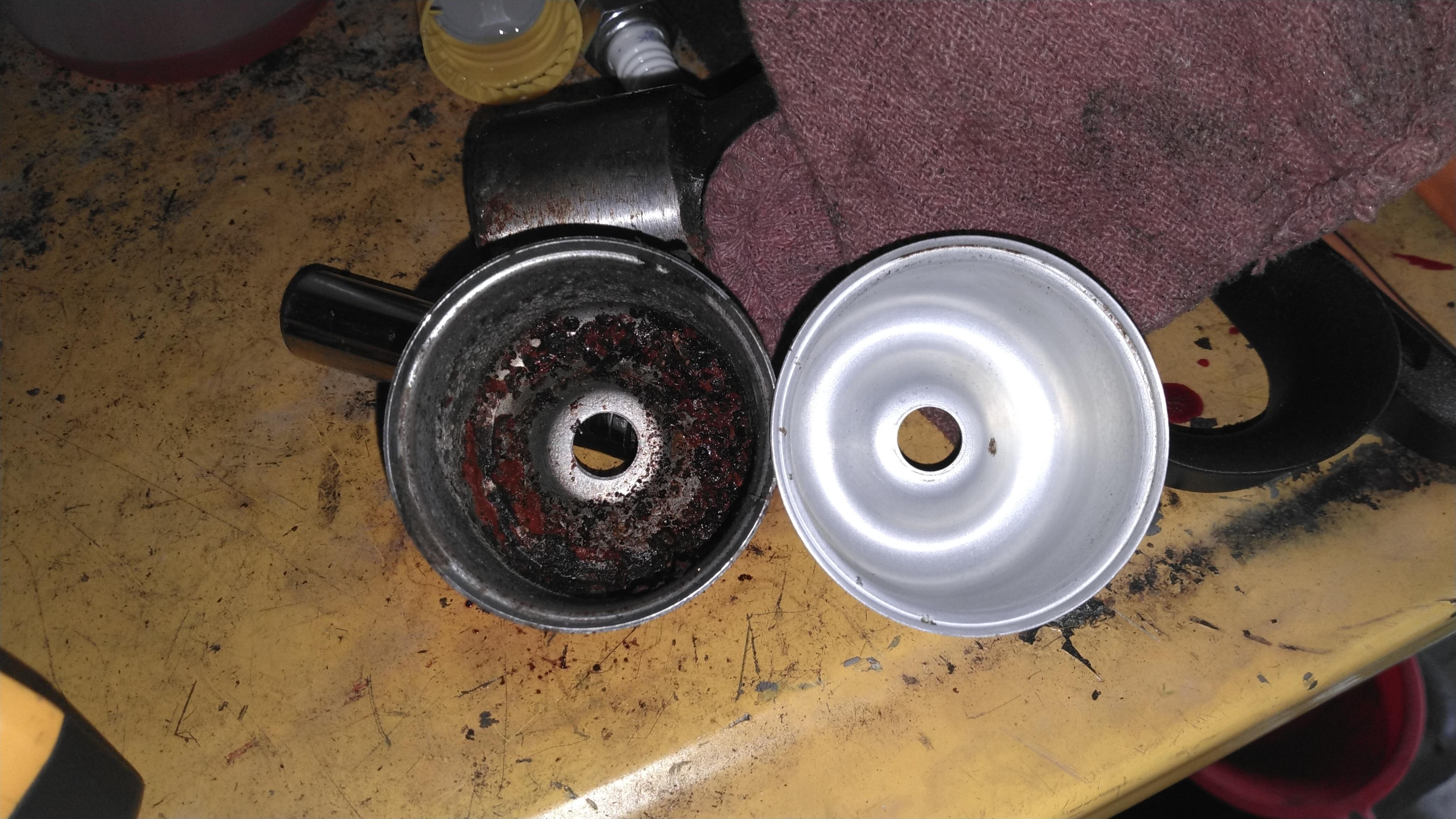

Thought I was done with the free roadside find mower. Turns out I wasn't! I'm surprised how well it actually ran.... Replaced the bowl and bowl nut/main jet with one off a mower that I had in the junk pile. Runs great now.
