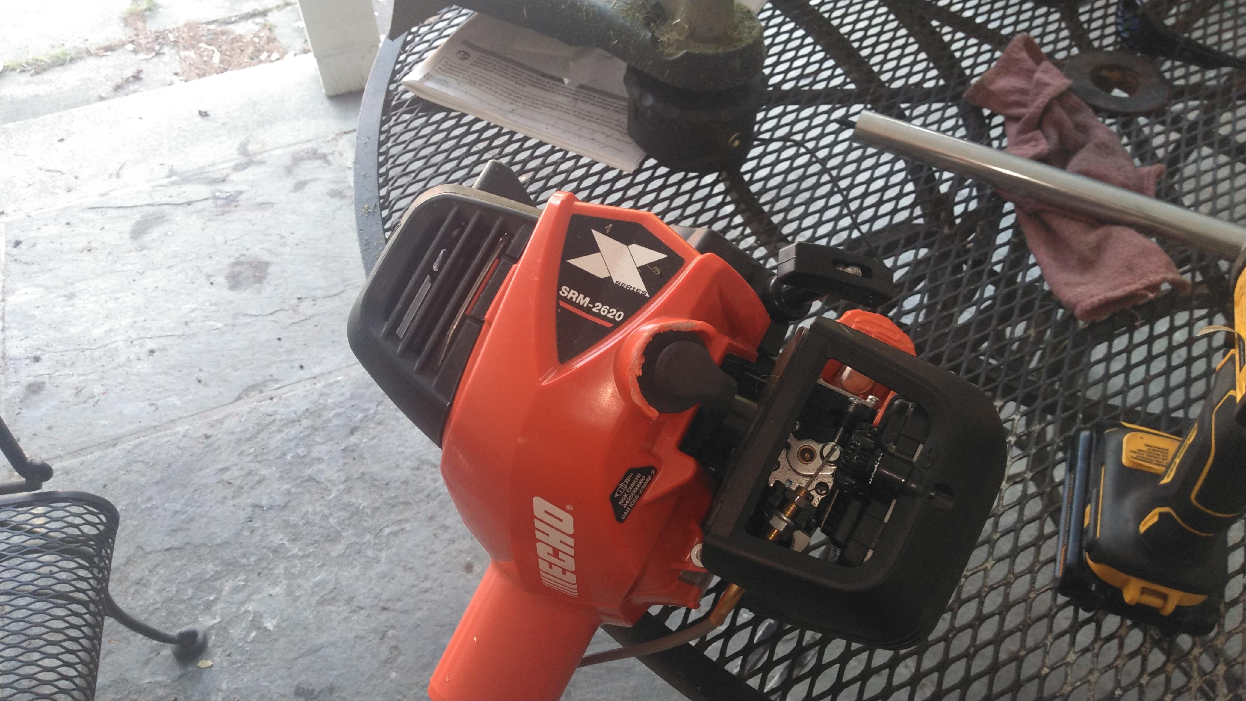

It was spotless. Compression is good also. I think the fuel line must have a pin hole, the primer bulb just dont pull like it is supposed to. This blower has the premade hoses.

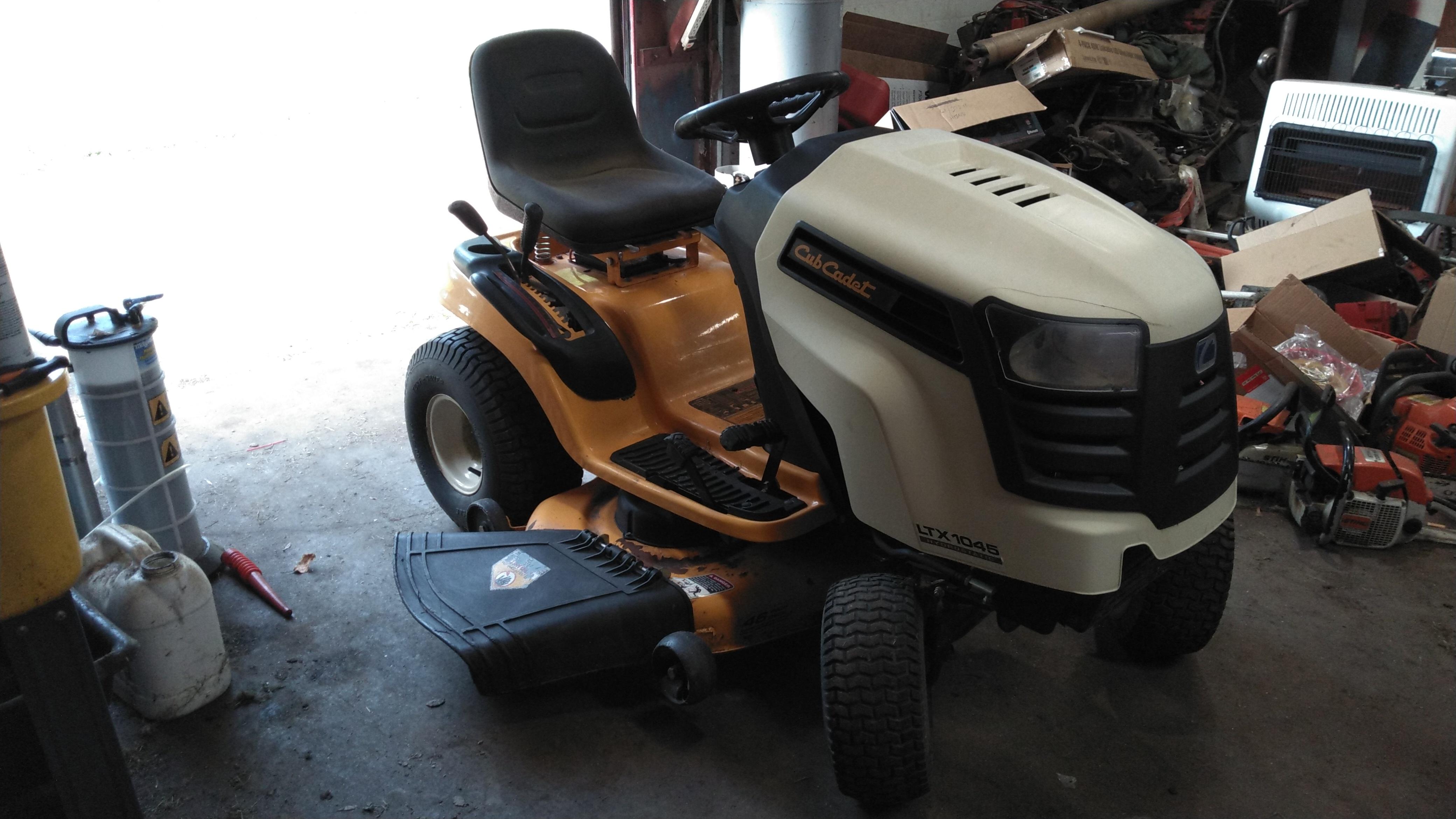

Got the Cub Cadet rider pretty much all done. Just need to button up a couple of minor things, get her bill all written up and deliver it back to her. Today I did the engine service, valve cover gasket, new carb, one spindle assembly, deck belt, and sharpen both blades.

Finished up the Cub Cadet rider. Just need to write up her bill and deliver it.

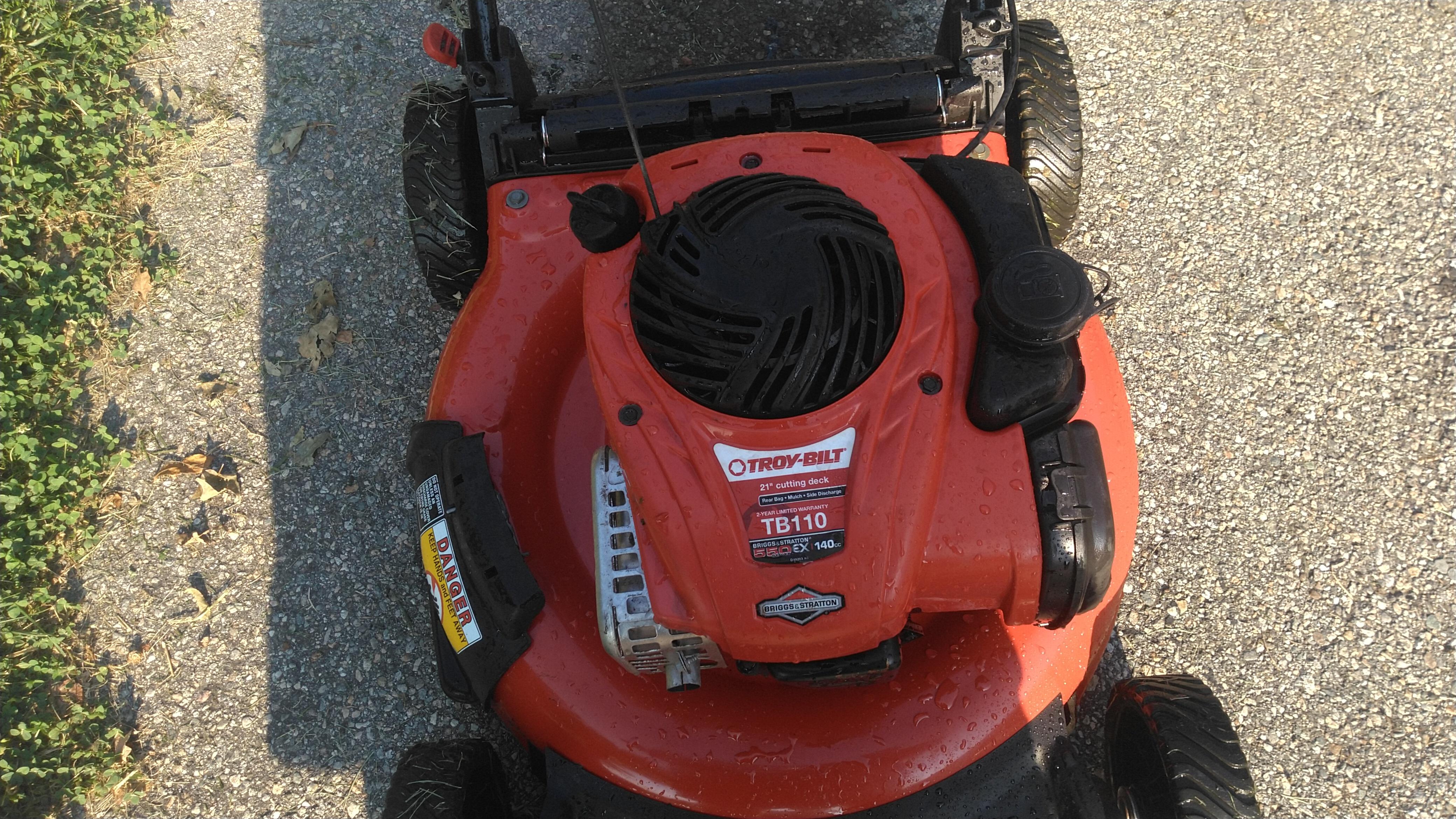

Got going on the Troy Bilt push mower the lady with the Husqvarna push mower gave me to look at. She only used it a couple times before hitting a small rock with it. Partially sheared the tits on the blade adapter and messed up the corresponding holes on the blade. Got the new blade and blade adapter installed and fired on a shot of brake cleaner. Carb will be done in an hour and it'll be running tomorrow evening after work. Oil looks like new, plug looked like new and air filter just needed blown out.

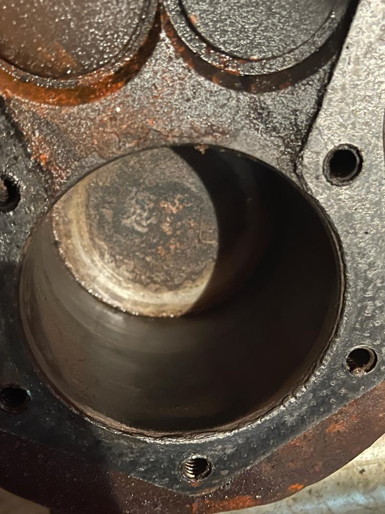

Supposedly this old Kohler magnum engine was in running shape. Obviously not! Shockingly the cylinders are going to clean up. So rebuild parts have been ordered
Yeah it probably just needs a fuel filter and it'll be tip top....
Lol
