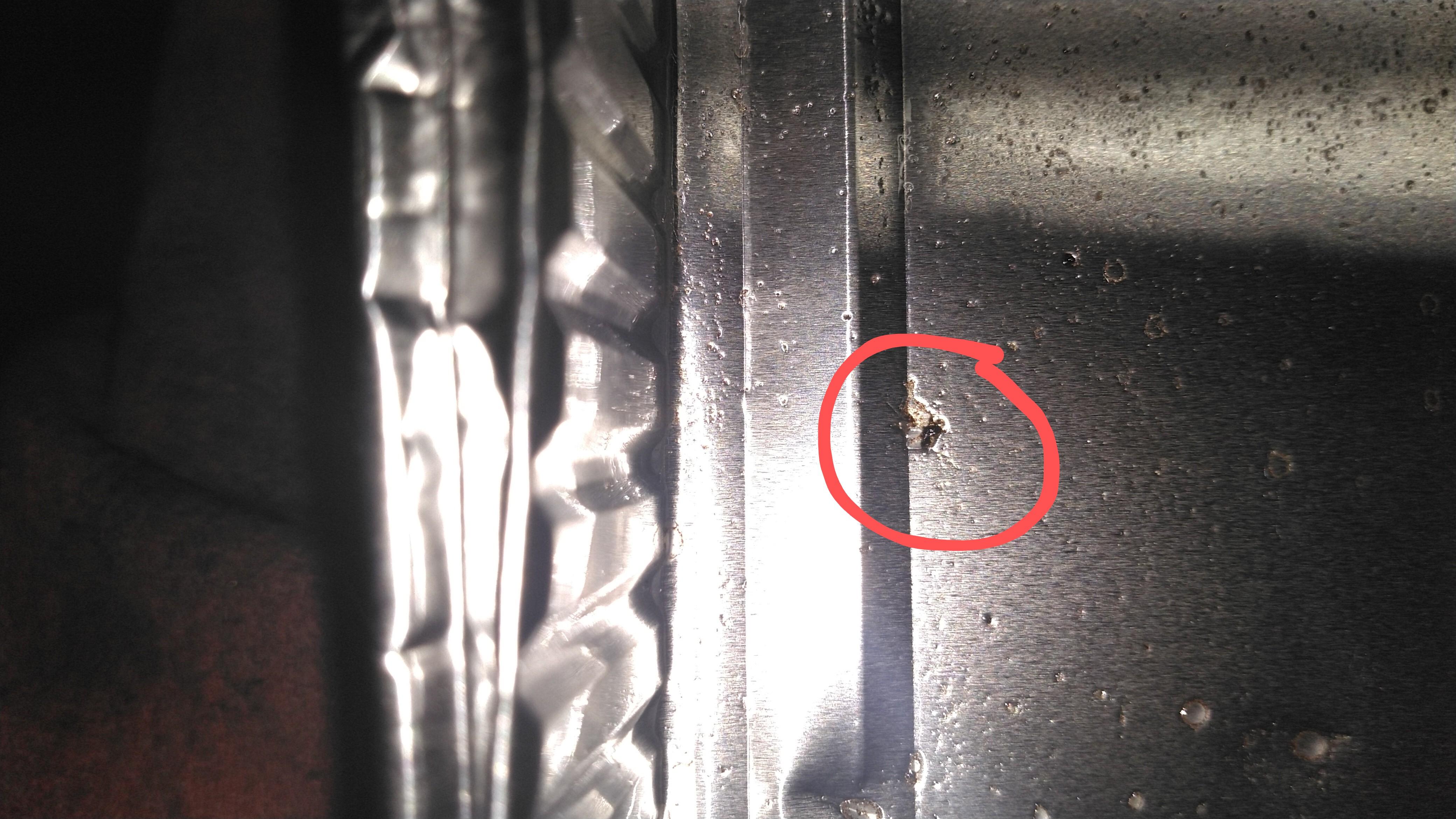

Since the motor and trans were put in I had to add coolant. Found what I thought was a bad freeze plug. Replaced it with no change in coolant consumption so it just got the be a check once a week thing. Come to find out it was a crack in the head between exhaust ports that they missed. Then I got it all back together after the machinist had checked them over, not realizing where the crack was and it still leaked coolant! I happened to catch it while warming it up. On initial tear down I found one head bolt finger tight with evidence it had been blowing compression out of the #6!cylinder from the get go. Along with the fasteners noted in the trans I don’t know that I ever will have a good thing to say about them.
If it weren’t for sorry luck with buying motorized things I would have none at all. It seems unless something is put together by a select few people or yourself these days there isn’t much hope that it has been assembled and torqued as it should be.
