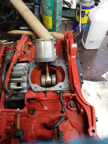

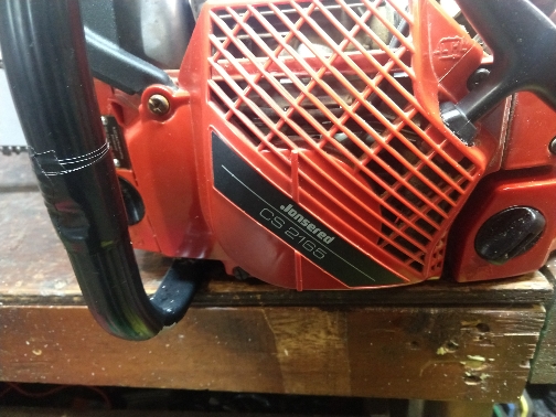

Adding a ported cylinder onto this nice 2165.

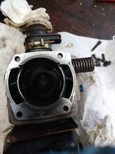

I got a 2149 I played in those removable transfer covers. I like that saw a lot it really likes the 357xp intake and big azz muffler.
Sent from my moto x4 using Tapatalk
This cylinder has lots of built in restrictions. Lol main one is the chrome not going all the way to the squish band and you can’t machine much out of them unless you want to snag a ring on that lip. But overall it runs good and good practice. I much rather start with a 346 cylinder over this one and not play catch-up but that would take the fun out of it right? Lol

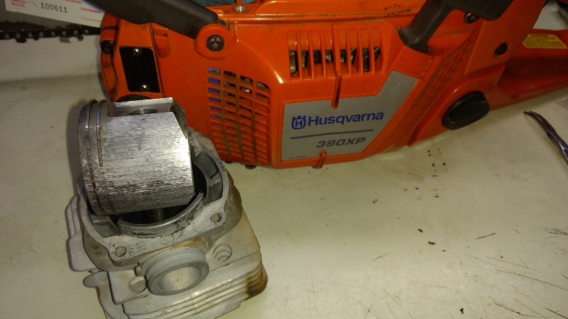

Installed a new top end on a 390 xtra pee with only a few minutes of run time on it...
50/50 mix of water and fuel found in the tank.
