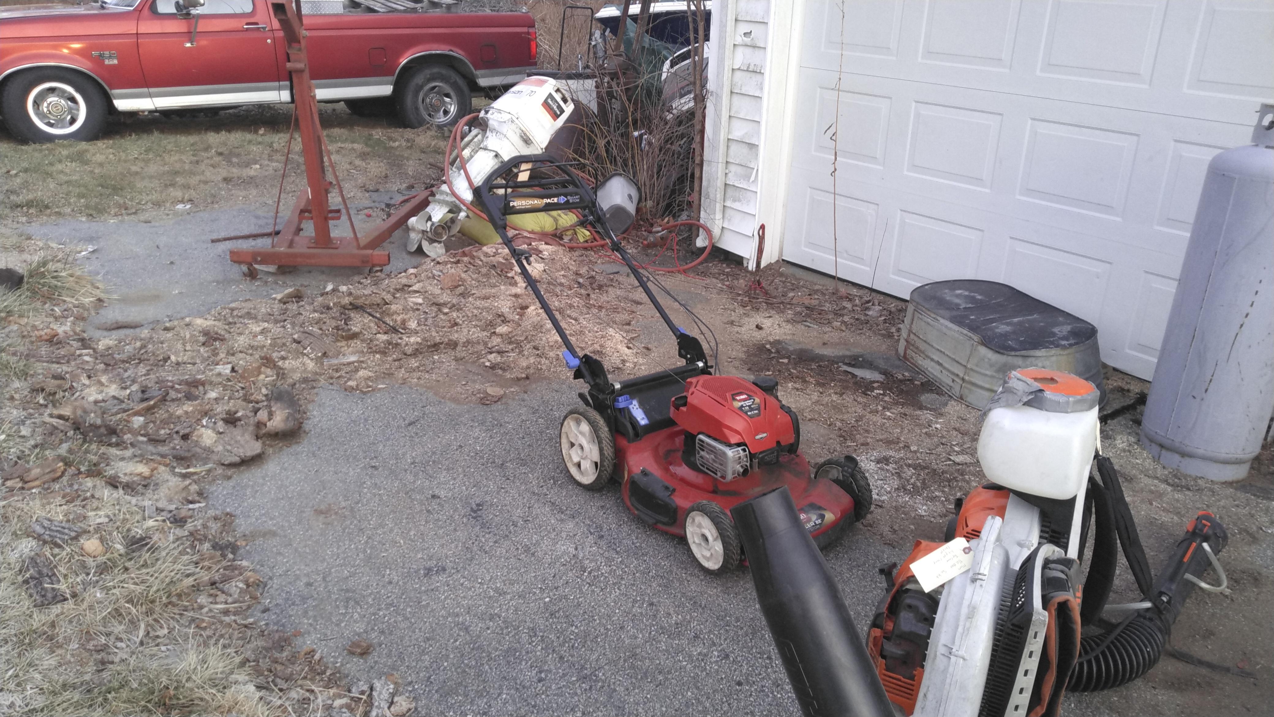

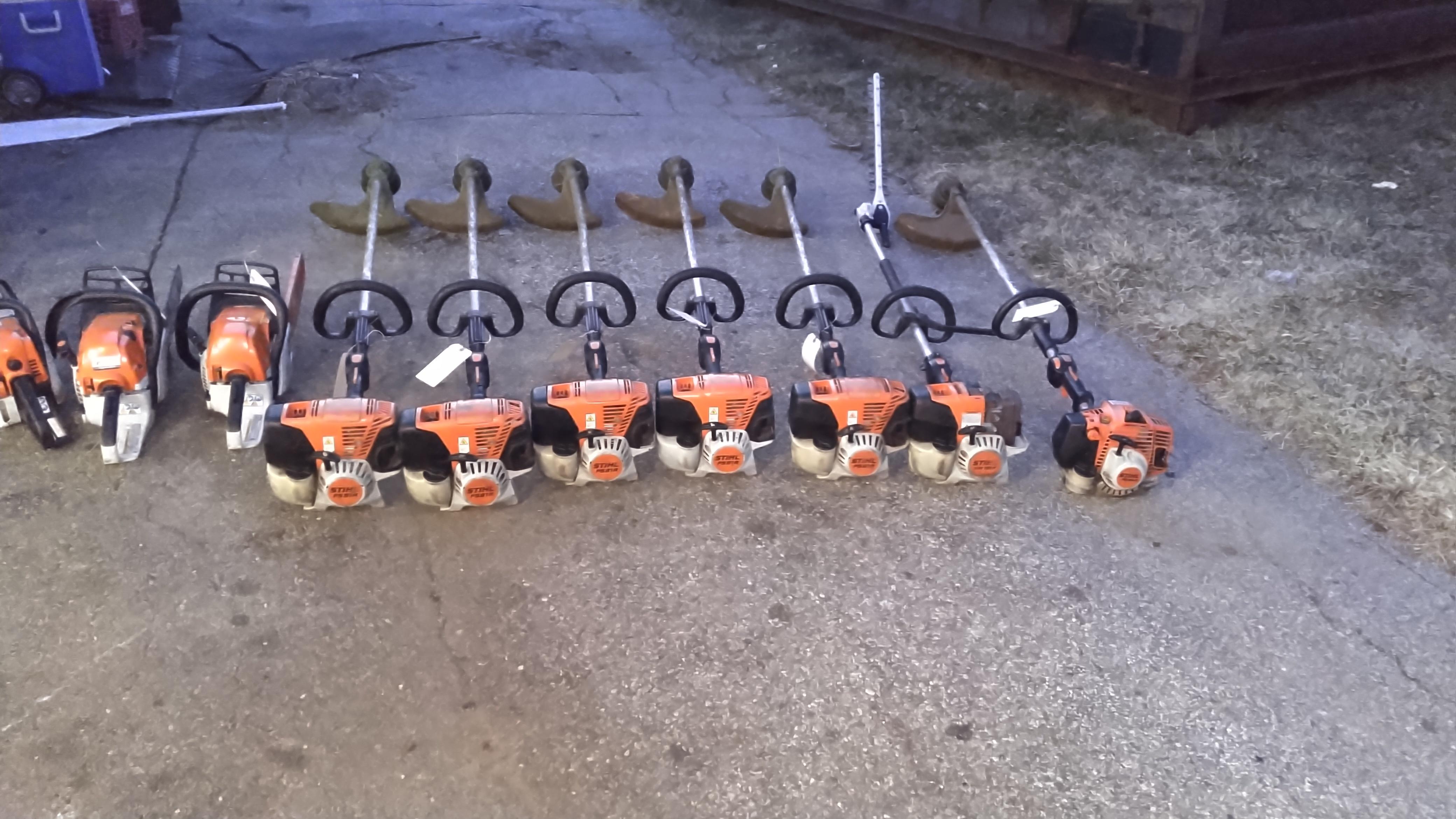

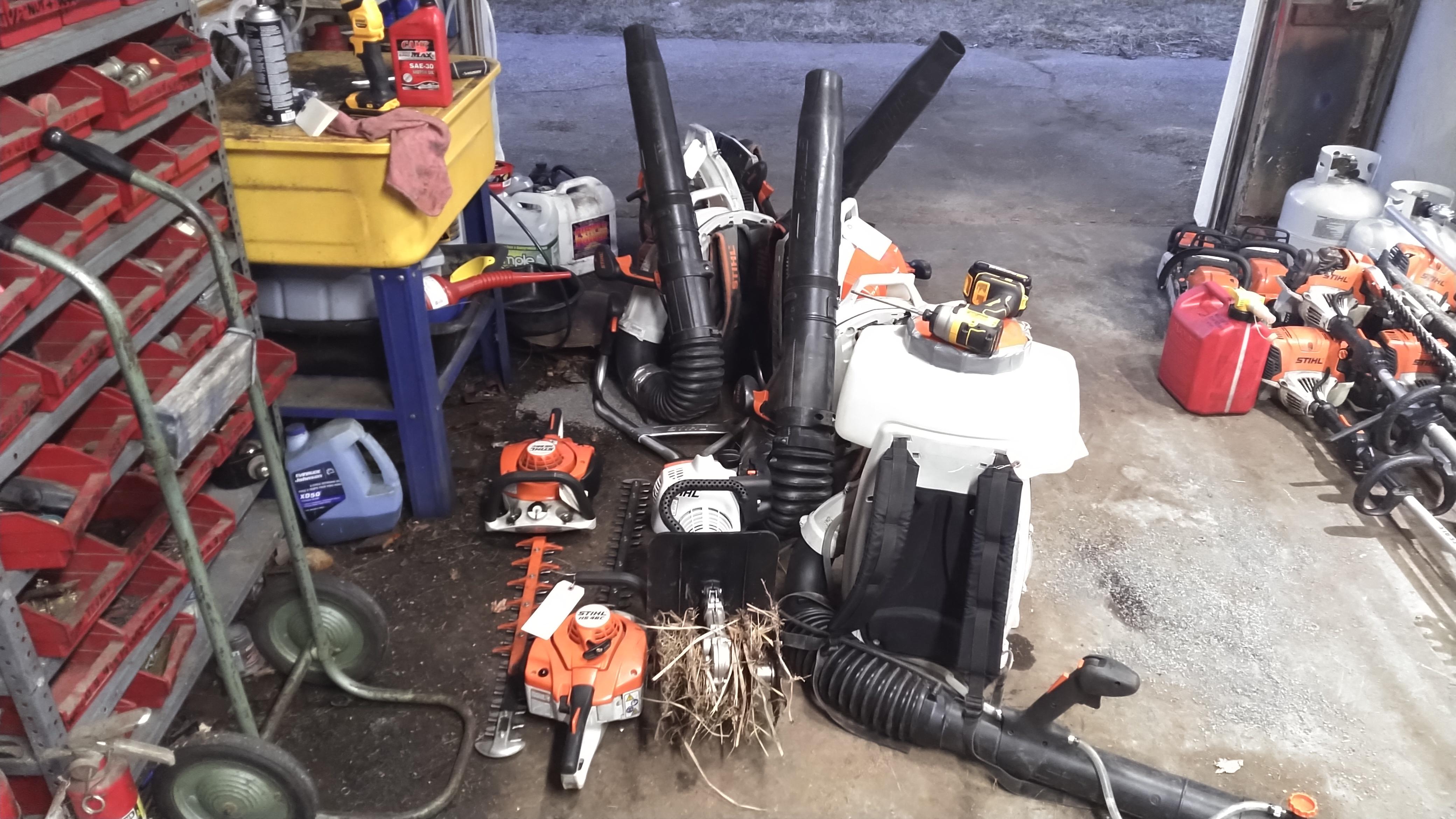

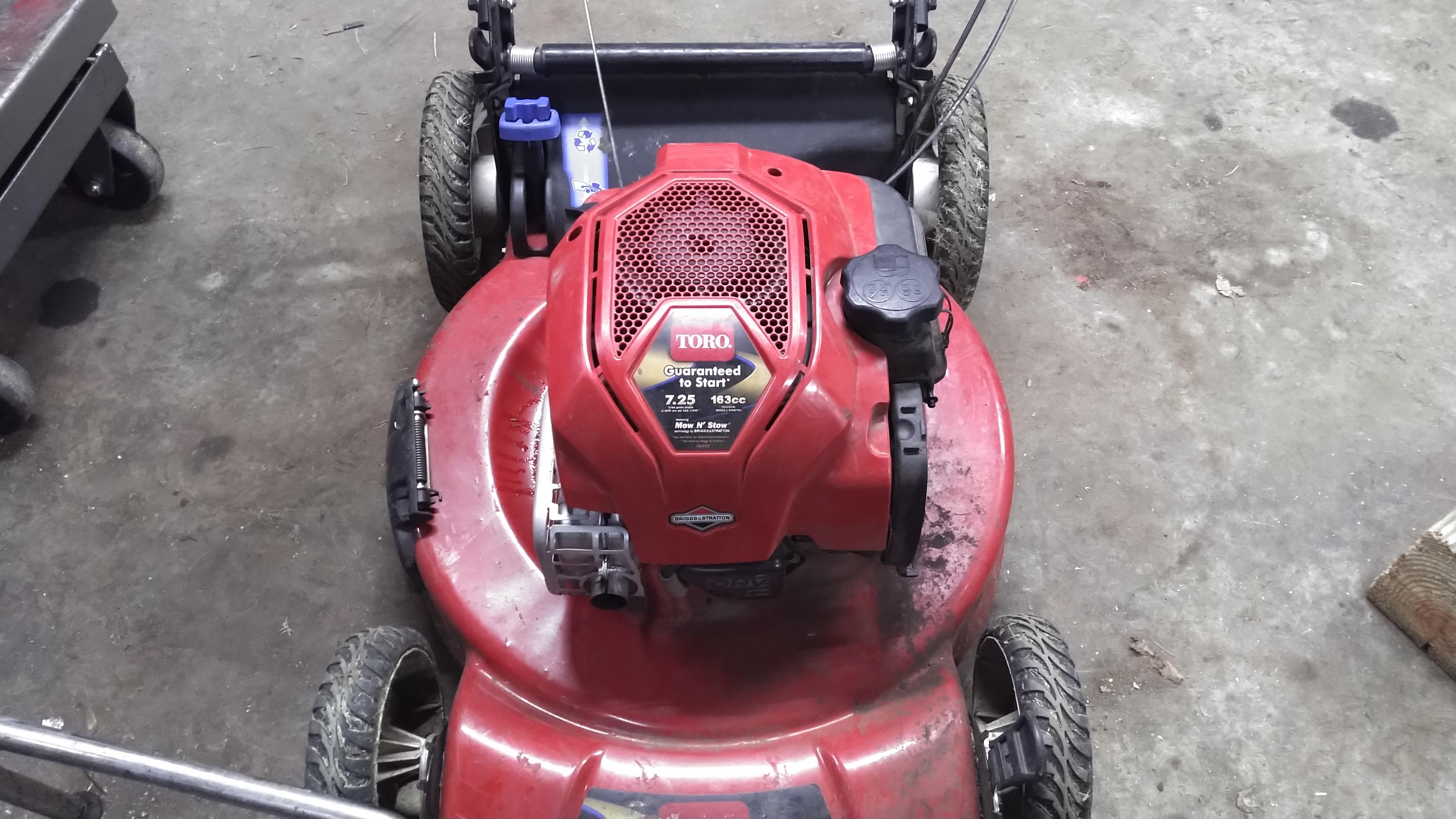

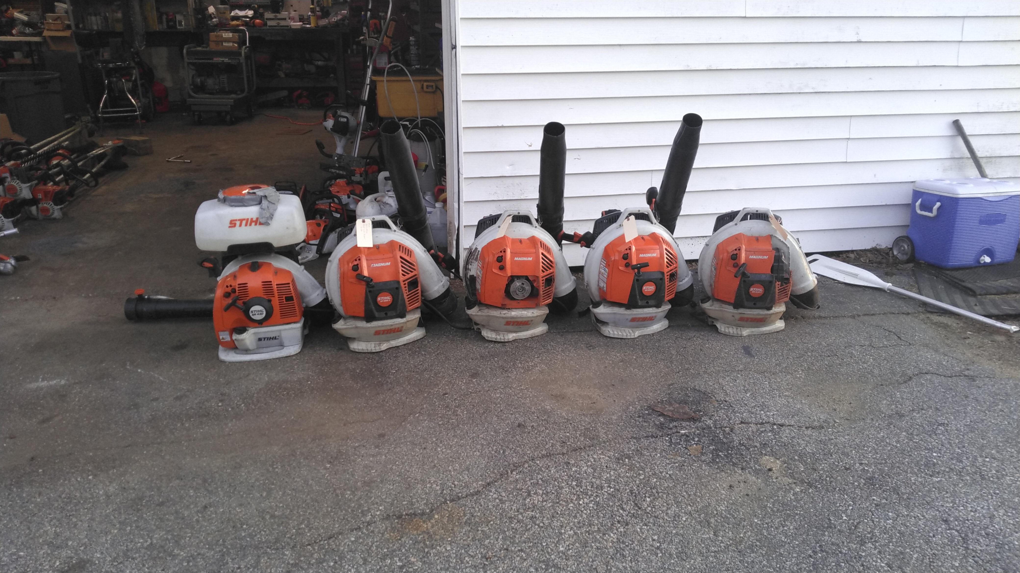

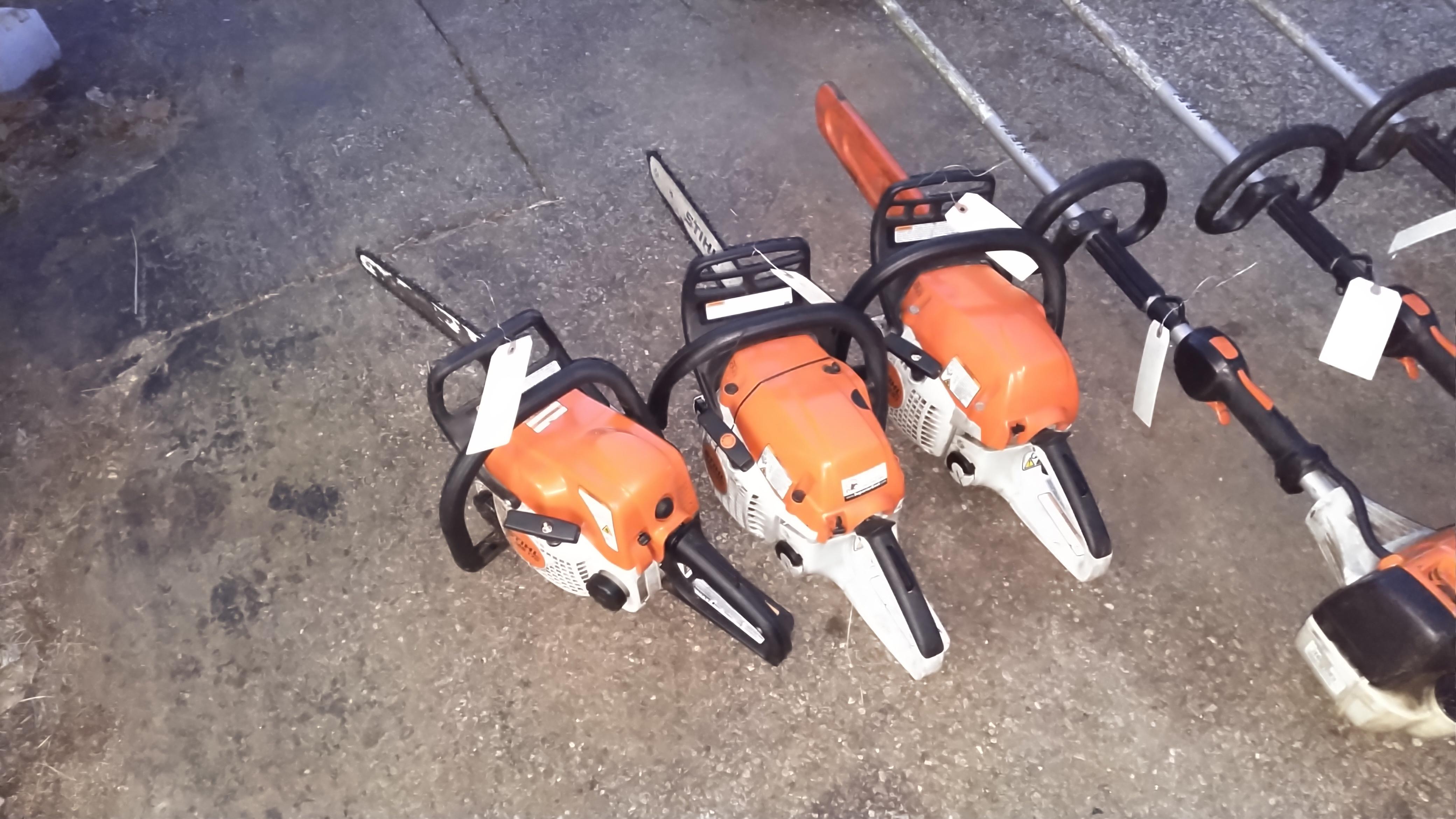

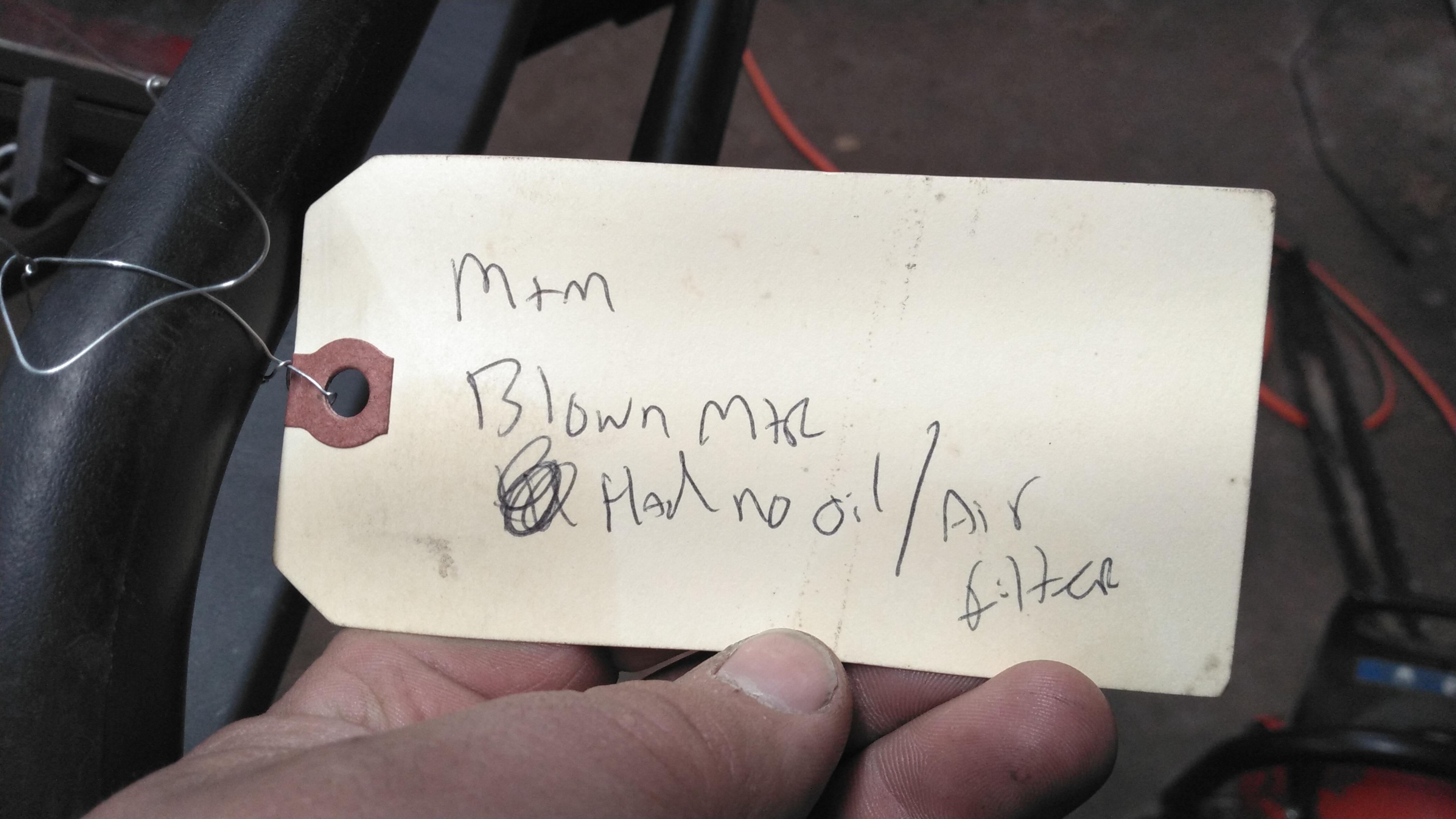

Getting started on the pile of commercial equipment that was dropped off last night for service/repair. Checked out 4 blowers, 2 hedge trimmers, 1 tiller, 1 sprayer and a push mower. The only piece DOA so far is the push mower. There was nothing but grey sludge on the dipstick and it's missing the air filter and cover. Got it to run for a few seconds and she's knocking pretty good. Not worth spending any more time on in my opinion. Going to look at the pile of trimmers, chainsaws, and kombi units tomorrow evening. Got a parts list started.

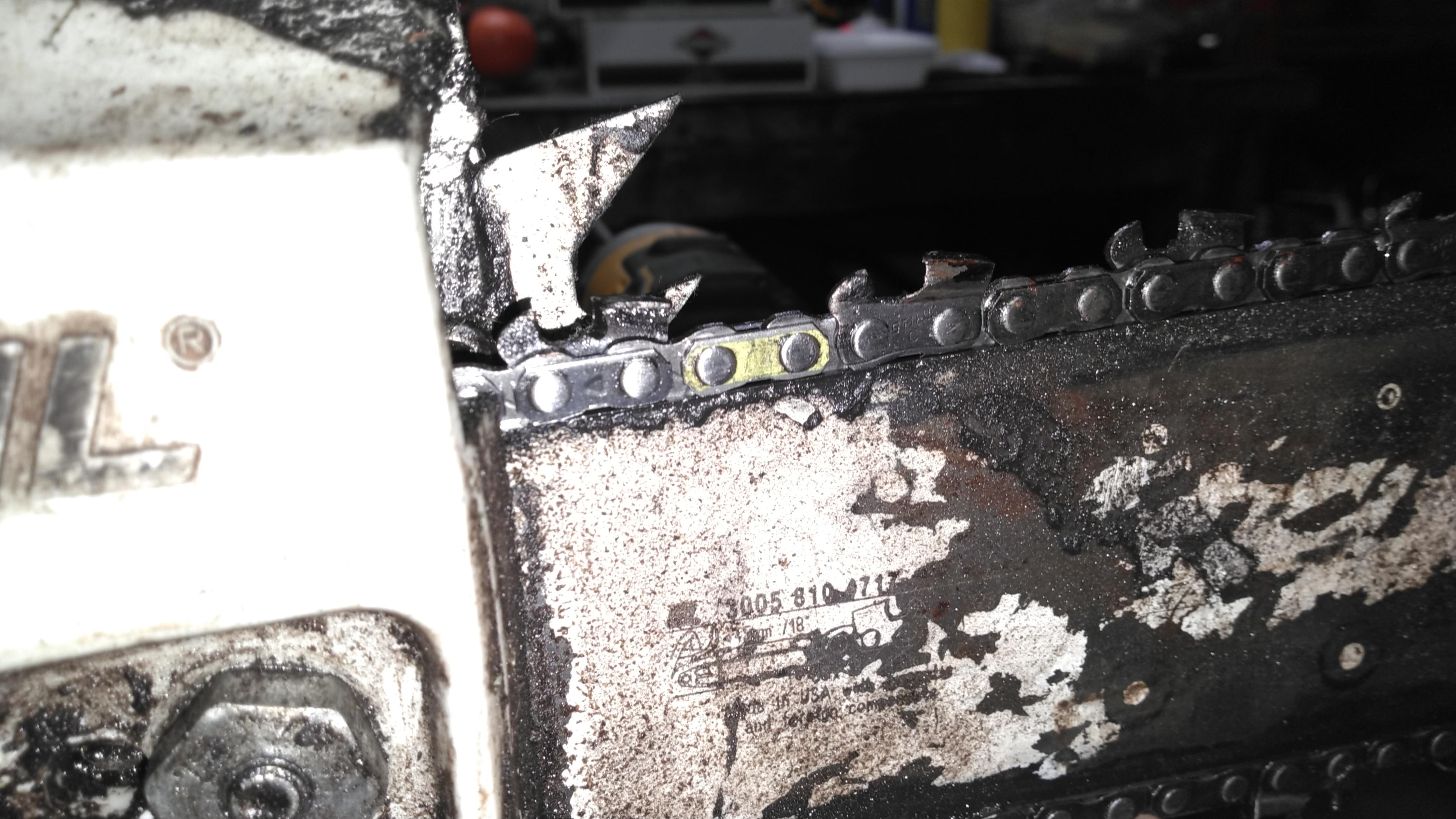

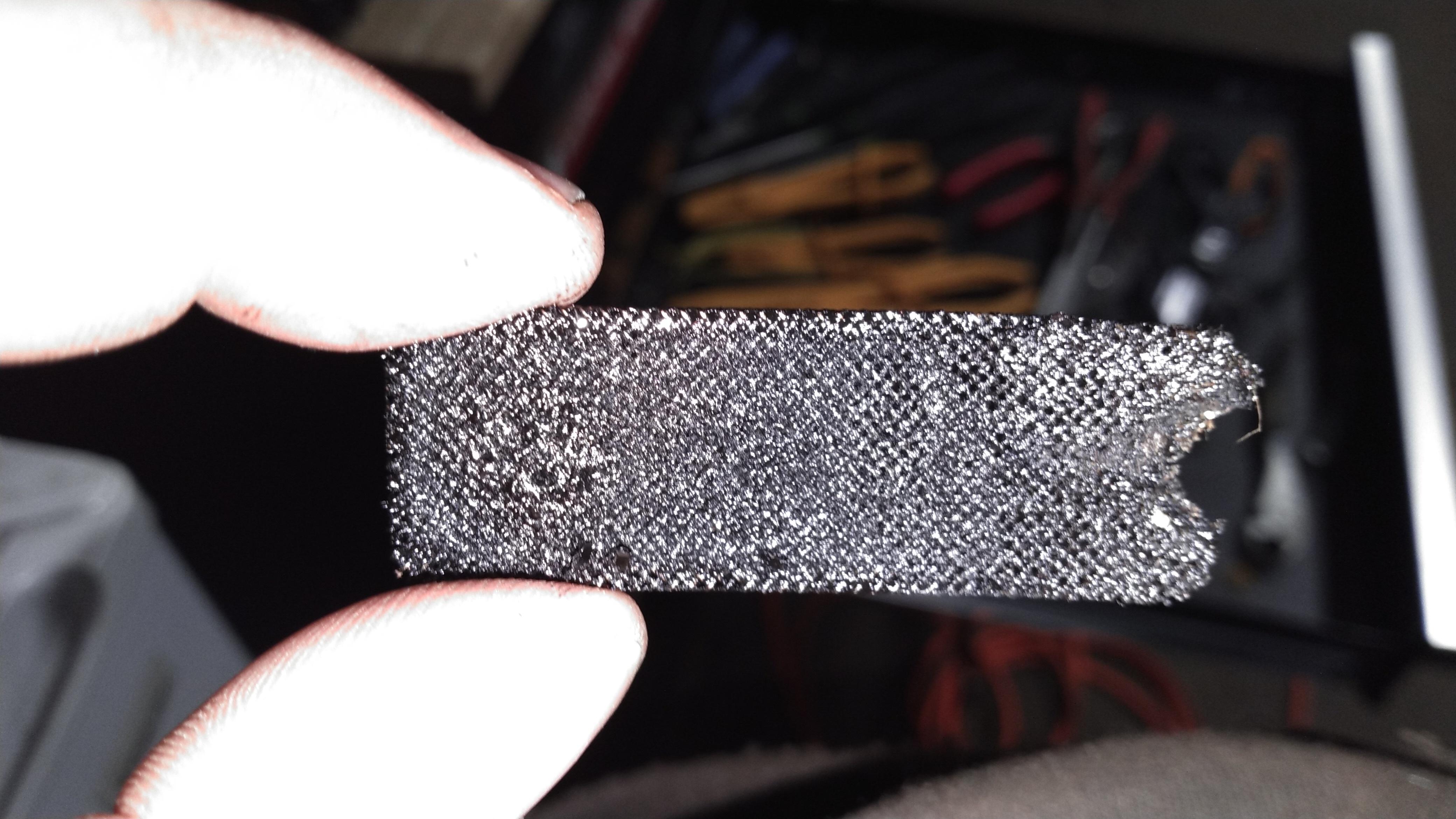

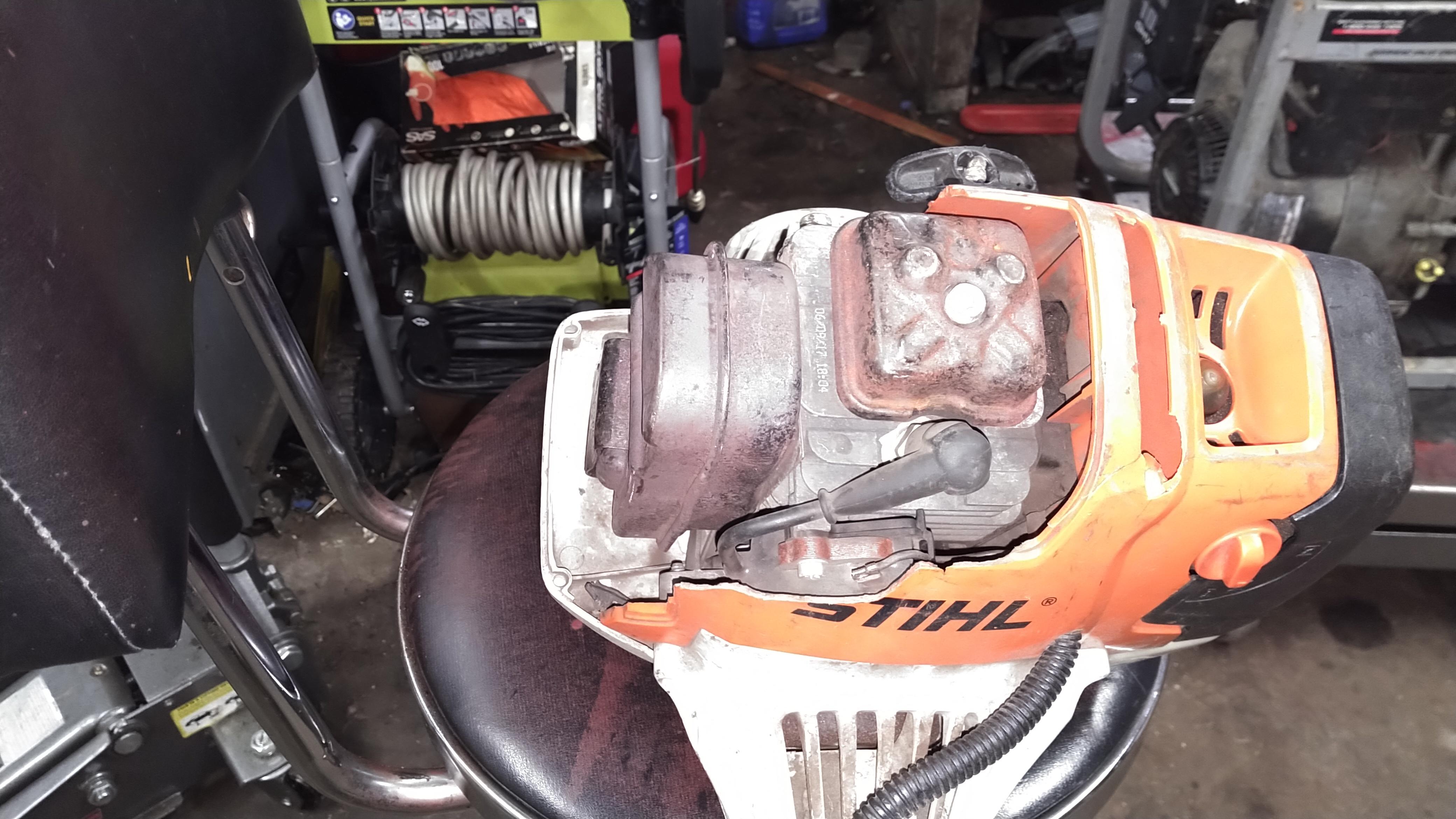

Checked out the rest of the stuff that was dropped off Monday. Also checked out a FS94 that wouldn't start, found a clogged spark arrestor screen. Also getting a service kit, spool for the trimmer head, plug cover and screw. Talked to the owner of the push mower and he's just going to buy a new one.

That chain pic says it all huh Will.

I picked up a saw once that the chain was so badly rocked and beaten that it actually cut better when installed backwards!!
Which still was really bad!!!!
Although still slightly better than proper orientation!
Wish I still had a picture.
