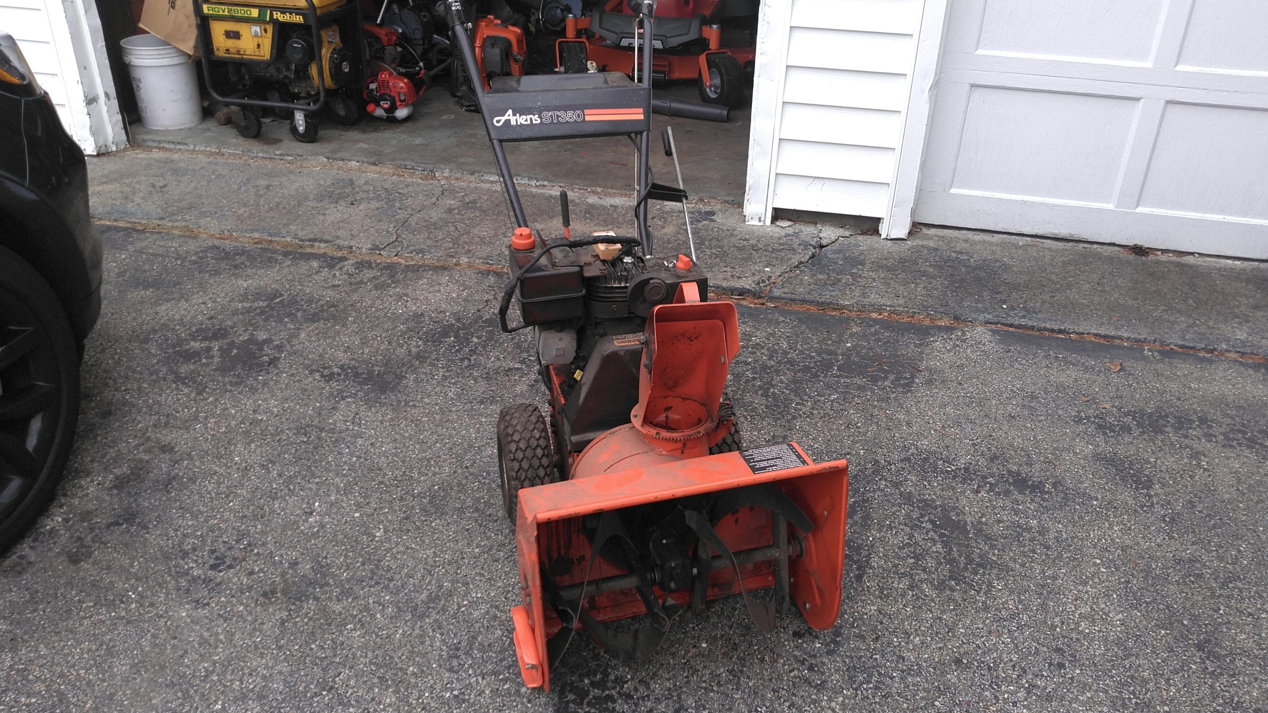

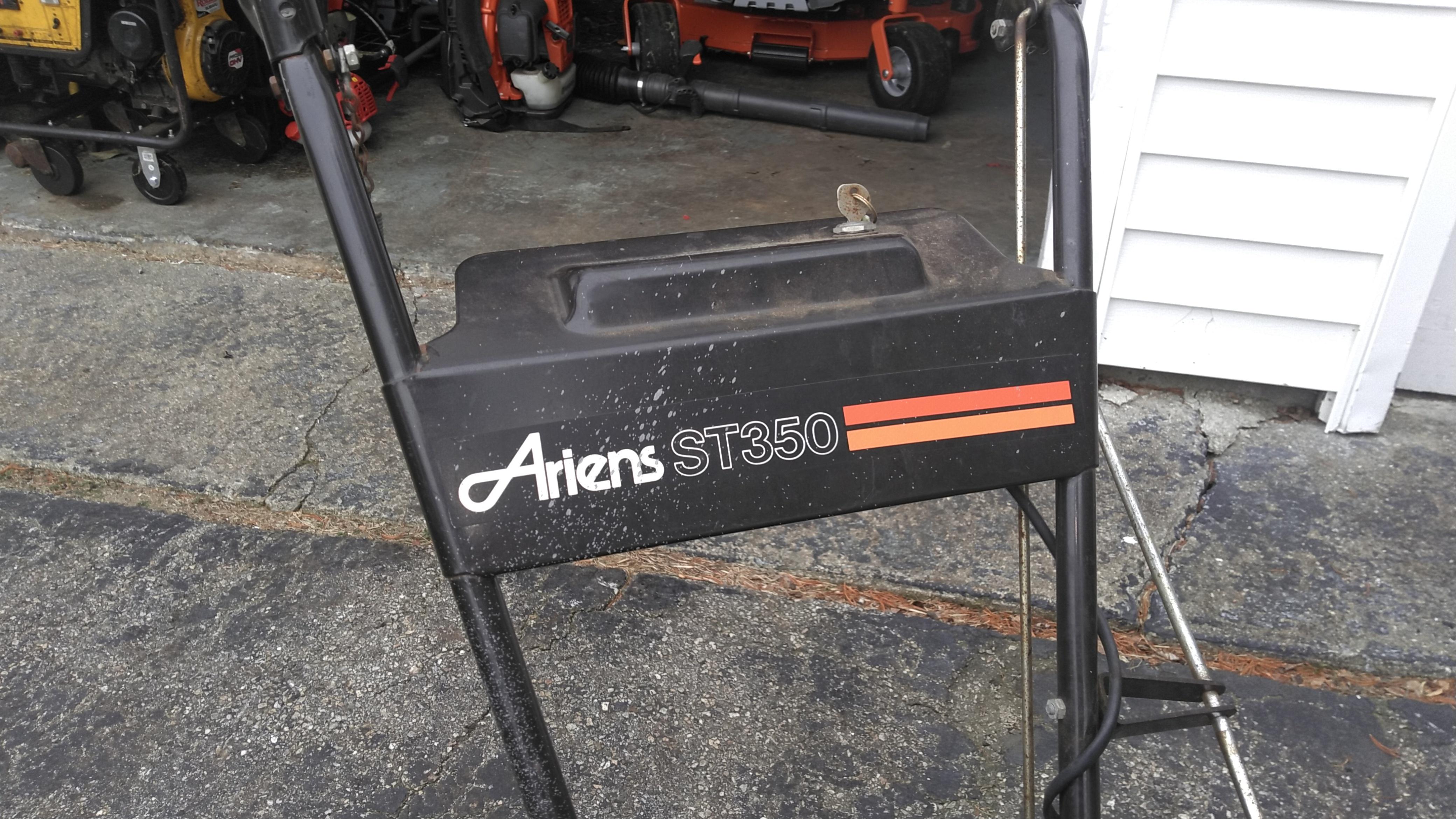

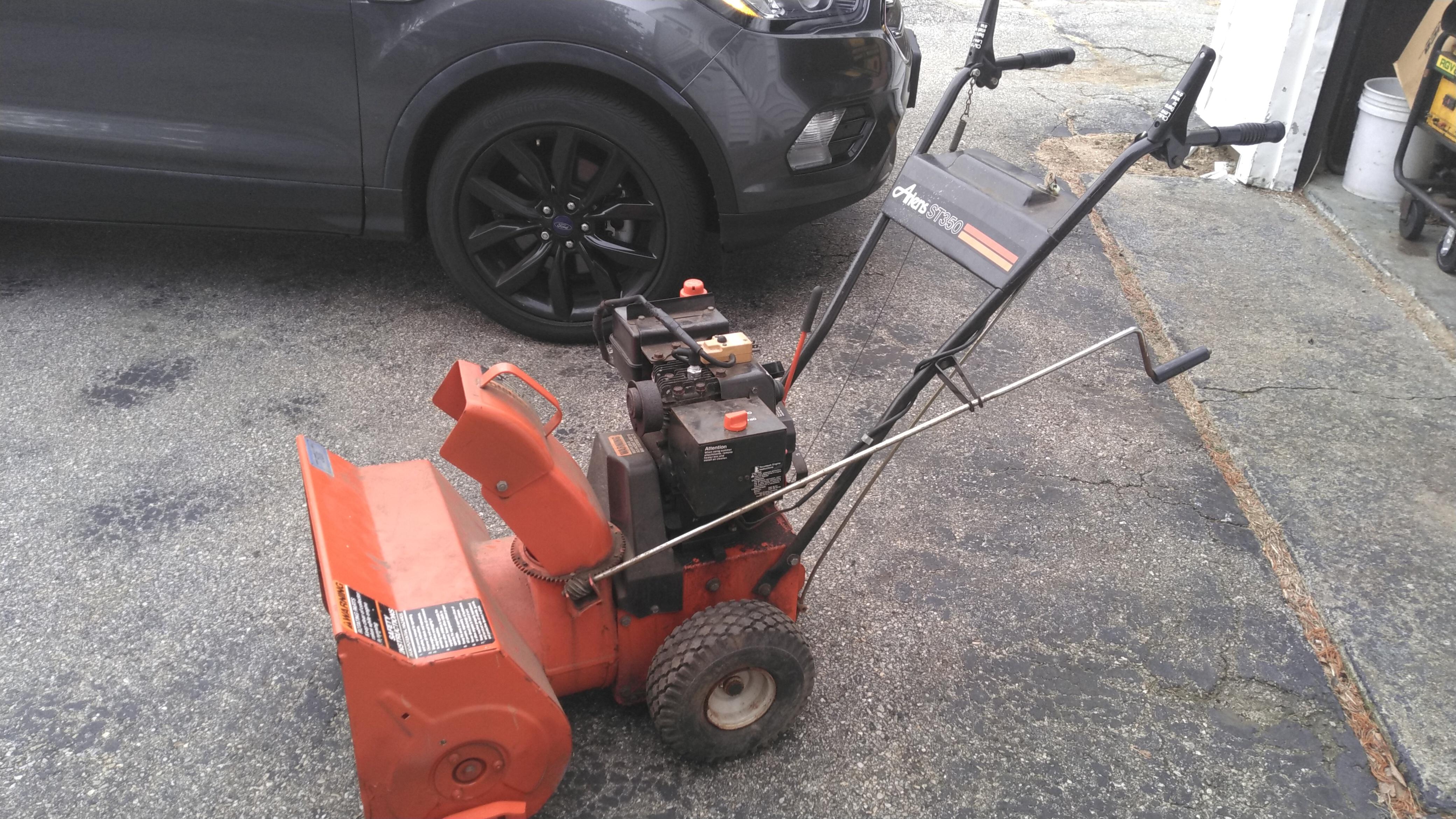

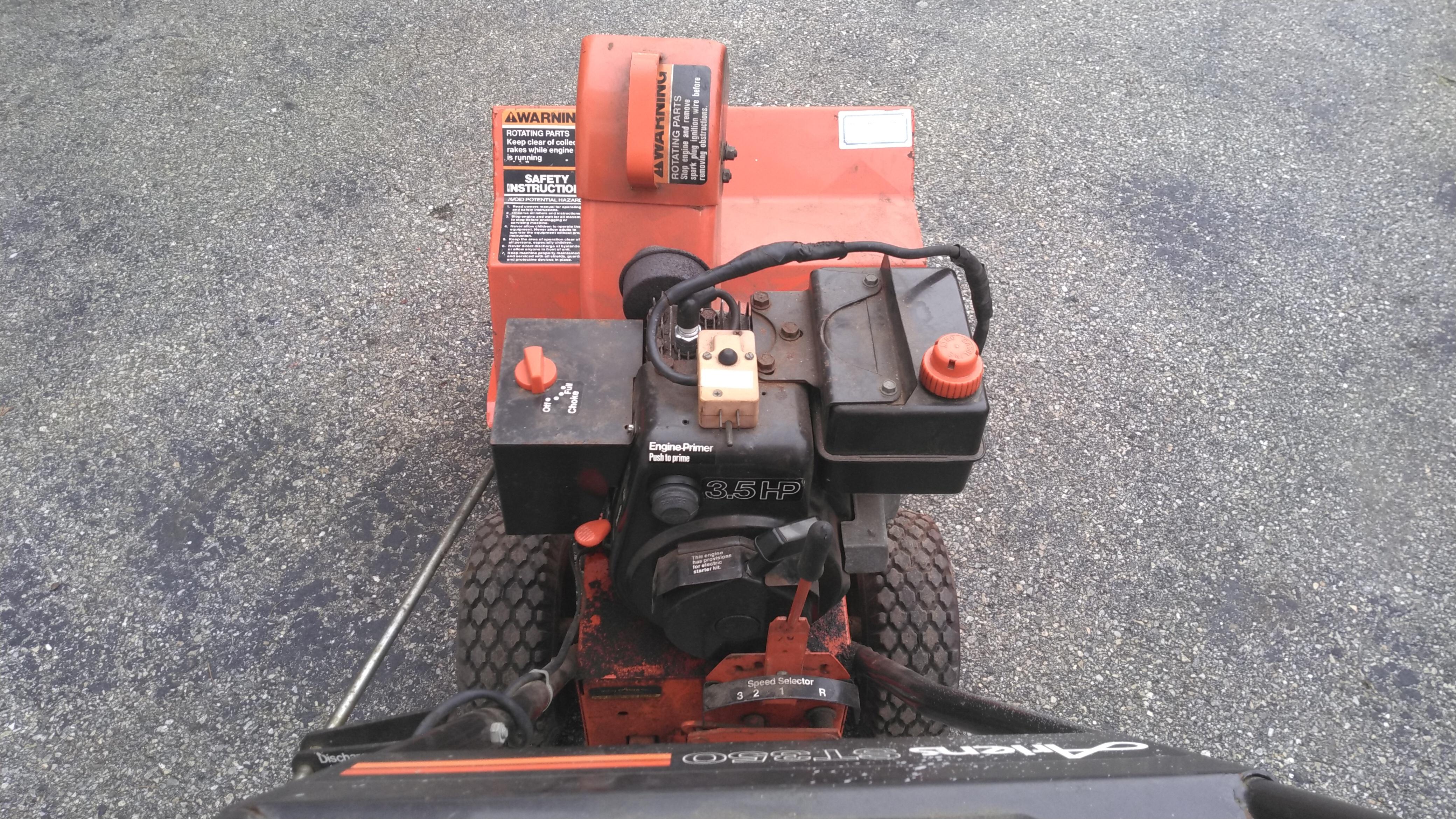

Still no results from my rona test yet so I finished another snowblower. New primer and primer hose installed. Test ran for a while and ran great. Had to bump up the idle speed just a tad but it was no big deal.
I should have the air filter and pre filter for his generator tomorrow or Saturday. Hopefully I'll have him pickup Sunday morning.
Tossed together a quick video highlighting 2 recent snowblower repairs as well.

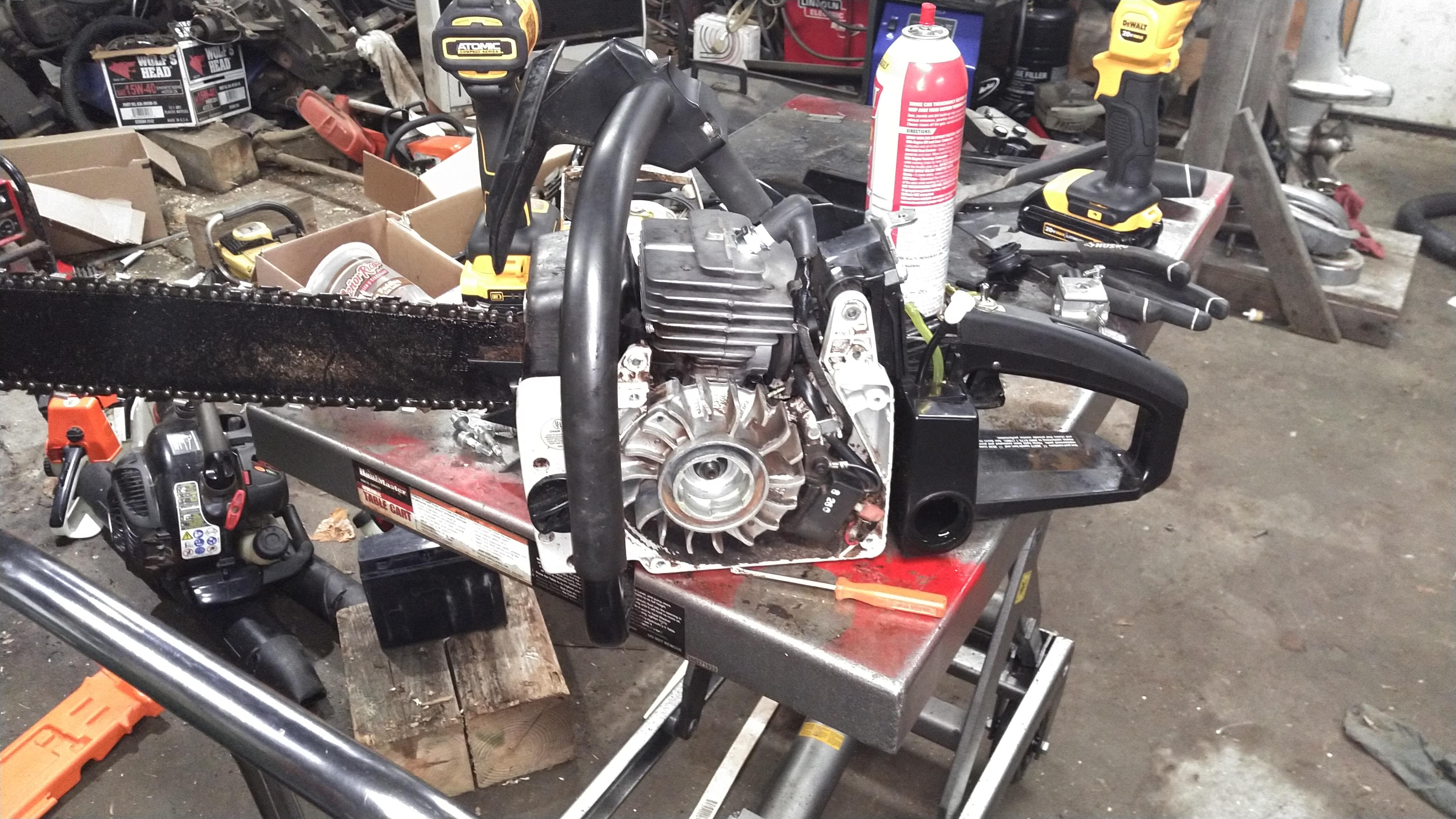

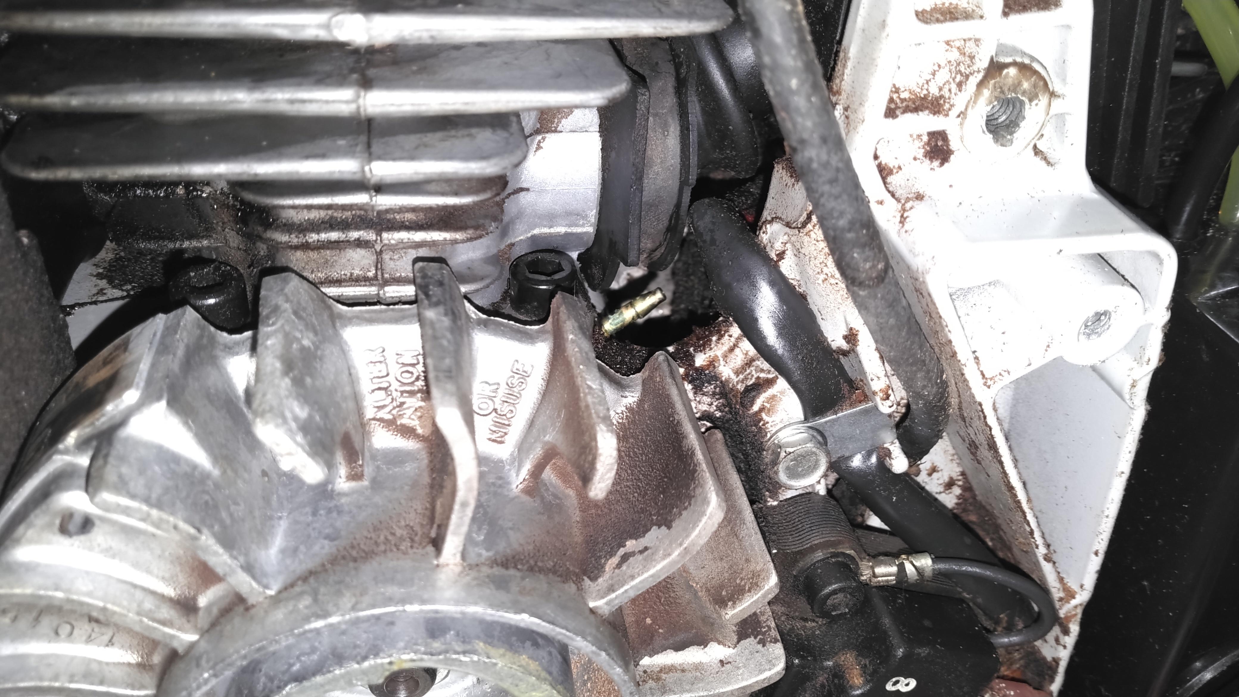

Finally solved the mystery of my buddy's Craftsman/Poulan. It would only run for a minute or two then stall. Everything checked out okay. Decided to put my eyes on it again today and was very surprised with what I found, surprised that it even ran at all. Tank vent was plumbed to the impulse port on the carb and the impulse hose was rotted off the crankcase nipple. Installed a new tank vent fitting and I'm going to make a new impulse hose. Cylinder and piston are fine as I pulled the muffler to look at the piston like I normally do.
