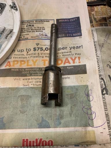

I made a drive adapter for the dog type starter (Homie, Lombard, Poulan, McCulloch etc.).
I should invent one for Stihl if only to verify oil pump function. [emoji848]
Tip: Don’t use it to actually start a powerhead you’ve chucked in the bench vice. The vibrations will send top contents to the floor. [emoji23]

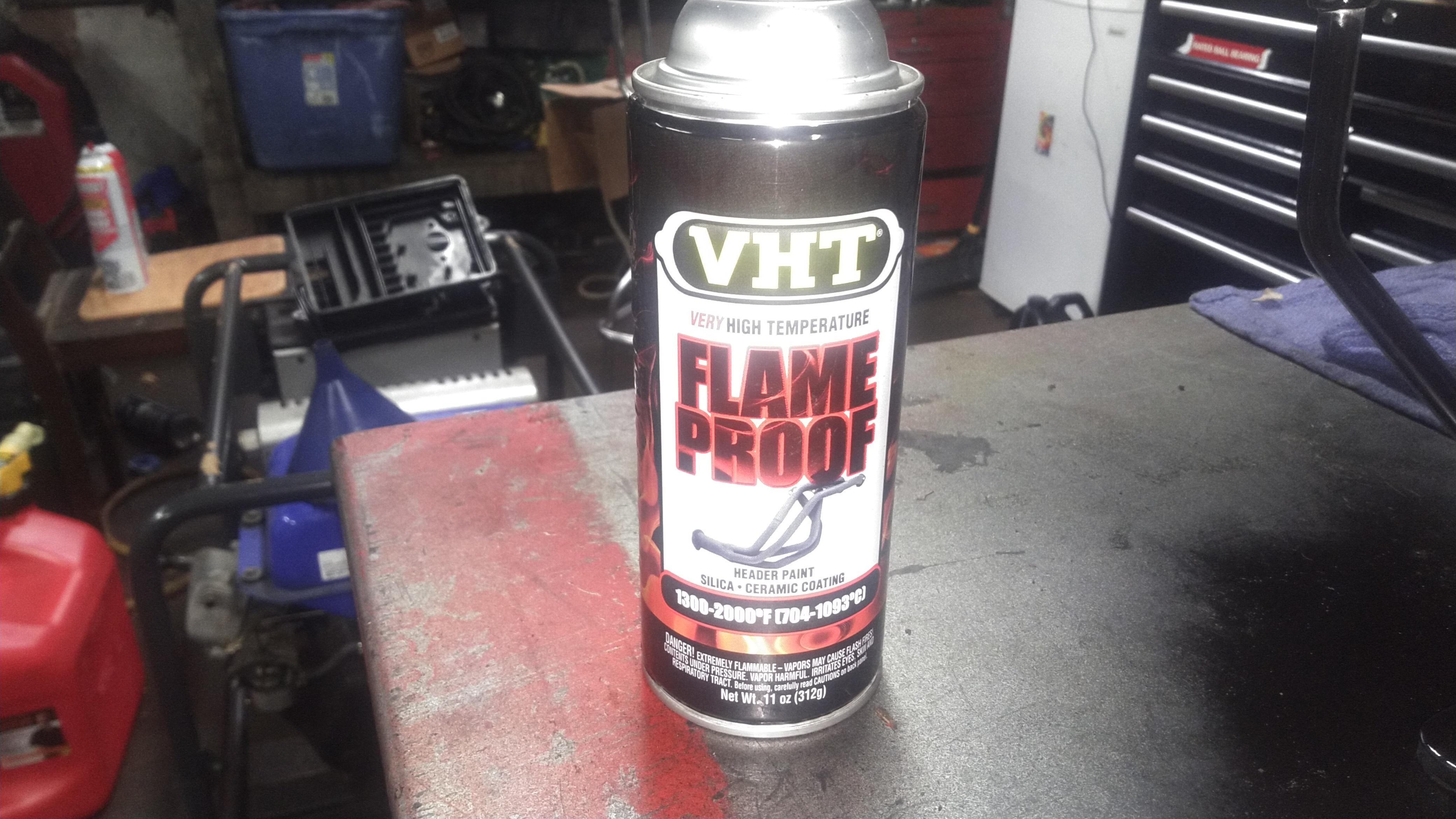

Painted the new flex pipe for the Escape which I'll install next week. A buddy of mine is letting me use his lift.

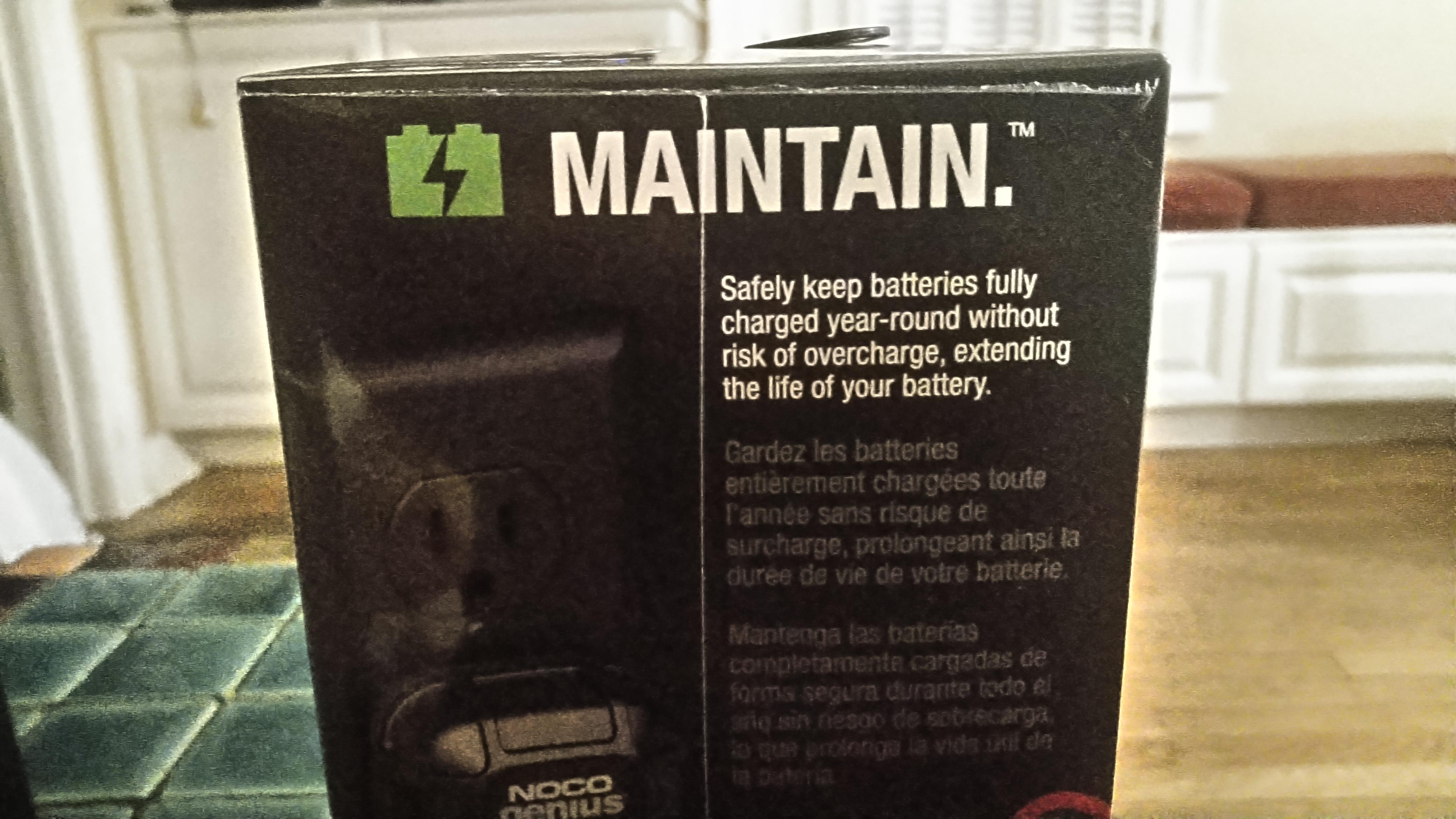

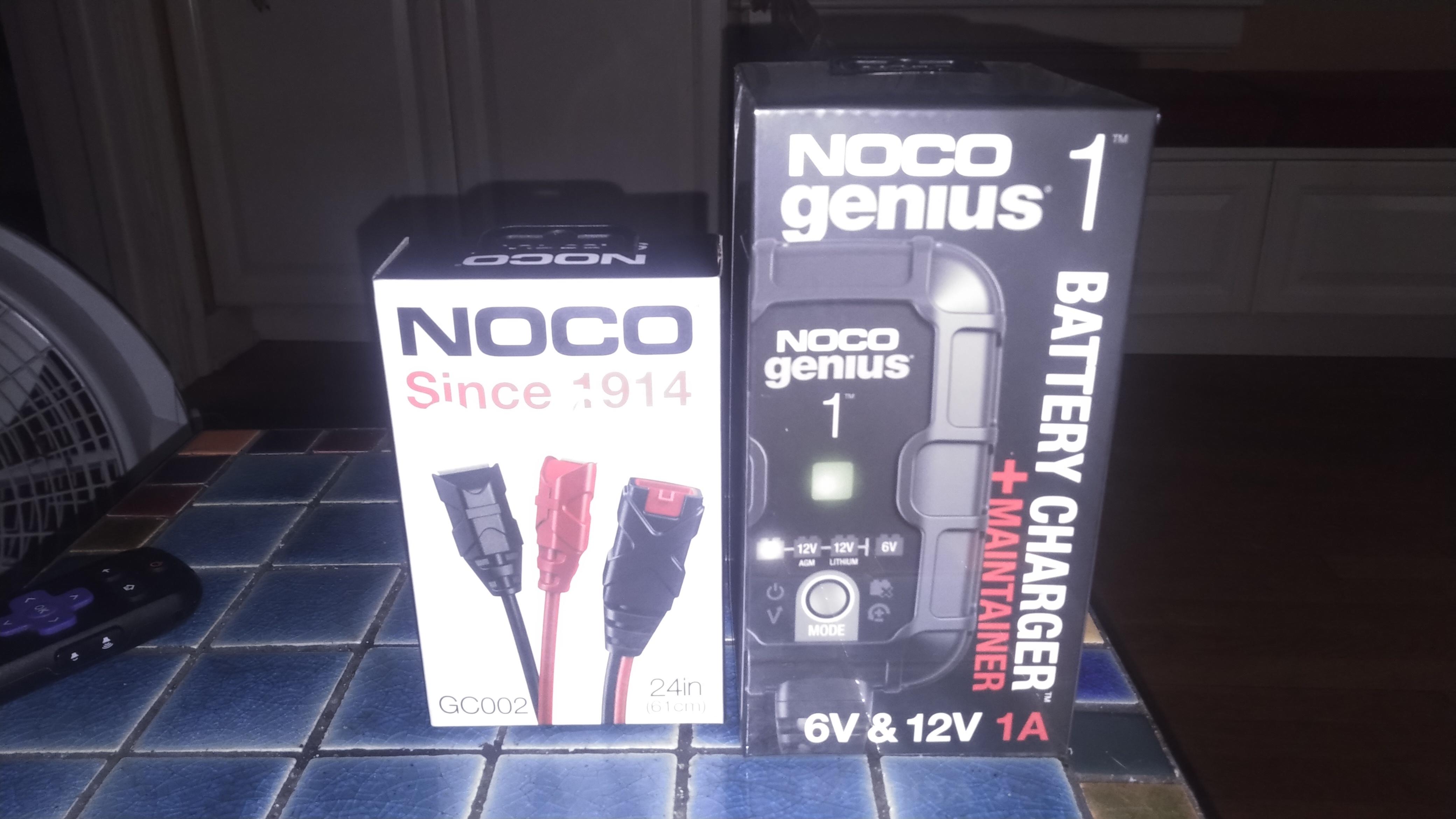

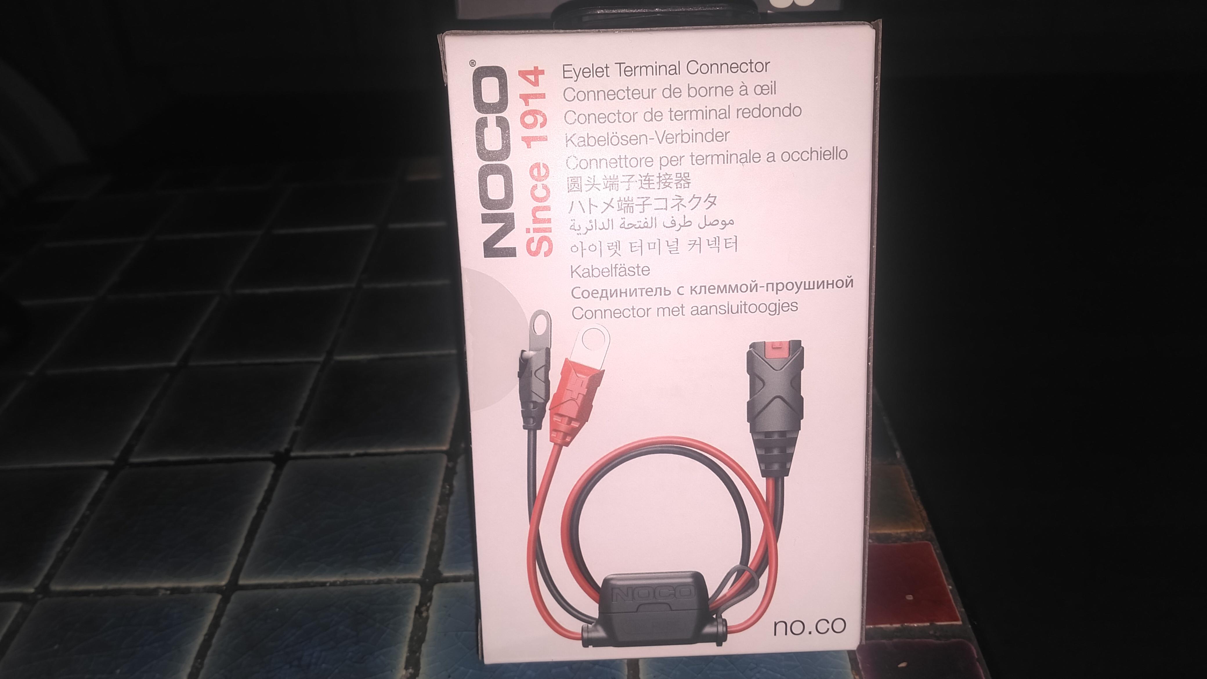

Tomorrow after work I'm installing the battery maintainer on the new mower since I probably won't run it much more till spring. Already stabilized the fuel before I chopped up leaves last weekend. Also need to prep saws for Sunday. Just need to fill them with fuel and oil, mix up another can of 40:1 and put my saw tool box together with carb screwdrivers, a scrench, PPE, and wedges.

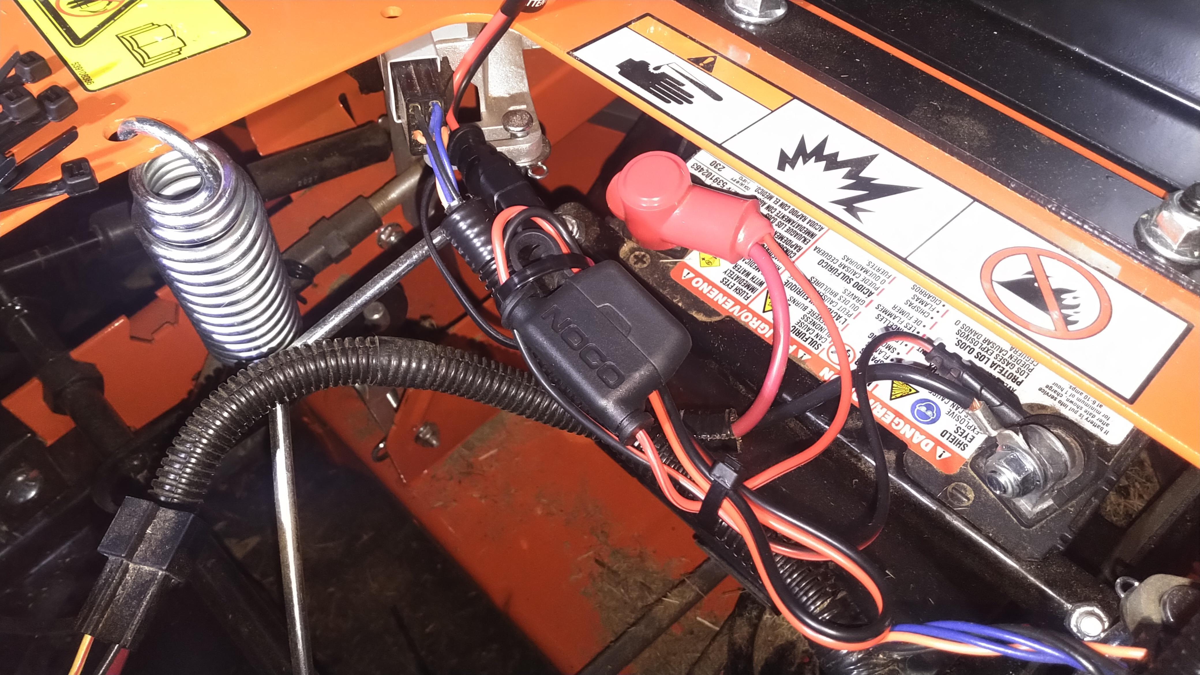

Got bored waiting for dinner to arrive so I installed the battery maintainer. Purposely made it lay on the seat so I don't drive off with it plugged in.
Lol! Great idea! U know how many times in the winter i drive off just to find my cord stretched out in the driveway when i come home? Hahaha! Damn diesels:D
