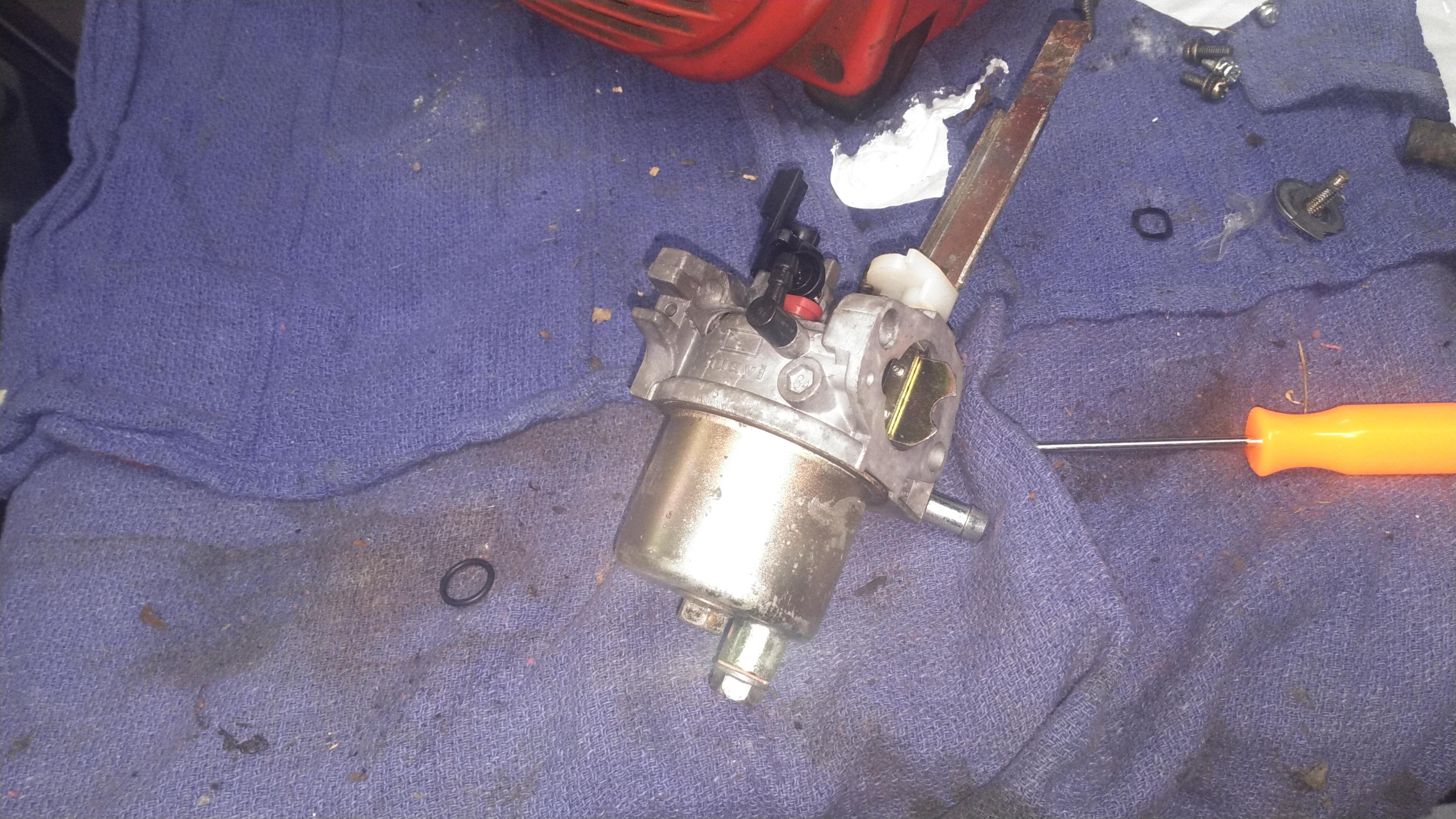

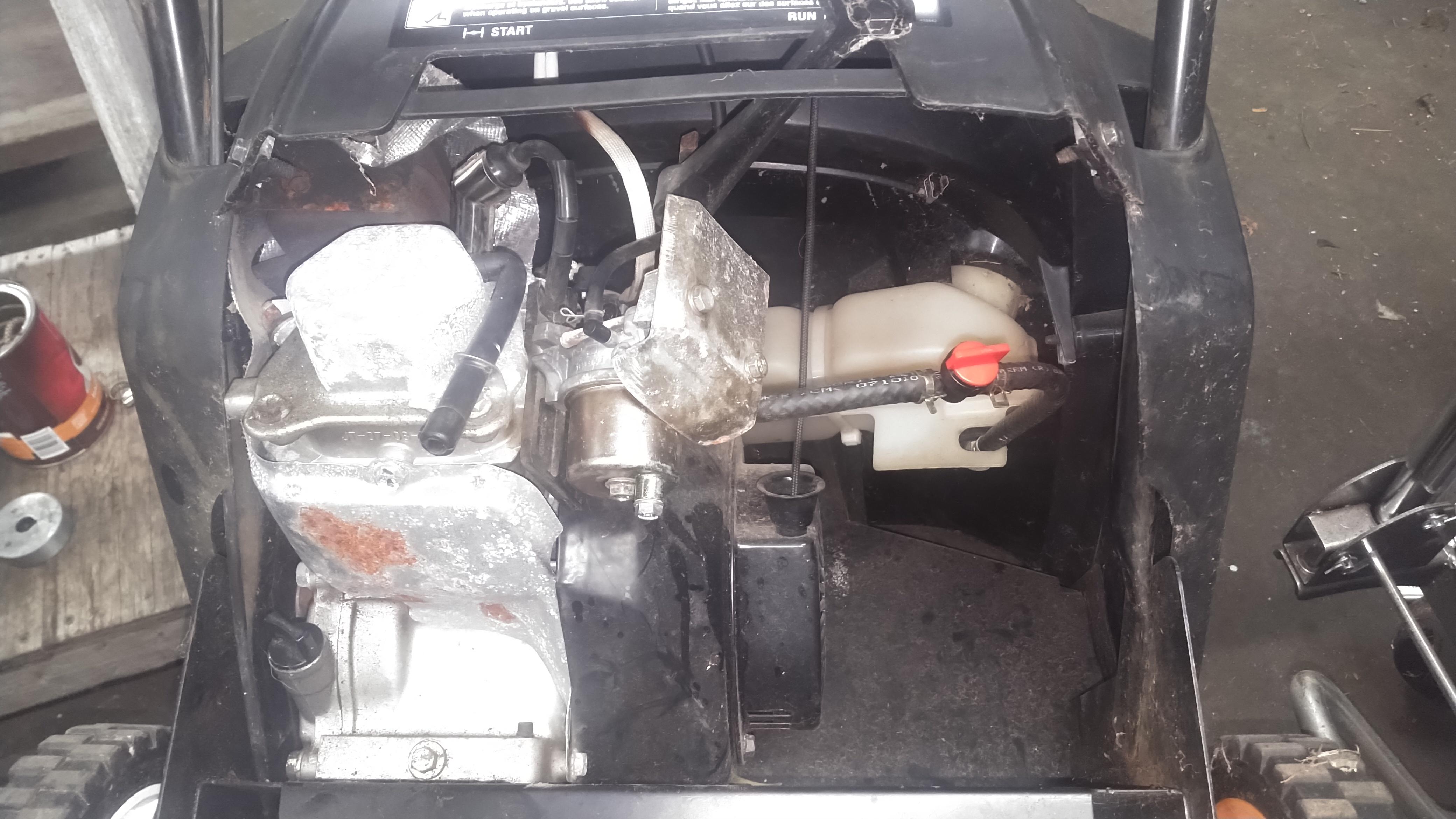

Carb reassembled and reinstalled, added a fuel shutoff so he can run it out of fuel when he's done using it. Just need to test run, change oil/spark plug and sort out some missing hardware.

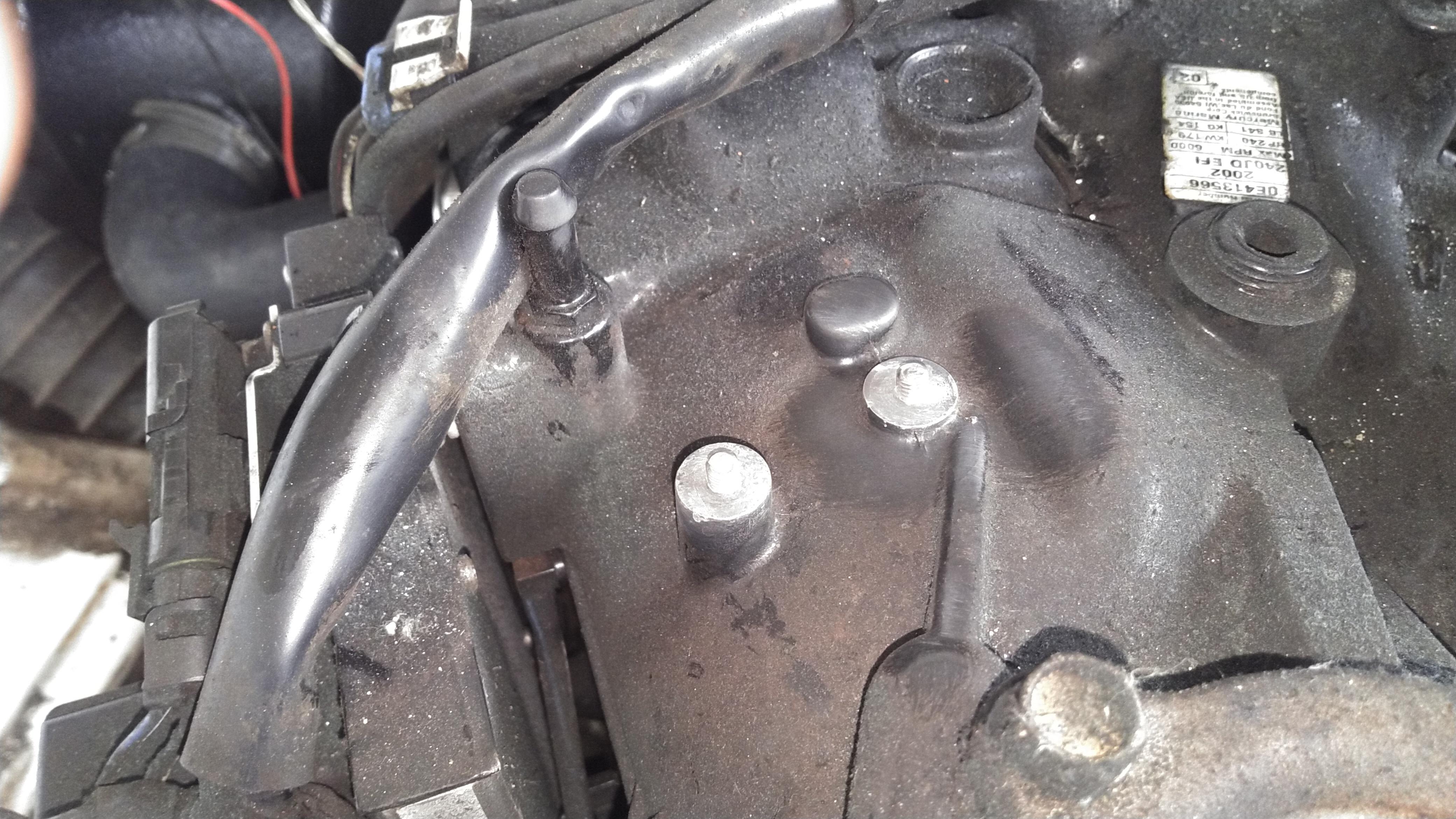

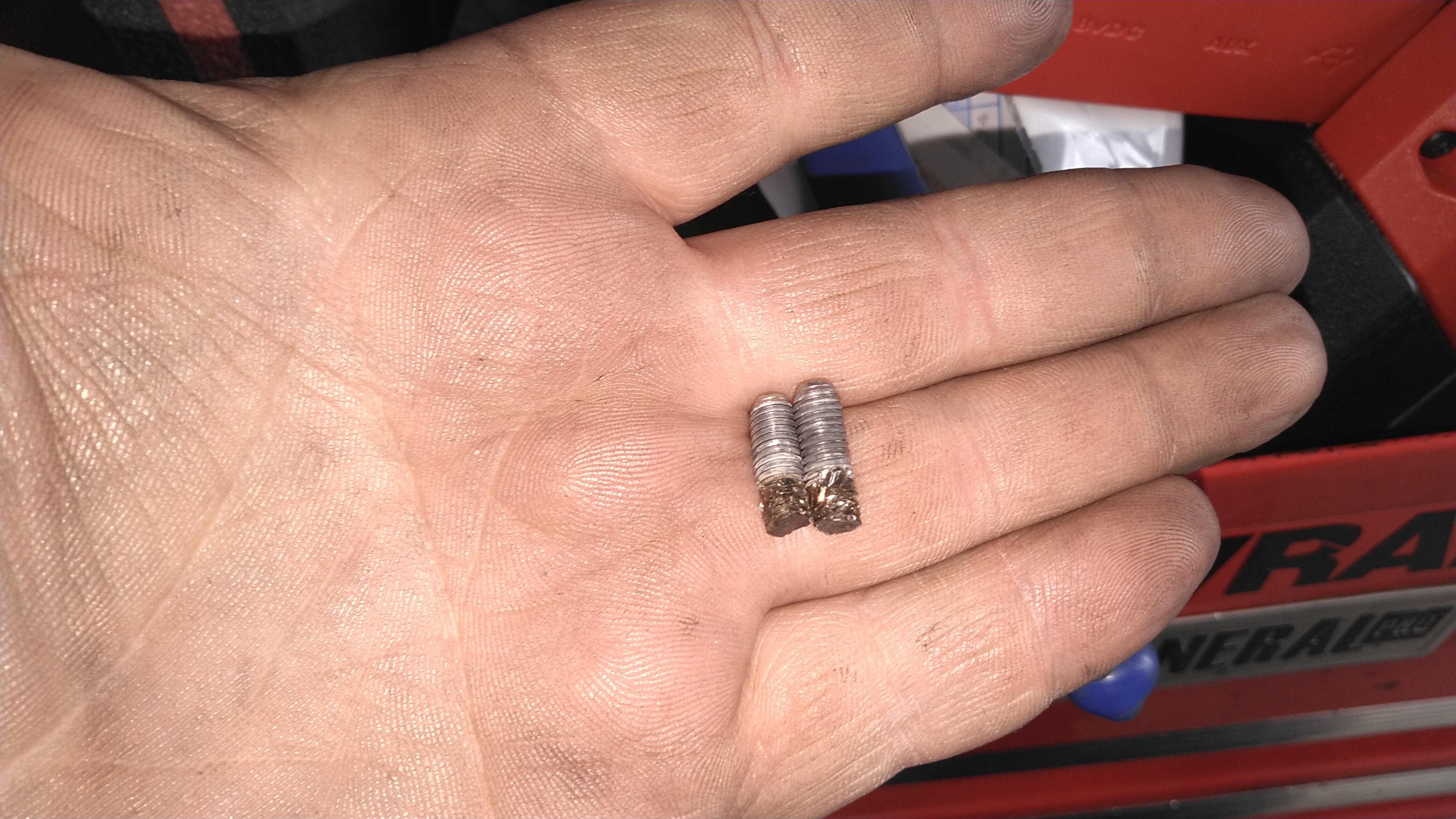

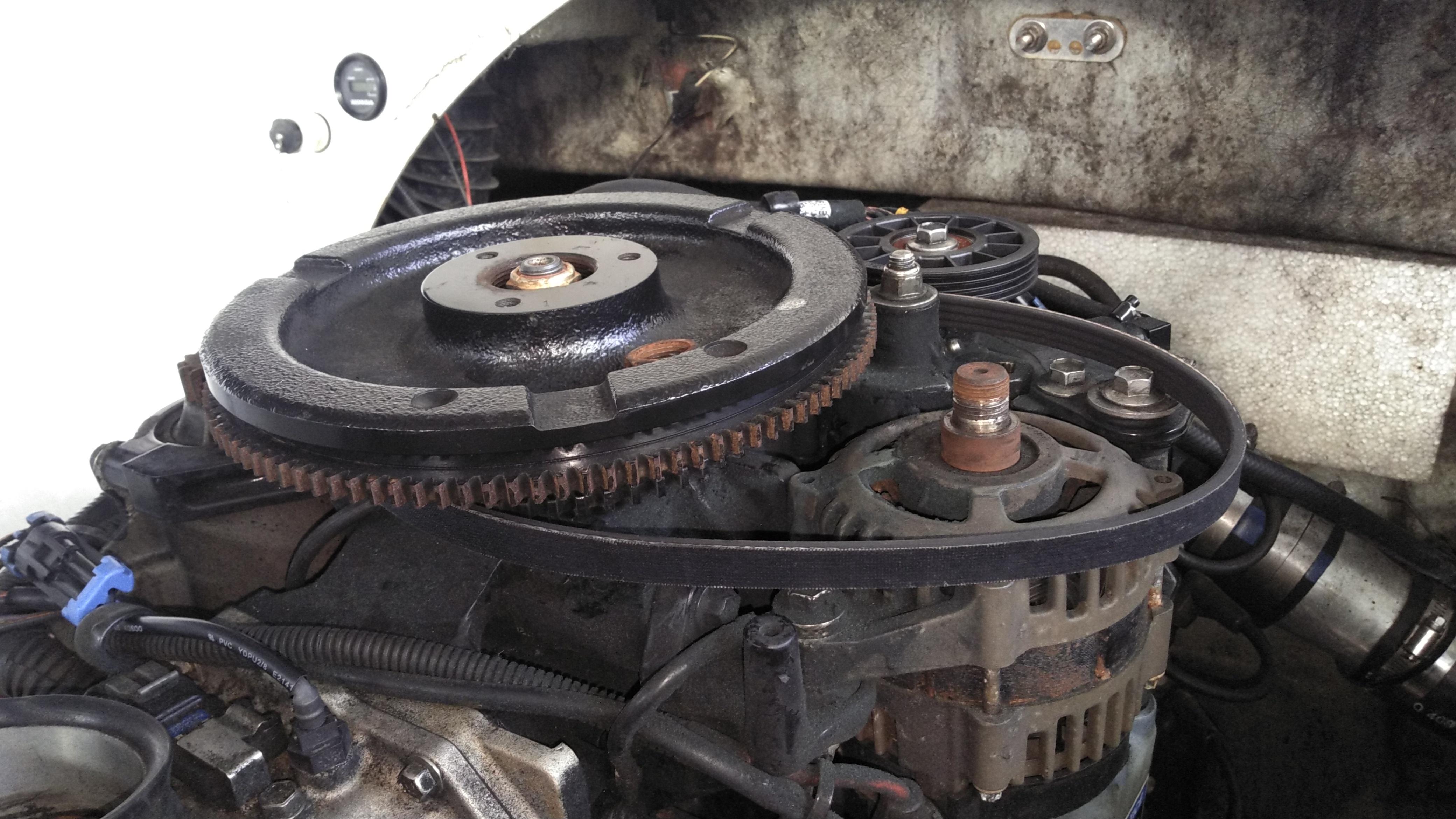

Ended up getting the broken bolts out with some heat and lube. Flywheel back on. Alternator pulley back on in the morning when the paint is dry.

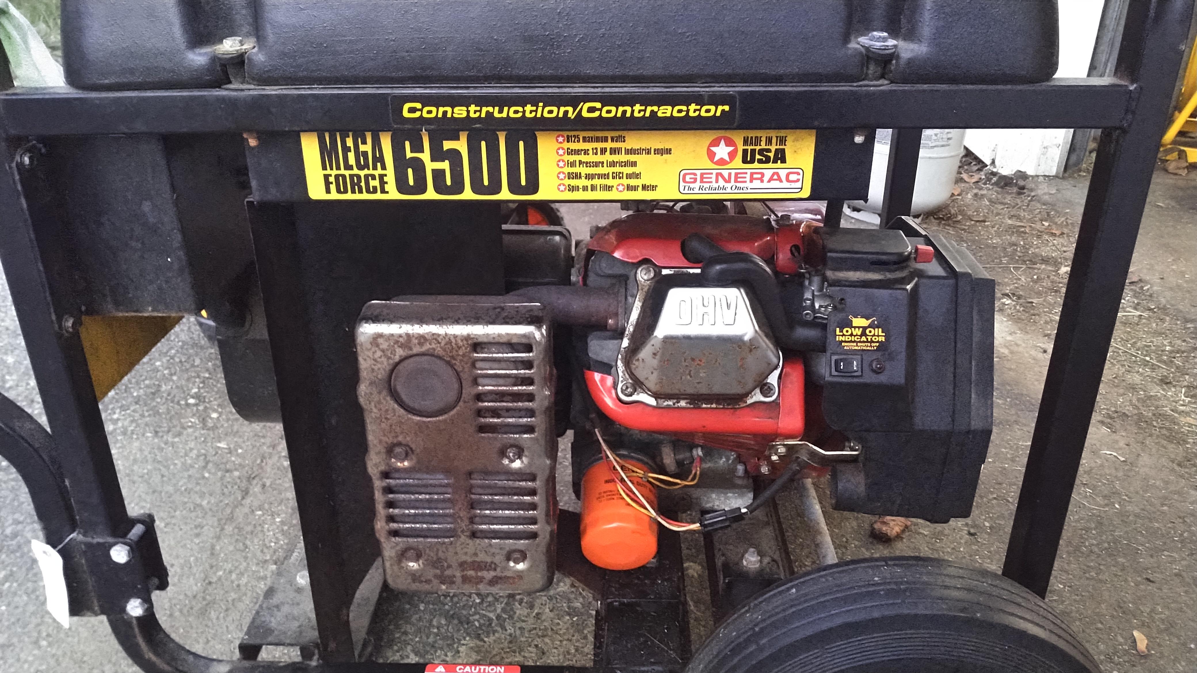

Finished the valve job on my buddy's generator and got it fired up. Extended test run tomorrow after work.

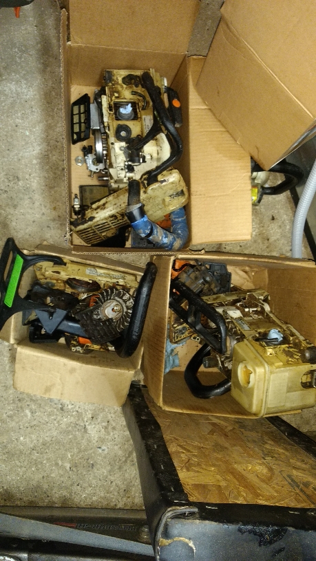

Seems to be a theme lately, 011 AVT came in two weeks ago, 011 AV came in today. The AVT dropped the reed at high RPM, will need a piston. The AV has a leaky FW side seal.
Later on a Wildthing was dropped off, fuel line, starter rope, and a repair to the chain adjuster. Folks need to realize they must line up the bar nut with the hole in the bar when they put the clutch cover back on.
