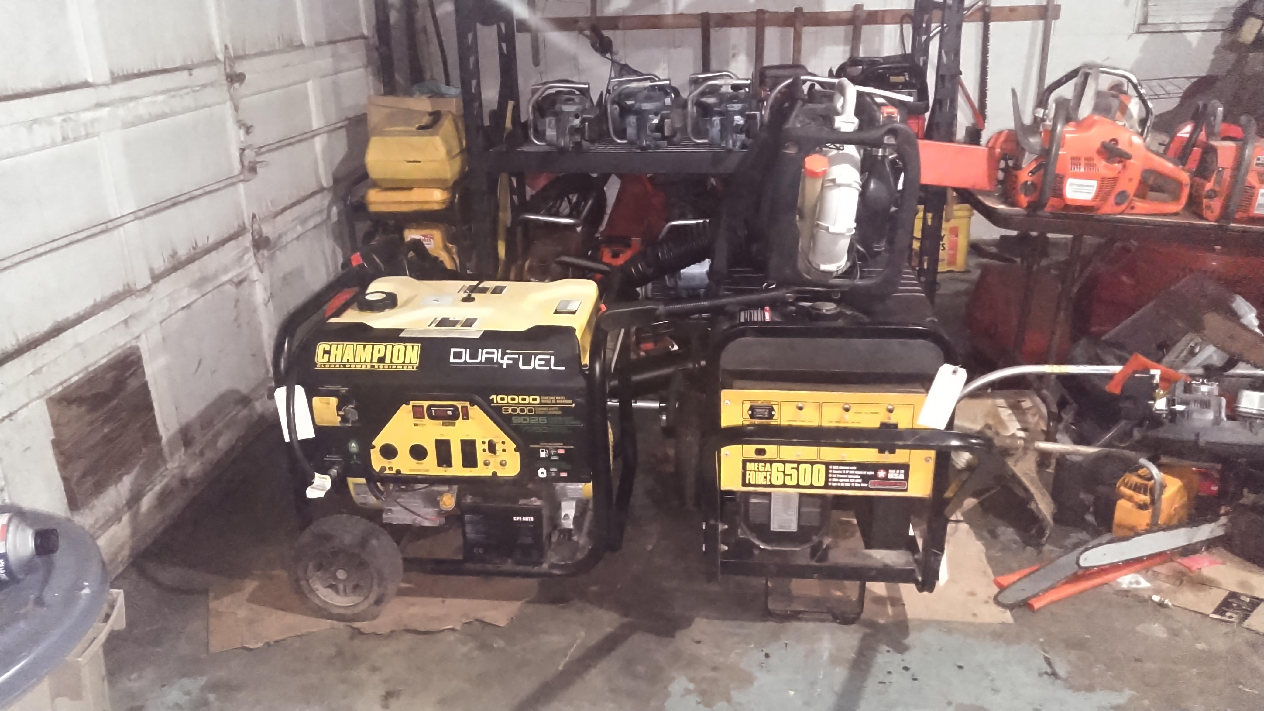

Tested my buddy's 6500 watt generator, ran the entire house for an hour no issue, before I fired it up I double checked the valve clearances and they were perfectly at .003" which is in the middle of the spec range.

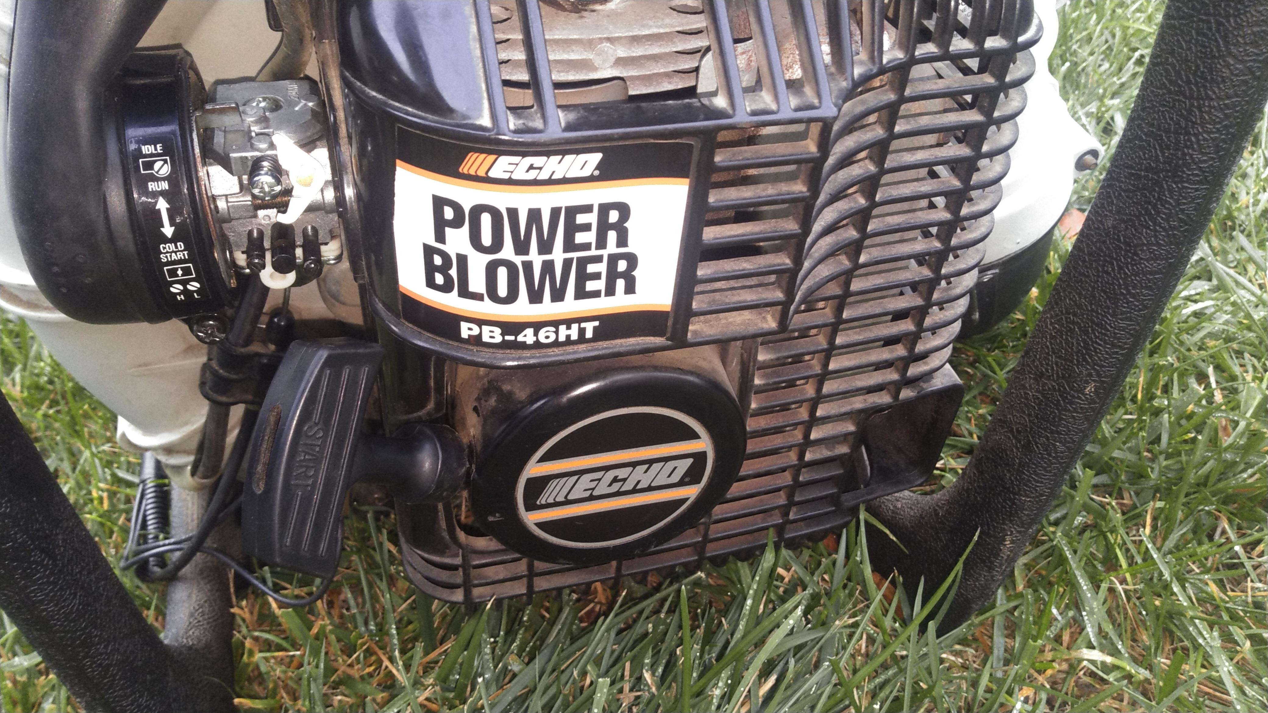

Checked out and repaired an older Echo backpack blower dropped off yesterday for a no start. It was severely flooded. Cleared the cylinder, installed a new plug (the brand new E3 plug was junk) and after a minute of pulling it started. Adjusted carb slightly to factory idle and top rpm. Ran for half an hour at full tilt no issue.

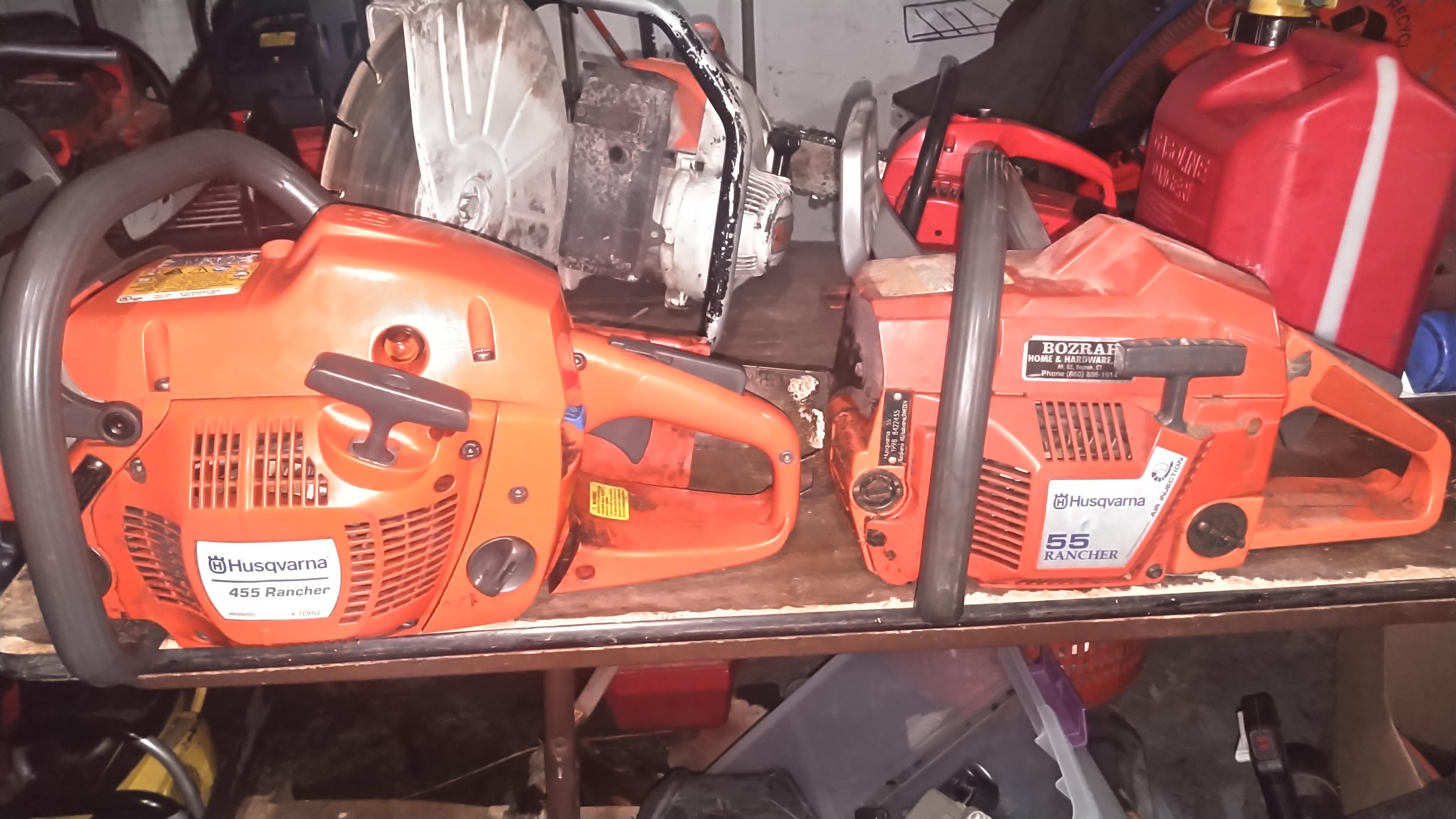

Had 2 dropped off for get running/service.

Video of the generator under load:
